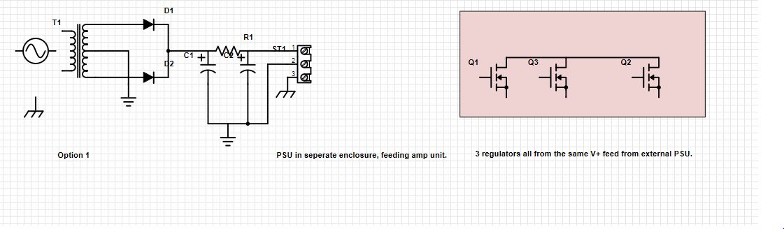

I want to build a Zen Light amp with BOZ pre-amp in one case, fed via a external PSU unit. I will build the complete PSU in one case (transformer, bridges, CRC, and the inductor/cap combo to filter the supply. I will carry the supply to the amp case via 3 prong (maybe xlr) connection with V+, Gnd, and Chassis Gnd. I will do final filtering and regulation local at the individual circuits.
Is there anything wrong with feeding all three circuits from 1 V+ using the ZEN V3 regulator to filter the individual circuits?
I guess this picture is my best doodle of what I am trying to show:

Im getting a feeling that maybe it is as simple as I think it is.
Just wanted to ask before I p2p a bunch of stuff and then see a bunch of magic smoke when I power it all up.

I think you're adding a lot of complexity by trying to build everything in one case.
Is there a reason for needing it all in one box?

I know how far I can go with this build. It seemed all in one "integrated" would be the best way to go.

...you do realize this will be a large amp with 4 large light bulbs sticking out the top, right! 🙂
-and heatsinks that will run very hot to the touch...
I don't think there are many times ZEN and WAF will be found in the same room holding hands! 🙂 🙂
I am being a big downer to your build aspirations - sorry. If it were me, i'd build the Balanced Zen Light
and pair it with the Balanced Zen Line Stage (BZLS) ((much better than the BOZ))
it's a match made in ZEN / WAF Heaven! They'll make beautiful music together 🙂 🙂 🙂 Good Luck!
