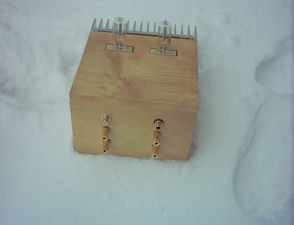

http://www.passdiy.com/images/projects/z1-fig22.gif
It needs to be between ca. 30 and 60 Volts and a lot of current. 4 or more A / channel at least. So you need a transformer 500-1000W, some Diodes or recifiers, small parts, and one or two big capacitor more. The figure 22 shows one channel on each winding. You could also build with only one winding for both channels in case your transformer has only one secondary winding.
