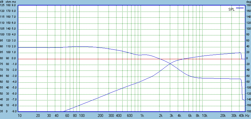

Has anyone "successfully" implemented a crossover for the ZD5 using a Minidsp?
If so, would you care to share settings?
I picked up one SS 15W cheaply, and since I already have pair of XT25s and a 2x4 minidsp, I thought I would play around with this design. Already built one sealed enclosure for test purposes.

Zaph conveniently provides the transfer function to dial into the miniDSP, shouldn't be too hard.
Finally built a pair of 0.5cu ft sealed ZD5 cabinets.
Connected my two stereo Symasym amps via minidsp.
Inputs to the minidsp are LF 1st order BW @ 560hz, HF 2nd order BW @4200hz, Inverted polarity and 0.4us delay, tweeter level reduced by 7db (still evaluating ). 2db cut at 950hz.

Note that the ZD5 design also includes an all-pass filter which would need to be replicated on the MiniDSP to faithfully reproduce the passive crossover, otherwise the woofer and tweeter won't be time aligned.Zaph conveniently provides the transfer function to dial into the miniDSP, shouldn't be too hard.
Not sure if they have added all-pass filters to the current software, although on older versions you could make an all-pass filter by entering the appropriate biquad coefficients into the parametric EQ.
Another method would be to just add a delay to the tweeter instead of the all-pass, although that would be modifying the design.

Thanks so much really sound great, I tried so many time to get the ZD5 to sound right and I was never successful till I tried those settings. the only thing I do differently is I don't Inverted polarity, why do you do that ? doesn't sound right when I try it. anyways Thanks again ,, David
