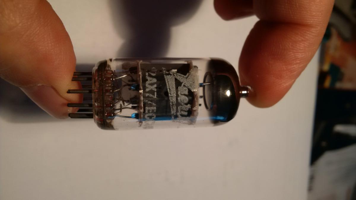

I have a pair of Zaerix ECC83/12AX7. They have the following codes:
69
E49
Can anyone identify them?
What is the meaning of those codes?

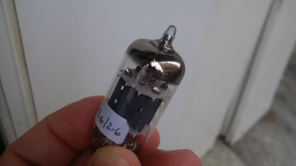

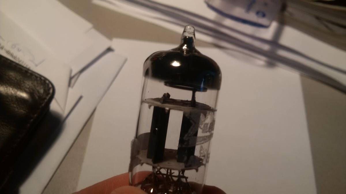

Check the factory code against the Philips database, Looks like Philips to me. Possibly non European manufacture (South America or BEL India), the absence of copper plated lead through wires kind of rules out Tungsgram as a manufacturer.
They're not Philips codes. The only 69 in that list is an E91AA. Zaerix rebadged valves from all over the place. A lot of their ECC83s came from the former East Germany, but they tend to have "Made in the GDR" stamped on them.
RFT used mostly copper plated lead through wires. Plus they never used the Philips plate shape
My guess is tungsgram

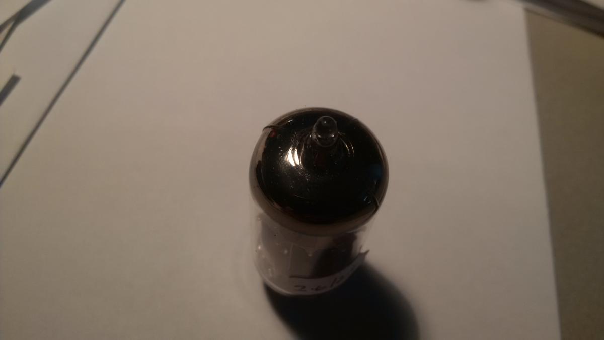

What does the top of the glass look like?
The glass was definitely made using Philips tooling, but not necessarily in a Philips group factory. The seams are the giveaway.
In the latter years of the valve era many Philips valves were made elsewhere, and some of these overseas factories were rather careless in how they applied the factory code.
Z&I Aero Services were a British rebrander. Most of their valves came from Russia or Eastern Europe, but they would buy what they could.

The glass was definitely made using Philips tooling, but not necessarily in a Philips group factory. Bharat Electronics (B.E.L), India, is the most probable manufacturer of this valve (?). Statistically (but not necessarily) it is likely to be less reliable than a true Philips.
Check for either "I61" or "I63" on the lower side of the glass.
How many seams are on top of the glass, 2 or 4? I can't see clearly in the pictures.
If it has 2 seams and either I61 or I63 on the glass they are Mullards UK.

Ι61 & 163 were also used by Philips and Siemens,BUT not with 2 top seams (they had 4) and with a different date code.the I61 and I63 versions were also made at Heerlen in the Netherlands.
So, as I said before, 2 seams+ I61/I63 and date codes begining with B were made by Mullard in Blackburn/UK.CV4004/M8137 with date codes begining with R were made in Mitcham/UK.They also had only 2 top seams and of course box plates.
If I remember well, the UK 161 had copper posts but not those made by Philips or Siemens etc...
