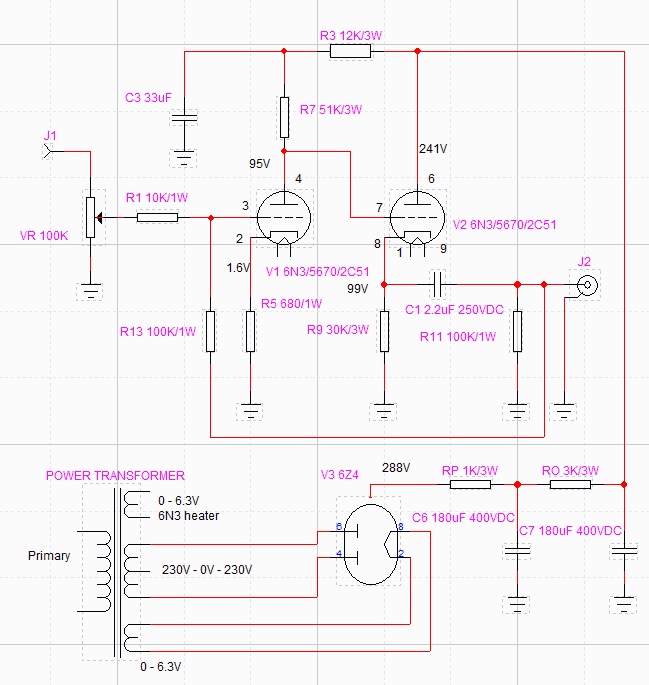

I am located in Australia and would like to buy a transformer locally. Has anyone modified or improved this circuit, or able to confirm the following power requirements:
High Voltage: AC150V-0-AC150V (current 10MA)
filament voltage: AC6.3V (4A above)

I have been looking for a local transformers rated 230/240, thus querying the power requirements of this circuit.
The YJ 3 tube requires 6.3v for the heaters, however I have seen similar circuits running from 50v-230v, where's this one requires 150v. Do these tubes operate under a large range of voltages?
I have attached a circuit below if a 'similar' design with 2x 6n3 and 6z4. I would prefer to purchased a local transformer but can't find many with 150-0-150 secondary.
