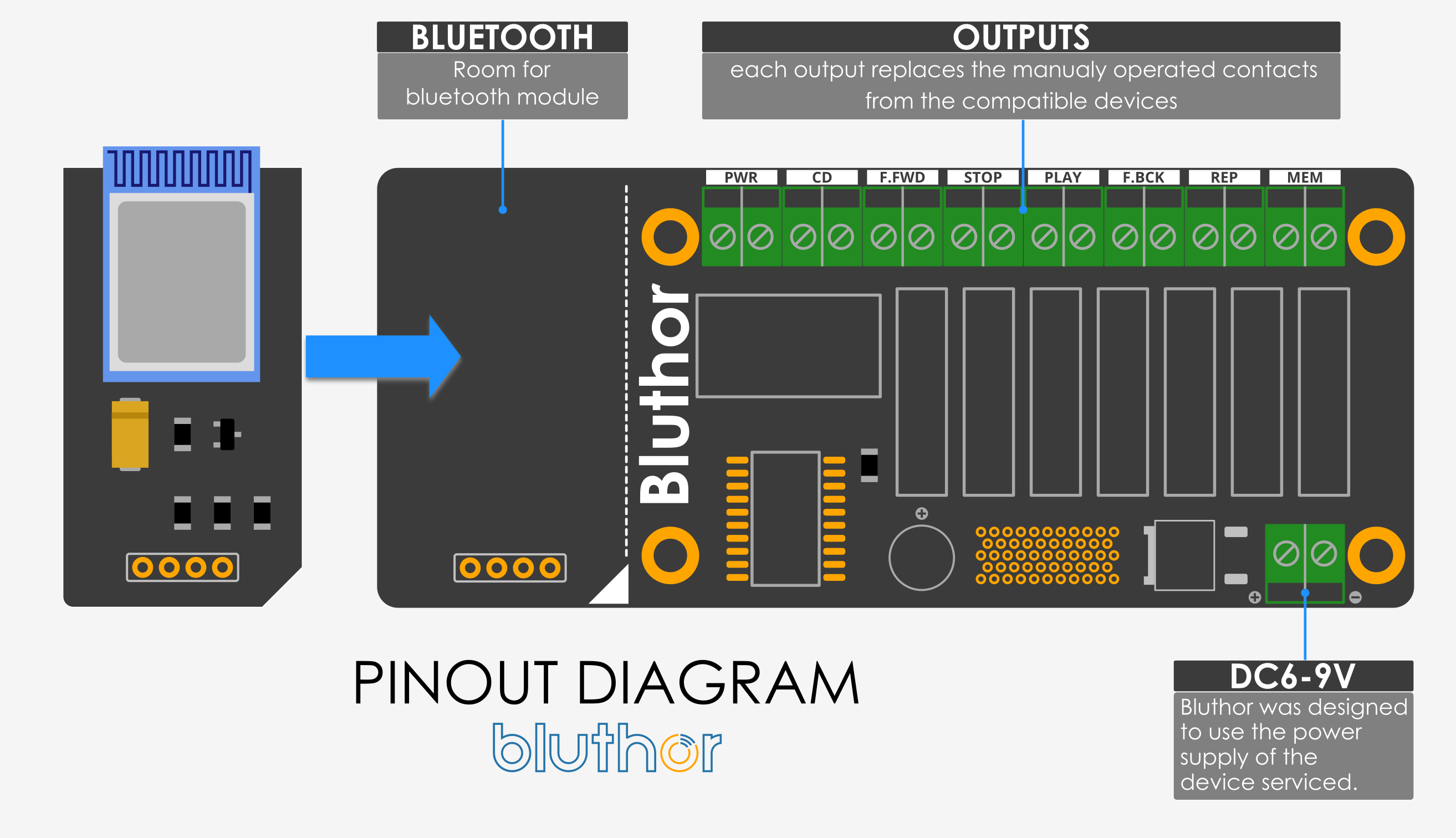

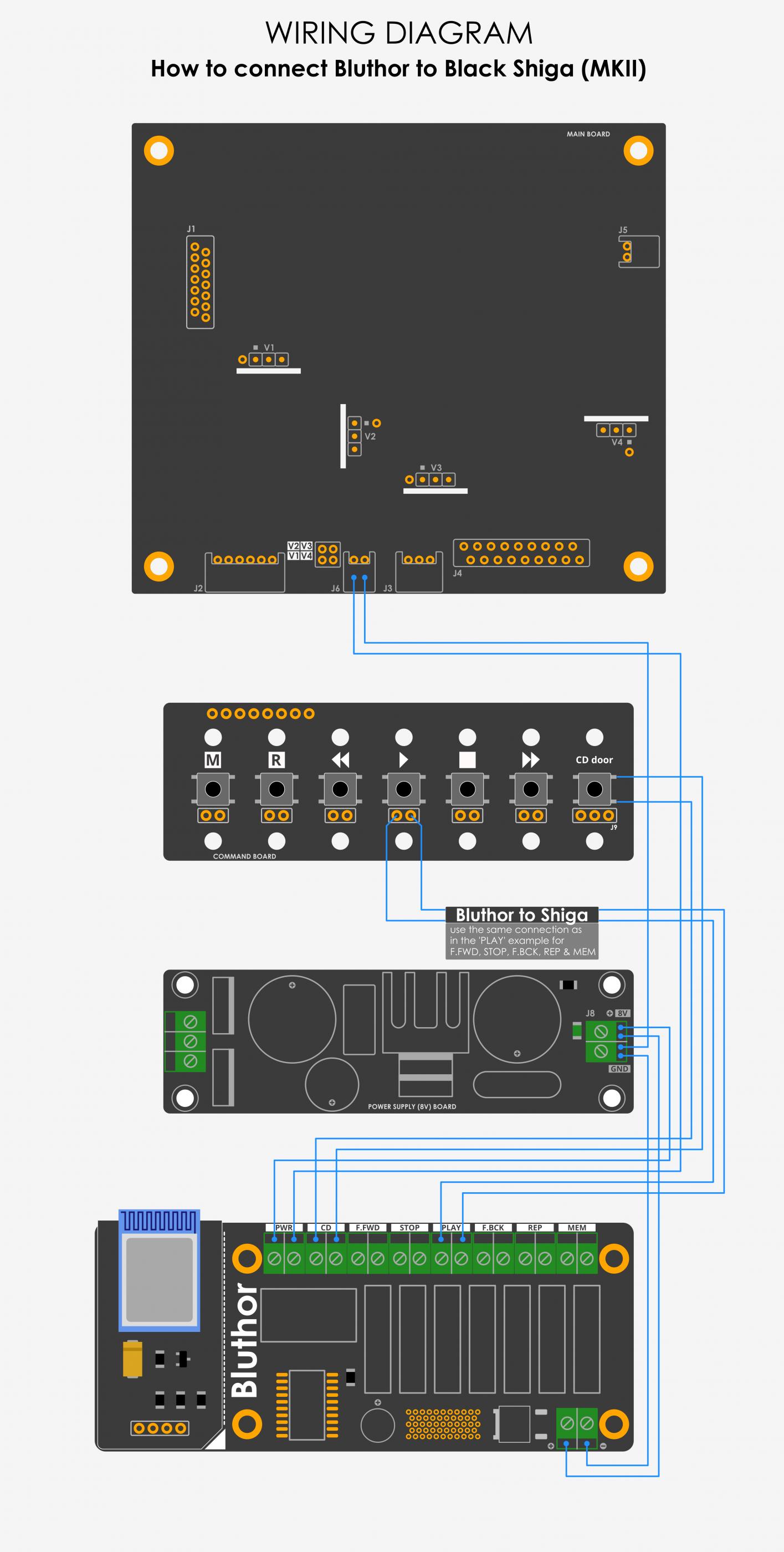

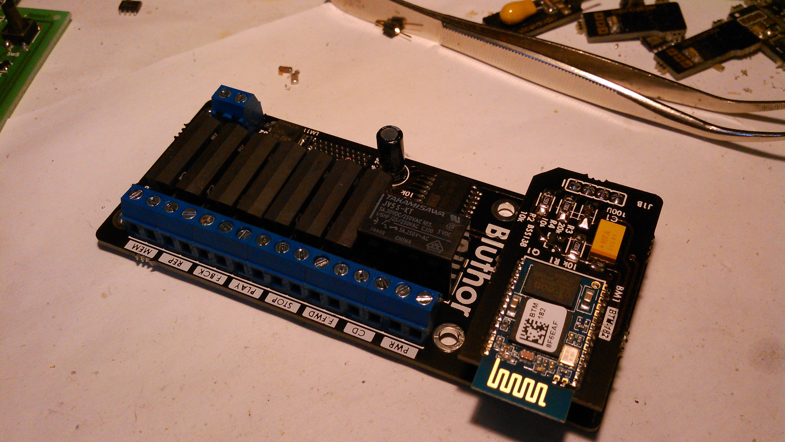

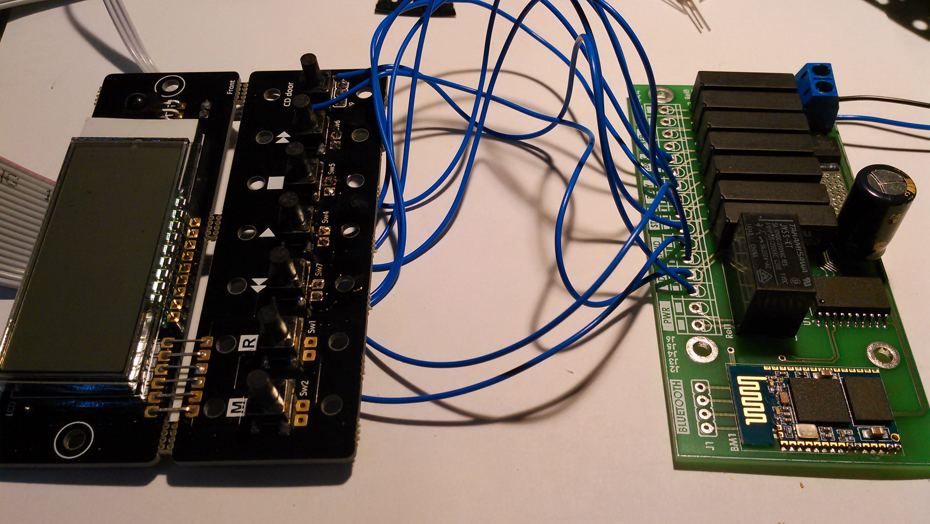

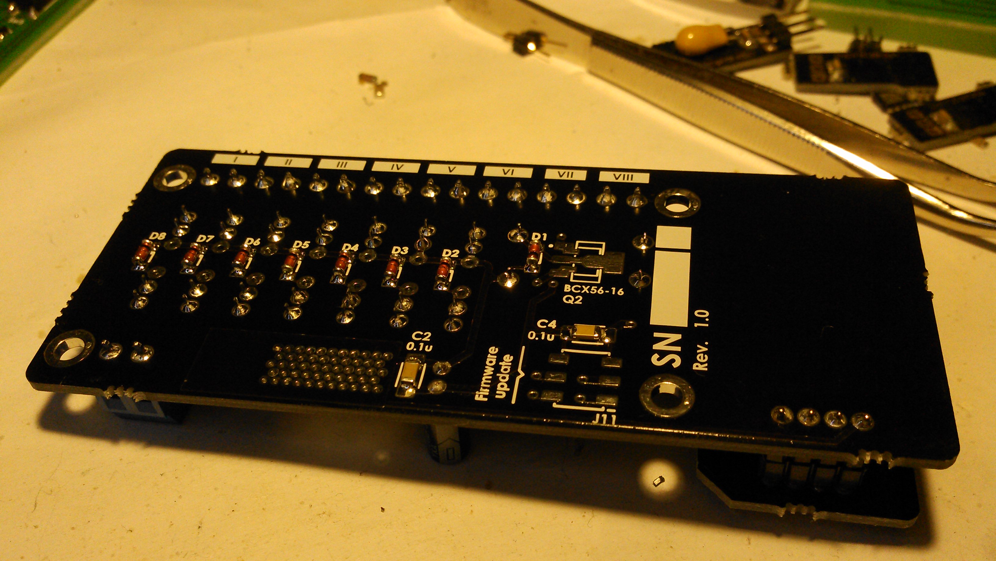

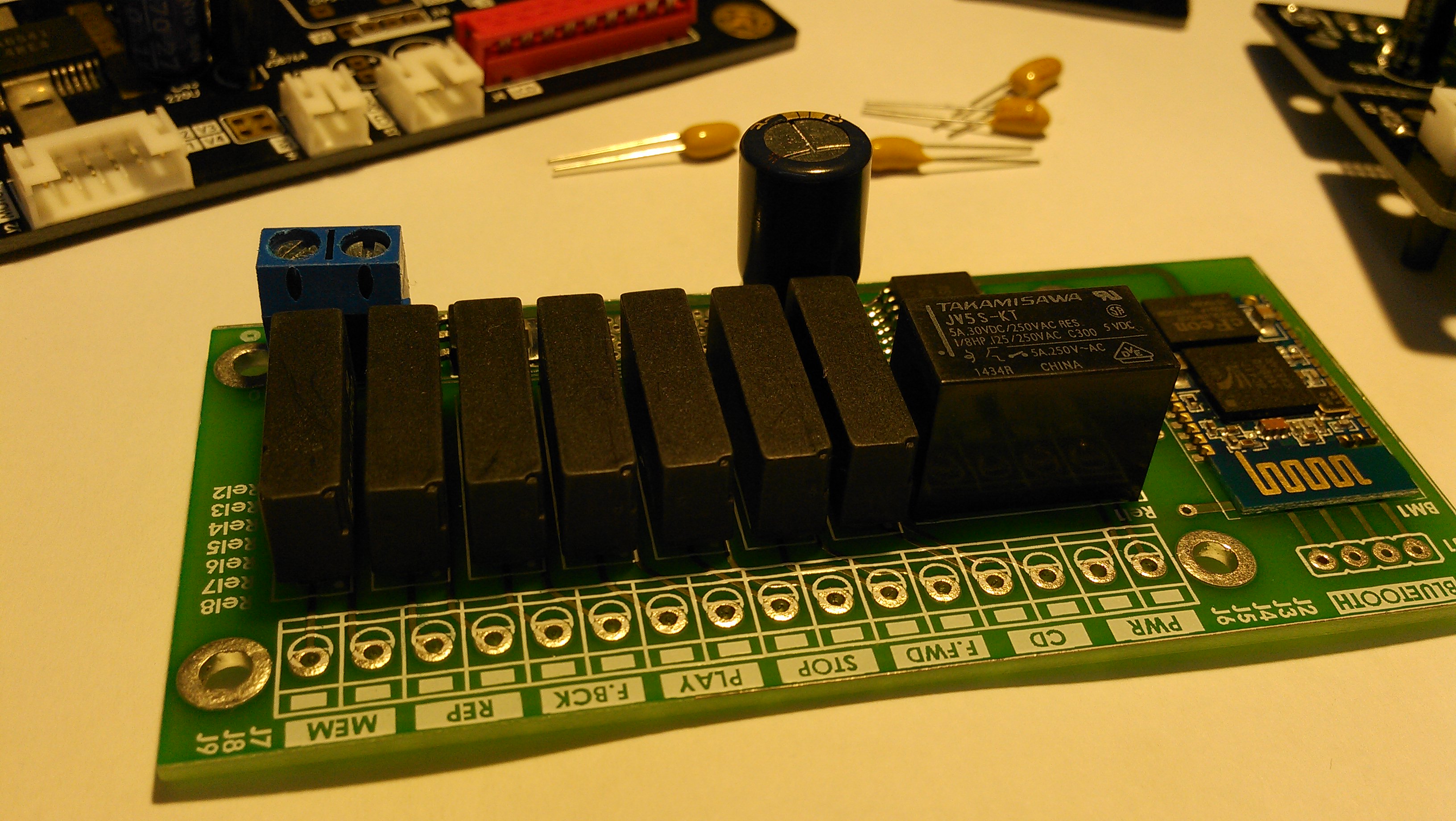

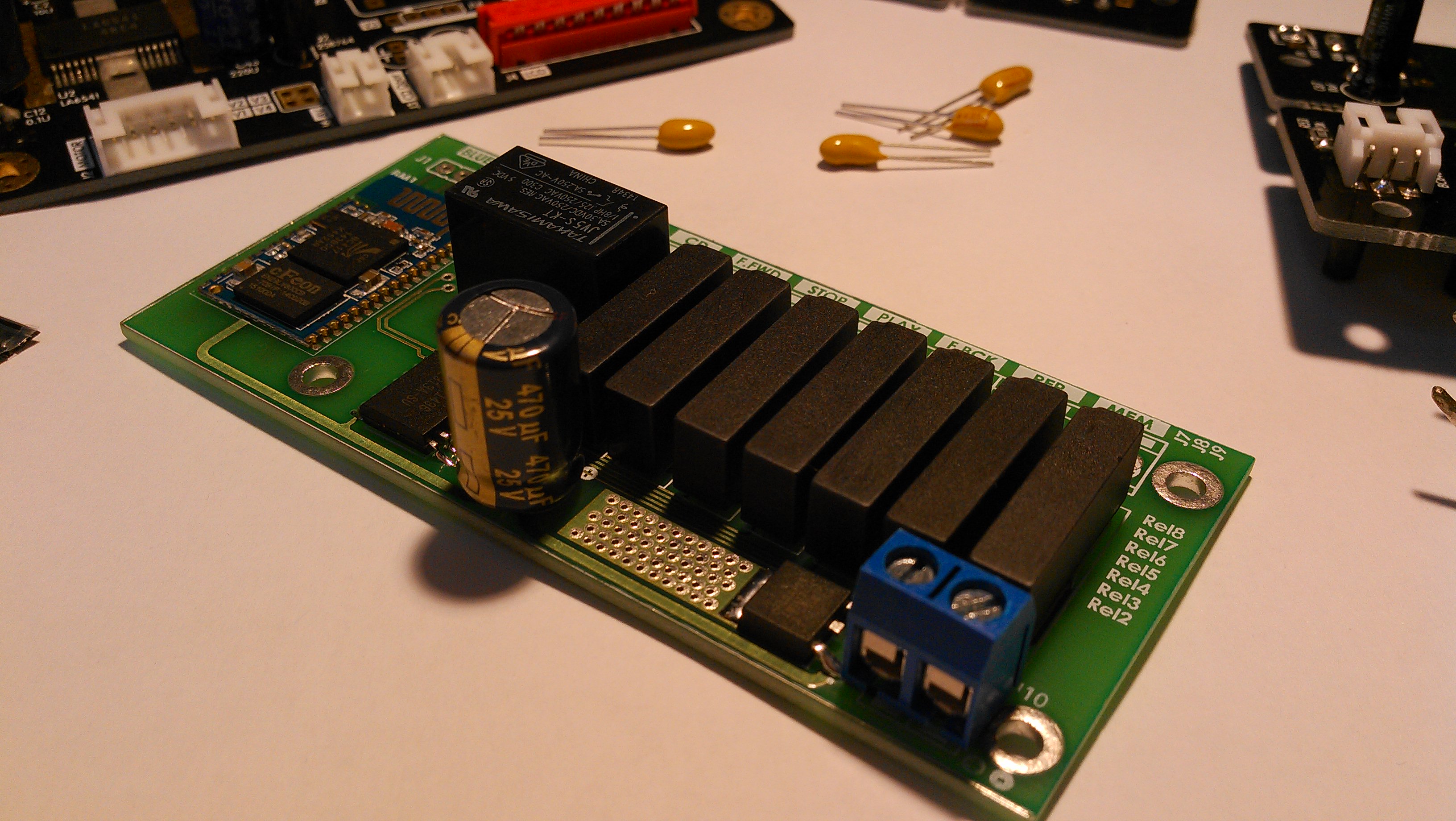

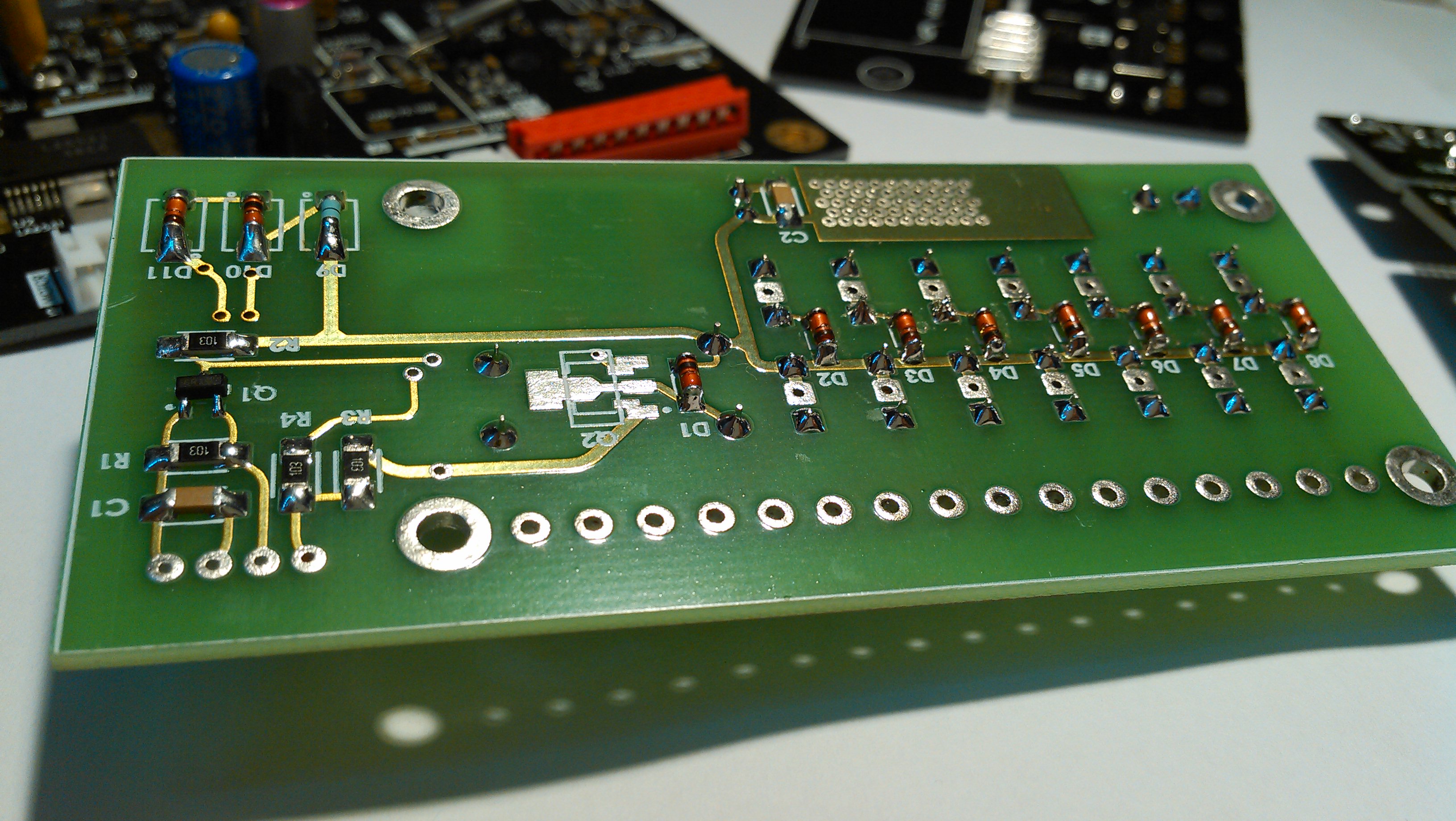

When we started Shigaclone project one of the challenges was to get a compatible remote control.
Finally managed to get original chip for infrared remote, but in the same we started to think on a modern alternative solution using a mobile phone over bluetooth.
Mobile phones are more and more part of our life and it make perfect sense to implement such function in a modern audio equipment.
Our goal was to make a remote that is flexible and easy to implement on any audio device which use push buttons.
The operation of BluThor is very simple. A set of reed relays are connected over each push-button you want to control. Commands sent via bluetooth are activating these relays for 200ms. Reed relays are fast, quiet, operate at very low current and offer required galvanic isolation.
With BluThor you can control any CD player who use push buttons on front panel.
No matter is an old or new CD player, BluThor will make your CD player remote controllable over bluetooth.
You may also use bluthor on your amplifier, dac or any other audio device who use push buttons.
A short video illustrating the way this operate.
https://www.facebook.com/VicolAudio/videos/vb.249865451745549/950563905009030/?type=2&theater

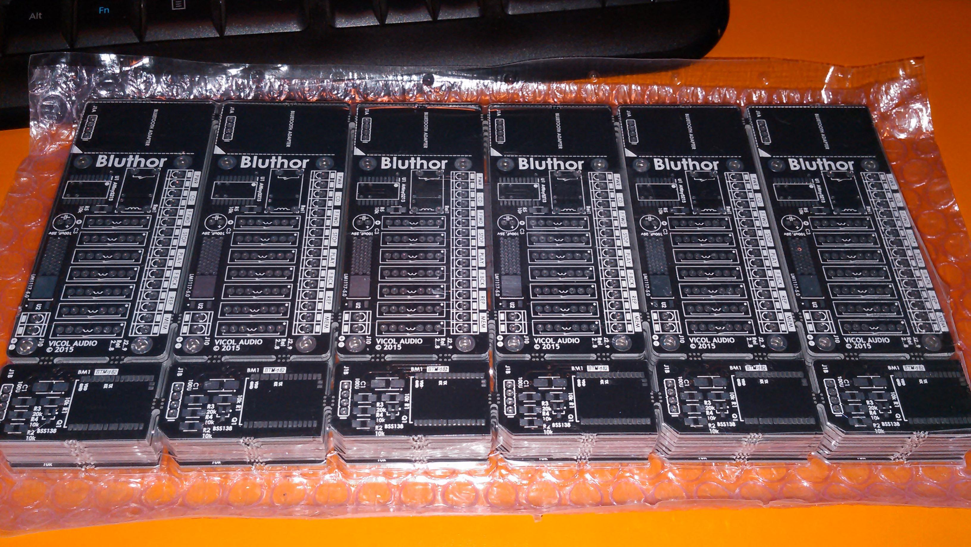

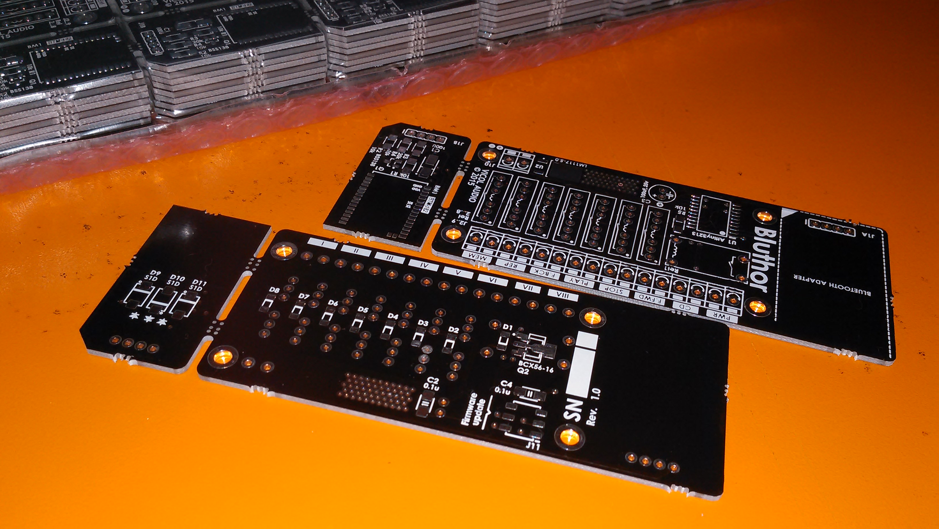

I intend to open a group buy and offer BluThor ready mounted and tested at 75 euro.
Shipping is 8 euro worldwide and paypal fee 4%.
A batch of 50 units is in production.
Android application can be already downloaded from our webpage vicol audio : MAYA - your ultimate volume-controller
A port to IOS is under work and if there will be interest we may port to other operating systems as well.
Please leave you name here https://docs.google.com/spreadsheets/d/1akdw7voB00Mjip6xOOEdnGupMPCSkzSy9rN6sdw0Lg4/edit?usp=sharing
