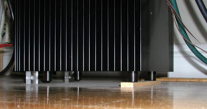

I know that some may not take it seriously, but this is my latest improvement to Aleph X. I was using some hard plastic feet and I started experimenting with different materials. It appears that the best sound is achieved when under 2 front feet I placed a strip (3/8" thick) of cedar wood and in the back, acrylic blocks directly between chassiss and solid oak floor. With that setup, I have the most pleasing vocals, with natural ambience and 3-dimentionality.
My other improvements in Aleph consist of Jensen copper foil coupling caps, paralleled with silver foil caps (big improvement comparing to other caps), removing 10p feedback cap (I think I heard improvement😉), removing active curent gain (again, improvement, but not as big as I expected), placing Vishay S102 resistors in feedback loop (some claim that Vishays are the best around, but eventually I replaced them with Rikens, as they add more life to music; this again is important area to experiment and differences can be big).

I wasn't really that much impressed with Jensens, but they were better in this application than MIT RTX and Hovlands, and I had all those caps at my disposal. The silver ones are 0.022 and I bought them from Partsconnexion at$16 ea. They not always improve things and in some speaker's crossovers I actually didn't like them and prefered Hovlands as bypass in the same value. But without them Jensens wouldn't be good😉
