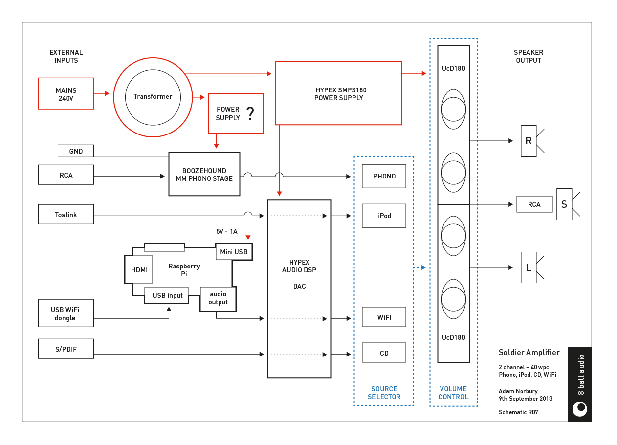

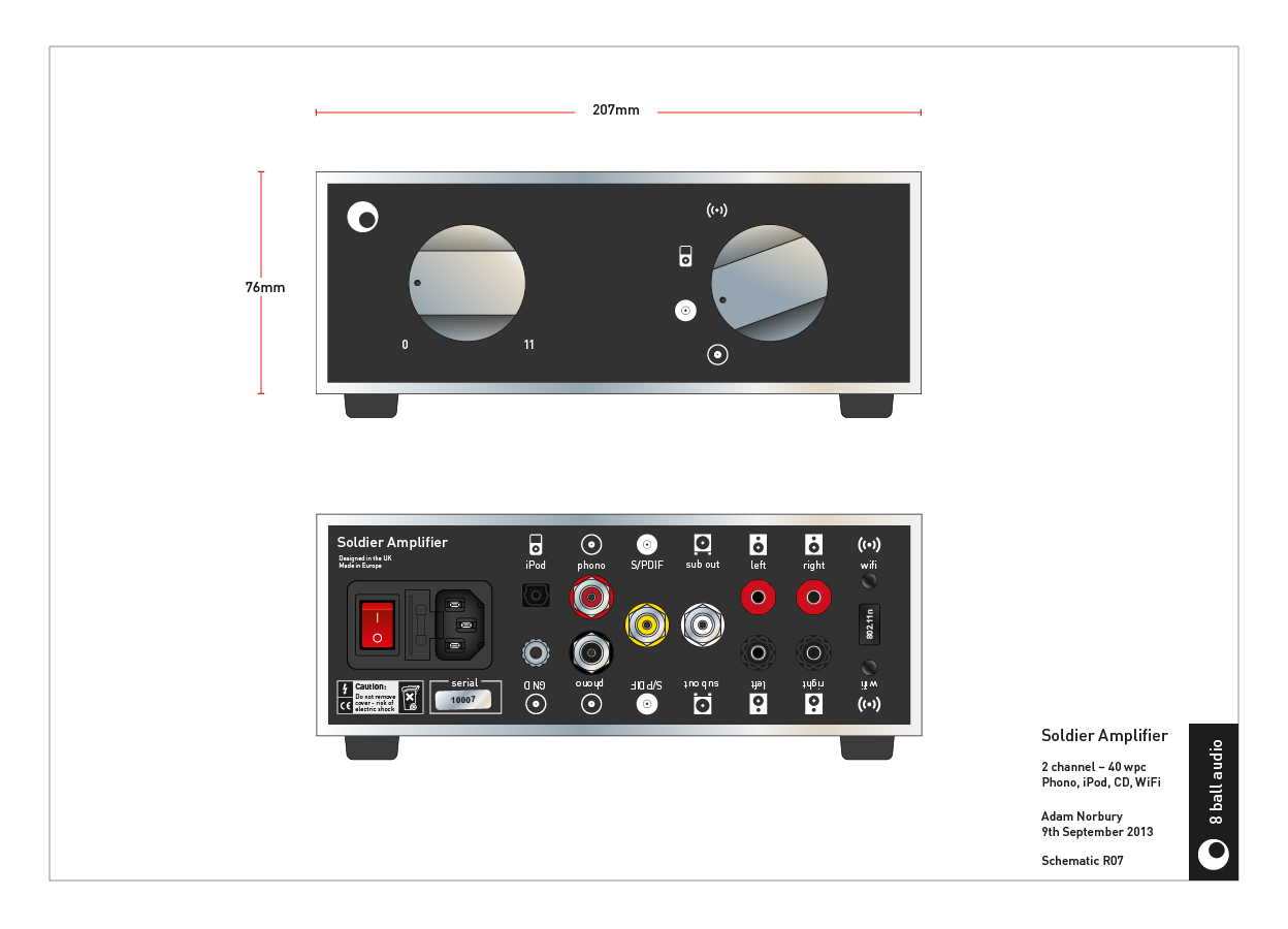

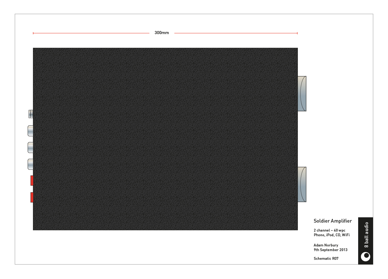

These are my thoughts so far [attached as a PDF] though if some of what I want can't be achieved via the AS2.100 then I'm going to have to look at individual components such as the DAC and amp modules. I'd like to keep the latter Hypex however.

To recap my goals:
At least match my current Naim 42.5/110 for amplification [40wpc]
Match my current amp with it's performance of the built in phono stage
Exceed the performance of my current iPad/iPod DAC as I'm feeding this directly to the amp
Utilise USB audio and WiFi airplay using the RasPi
Level of performance is difficult as it's always subjective and quality is often described in emotional terms with music.
I'd say it's always a balance of cost and I'm talking £100's not £1000's for me personally.
If there is a descriptor it's to play music in stereo or stereo and sub through modest efficient [88dBs] speakers in an average [3m x 5m] living room at reasonable levels with as little distortion as possible and to have very little or no noise through the speakers while there is no music playing, not necessarily no source playing but quiet when there is silence in the music.
That's genius right there - I love it. I just built myself a pre with opt /spdif & 2 analogue inputs. I did think about Bluetooth and phono but didn't have the time space or skill.
Yours is true genius !!
I'm subscribed to this thread.

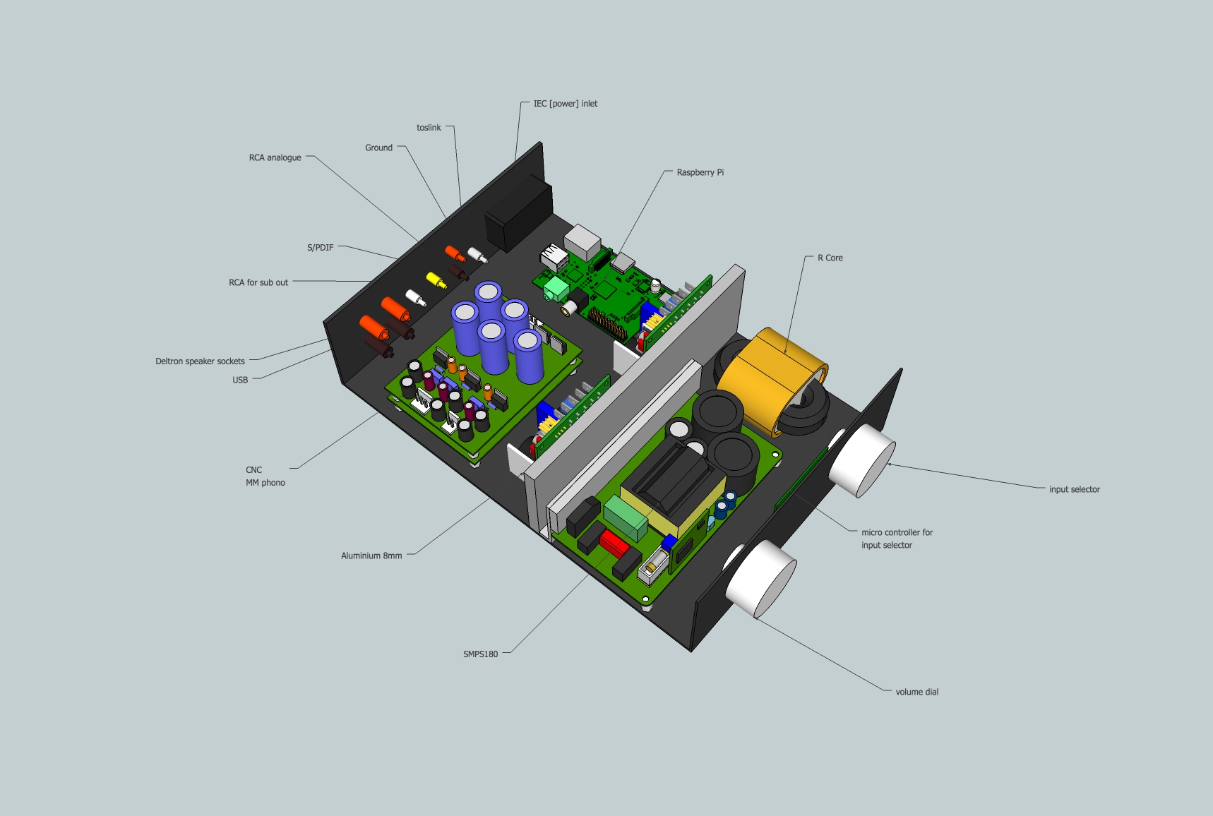

I like that the volume control goes to 11 - I like the clean looking design. Not so sure about squeezeing all including the phono and power stages in a small box - noise floor management will be a challenge.
I think it's quite ambitious certainly, but don't think it's beyond some combined efforts 🙂

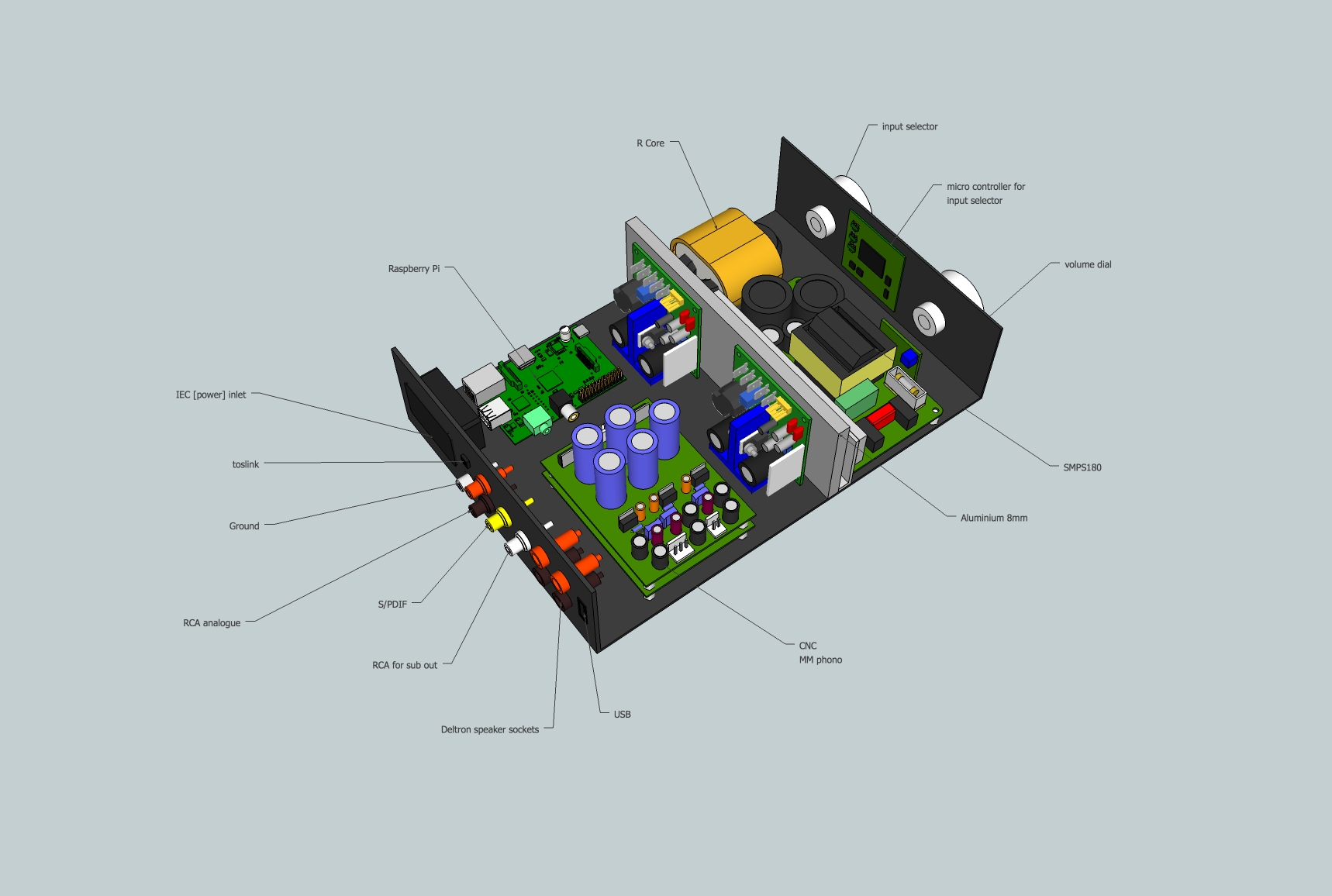

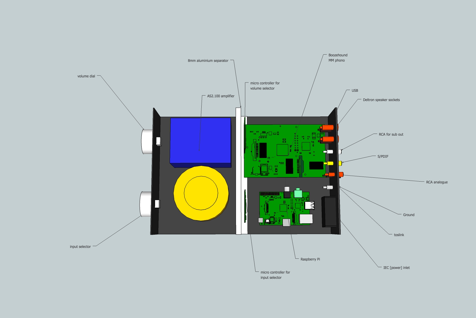

Internal
Unless I've miss measured the AS2.100 here are a few internals for the sled that goes in the case and it's possible layout.
The [boozehound] phono stage takes up much of the rear. I haven't even included another power supply to split to the RasPi and the phono board so it's already struggling with size.
Unless anyone can suggest a more compact but equally well performing MM phono stage or perhaps how to tap into the Hypex supply for this?

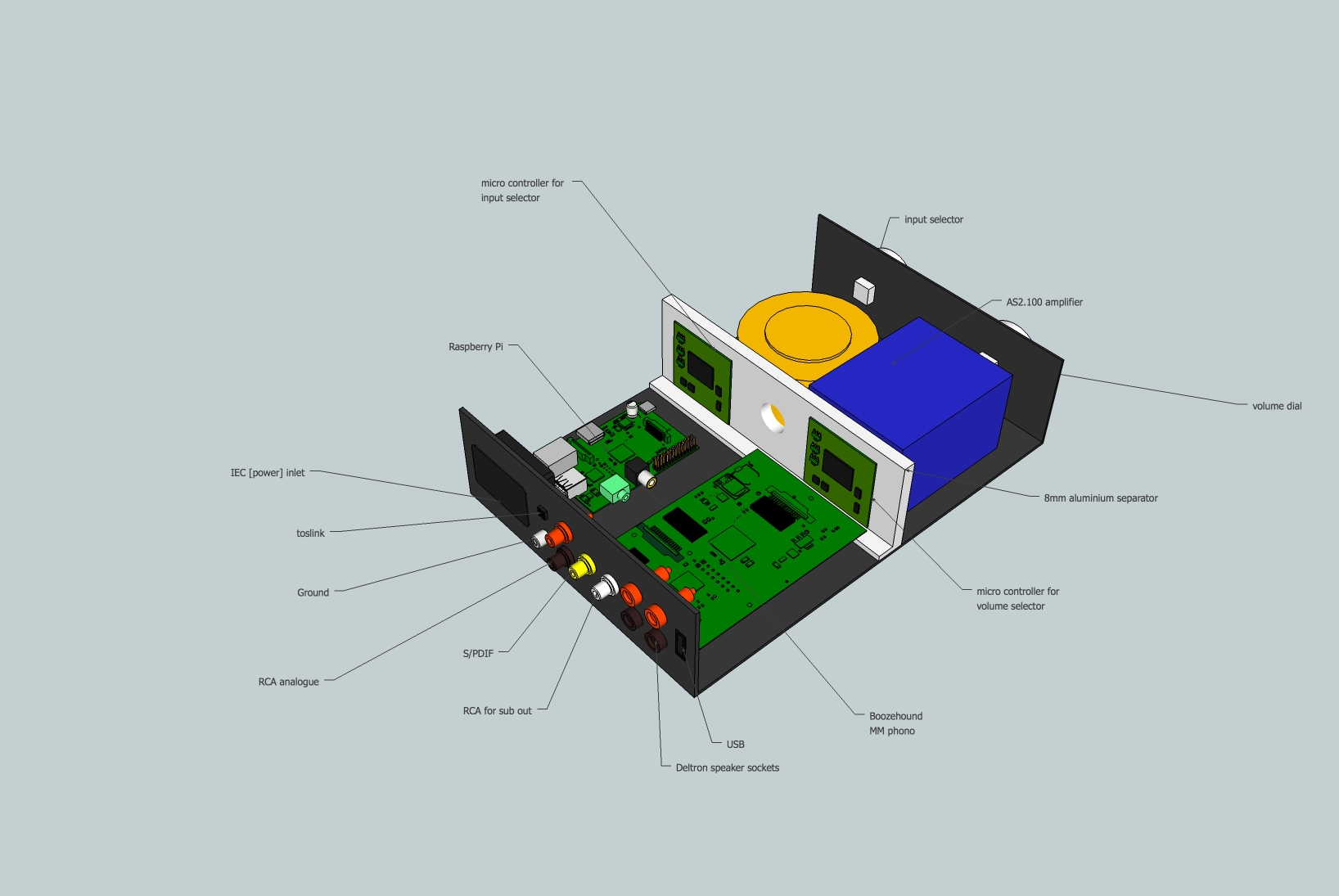

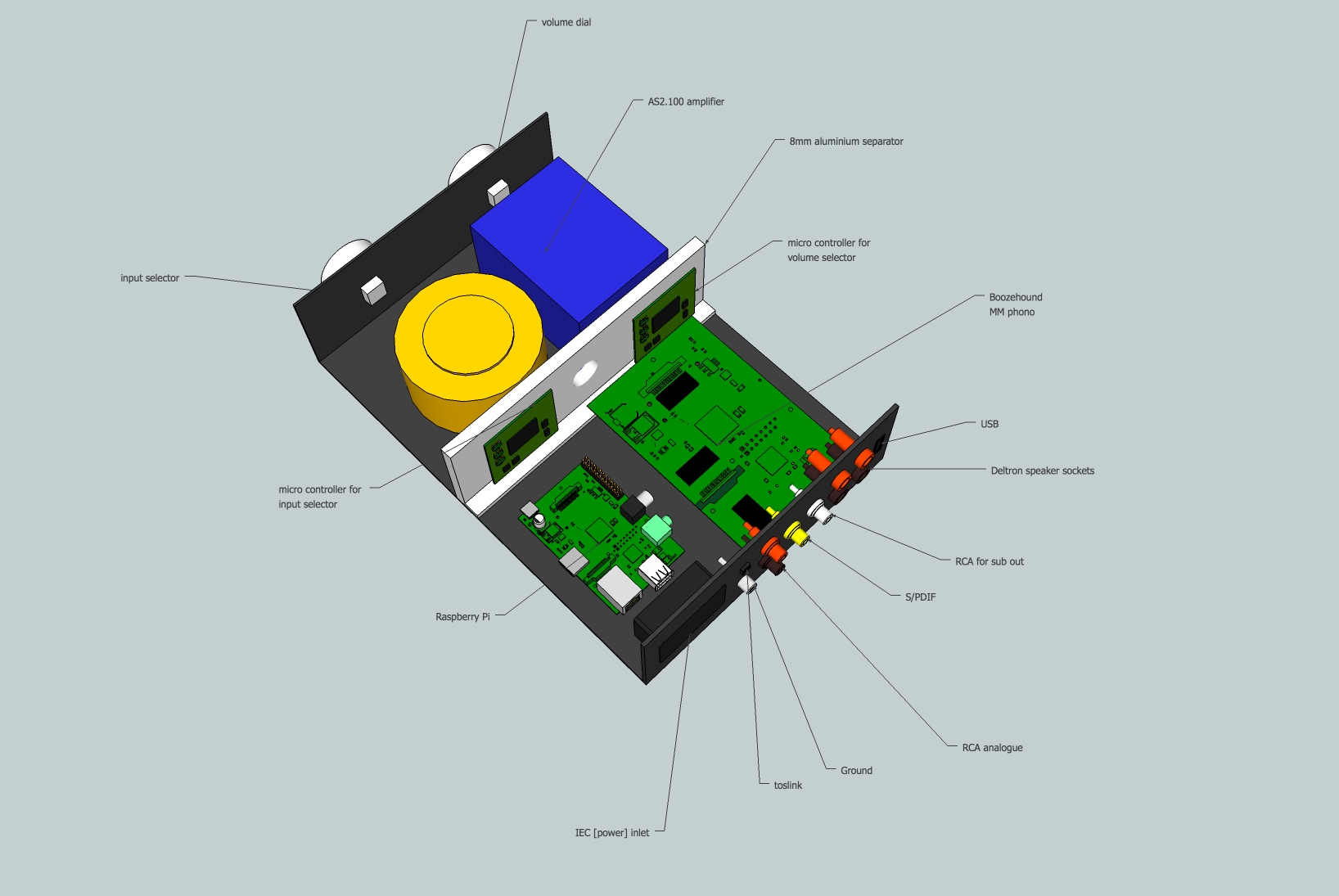

Updated the layout to include a phono stage and dedicated power supply. R Core and SMSP supply relocated.
It's getting tight so looks like the DAC will have to be fitted underneath the Pi on a dedicated cradle.

Right, slight change of tack but still on course, I'm planning on using the Hypex AS2.100D for a rapid prototype. It's got a fair few of everything I need to get this done.
However I'd appreciate a members knowledgeable input on how I use rotary encoders for the input selection [4 in total] and the volume. I believe micro controllers ??? ANone help out with a schematic??? Anyone??? Bueller???
