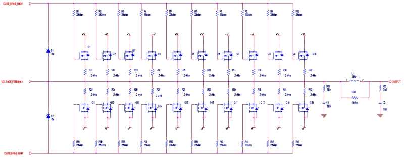

Here is a MOSFET amp I have been thinking about building and I would like your input.
I am a digital dweeb and used to working with DSPs and MCU's Please excuse my poor analog design practices. There are two sections, the PRE-AMP and the POWER-STAGE
I tried to put this amp into a sim. Under high load(8oHm) it tended to have a nasty oscillation. I am proably just going to build. I have a funny feeling in my stomach about analog sims.
Components marked TBD are to be determined. Not sure what I want there yet.
Any comments would be apprectiated.
