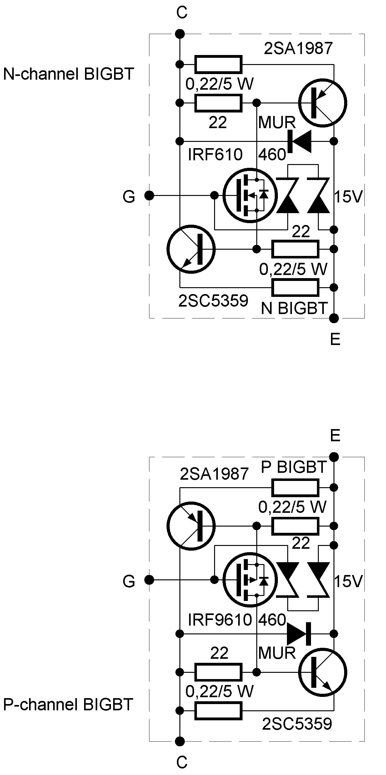

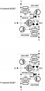

Combination of both technologies is the answer to your thread question.
Let me introduce to you:
BIGBT - The best output transistor for an audio amplifier
The rest is history ...
where can i find more info on this?
Balanced IGBT for amplifier output
Simple Symetrical Amplifier
TSSA - The Simplest Symmetrical Amplifier
