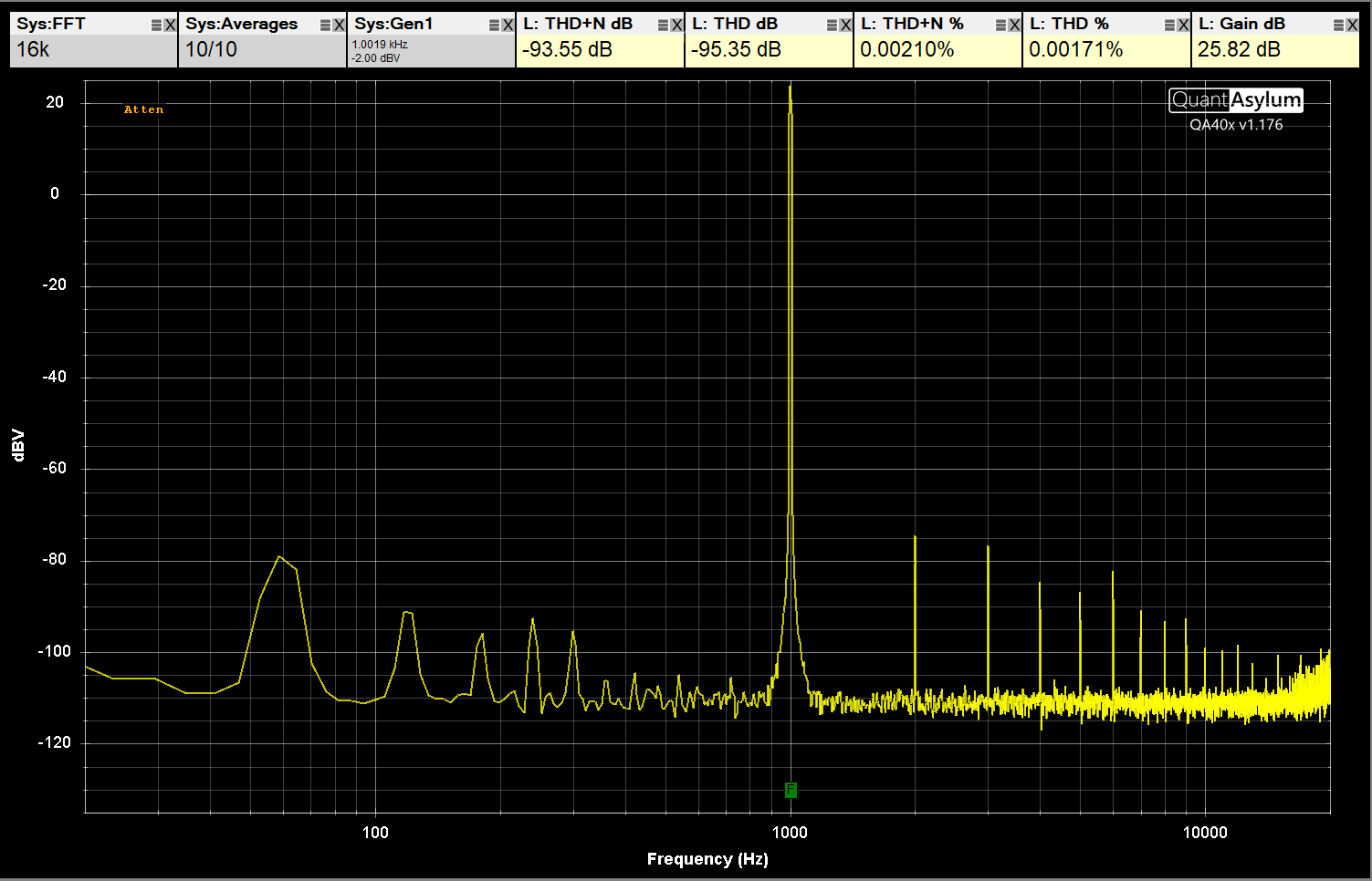

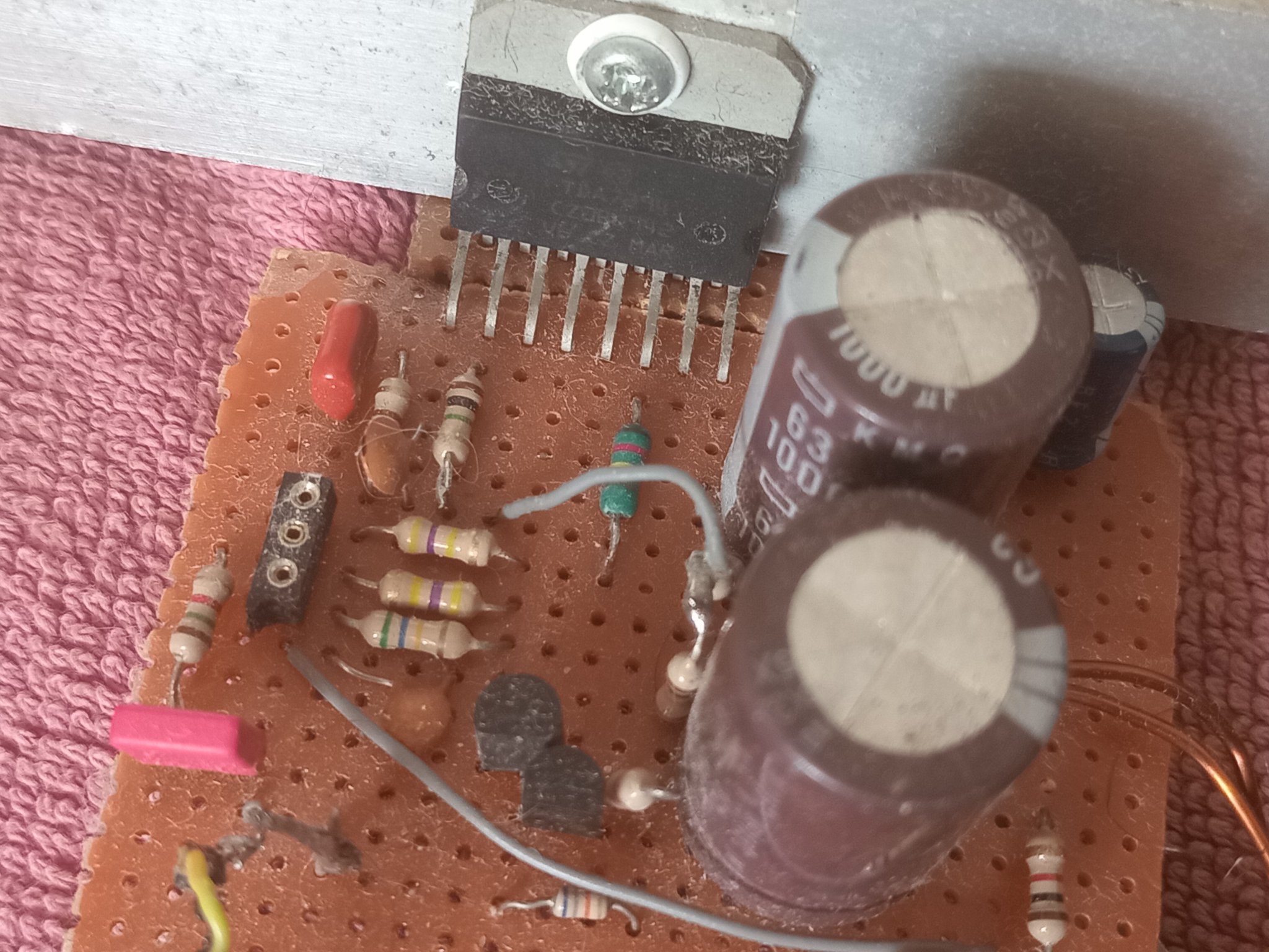

Hi all,
Because LM3886 is nowhere to find I got two LM2876s and paralleled them. These are the same Overture series as LM3886 and sound equally good, except not as powerful.
I was able to get40W 50W into 8ohm and 60W 76W into 4ohm with 24V-0V-24V transformer secondaries.

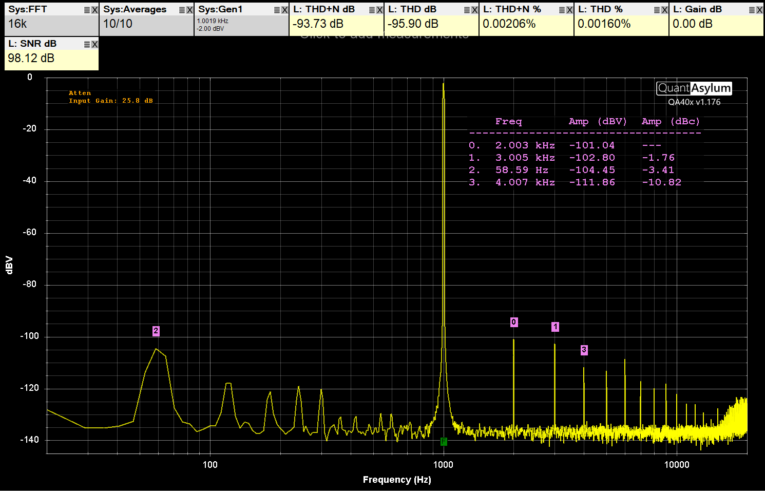

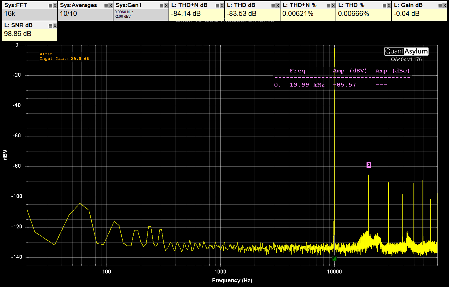

Updated measurements:
Power supply
24V-0V-24V AC secondaries
33.4V DC at idle
Gain: 25.8dB
SNR: 101.39dB
Sensitivity: 0.835mV
8ohm
19.9Vrms max output
49W into 8 ohms
THD+N: 0.0011% or -98.96dB at 1kHz
THD+N: 0.0023% or -92.58dB at 10kHz
Heatsink barely got hot.
4ohm
17.5 Vrms max output
76W into 4 ohms
THD+N: 0.0024% or -92.4dB at 1kHz
THD+N: 0.0058% or -84.6dB at 10kHz
Heatsink got warm.
4ohm 5W output
THD+N: 0.0013% or -97.61dB at 1kHz
Listening tests:
This board sounds amazing!
Great resolution. Clear highs, warm mids, and powerful low end.
Had no problem playing low sensitivity ELAC speakers.
Very dynamic sound. At max volume got so loud!
I would say this chip sounds 95% of the LM3886.

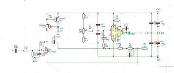

I tried out a Chinese version of TDA7294V from Sanxin, a serious chip maker for medical domain.
It costs $1.5 only and has much better sound than LM3886.
I used it for bellow circuit, with LM3886 is stupid sounding.

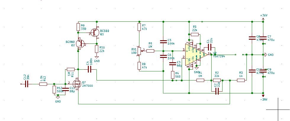

It would be interesting to compare (and measure) sanxin and original versions. Is it possible that both original so to say and those are coming from the same place of manufacture?
Btw, I really like simple idea of the inverter 2N7000 with CCS - only three transistors. How does it sound and measure?
H
HAYK
The purpose of the circuit is to simulate open loop SE triode sound of my 2A3C by low cost chip amp. The problem with chip amps and many bad designed amps, is the low NFB measured @20khz. The feedback with low NFB, generates a distortion that occurs when multiple voices of same note sing simultaneously. It can be large vocale, as the requiems of Verdi or Mozart for the worst case, or large Jazz orchestras. Instead of hearing a pleasant beat, you hear distorted sound. To avoid such distortion, either the open loop should be higher than 20khz to avoid phase shift or the NFB must exceed 60db@20khz. To have the requiem of Mozart inspiring spiritual emotion, the amp must have celestial voice and it gets with 70db. The purpose of the MOSFET is to generate second order harmonics as SET and pull the NFB from 24db to 70db @20khz. The MOSFET and the I/V chip now is corrected 200 times more @20khz than before. The distortion of LM3886 is not modeled, but the noise is and it is reduced by 170 fold. In other words the circuit cleans the nonlinearities of the chip and replaces by that of the MOSFET.

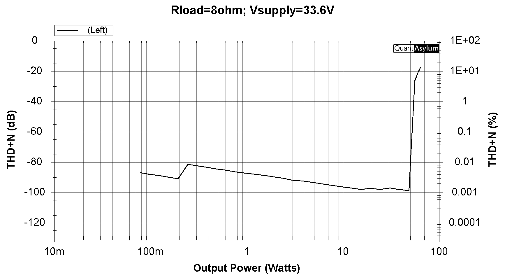

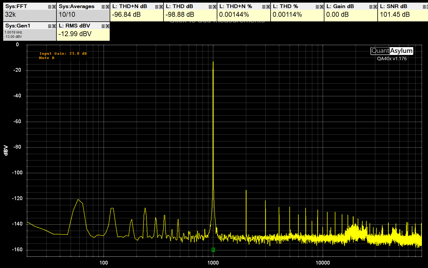

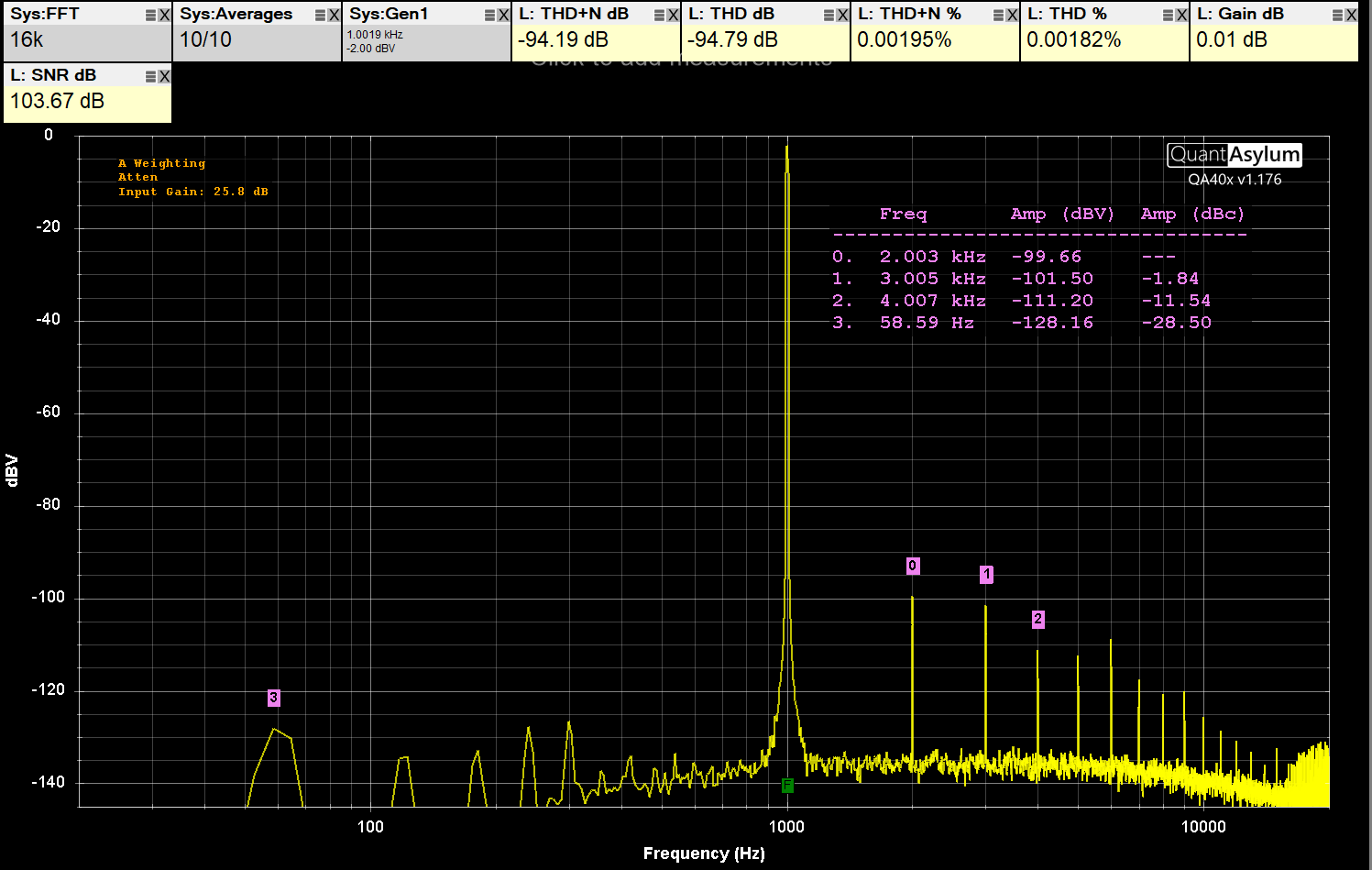

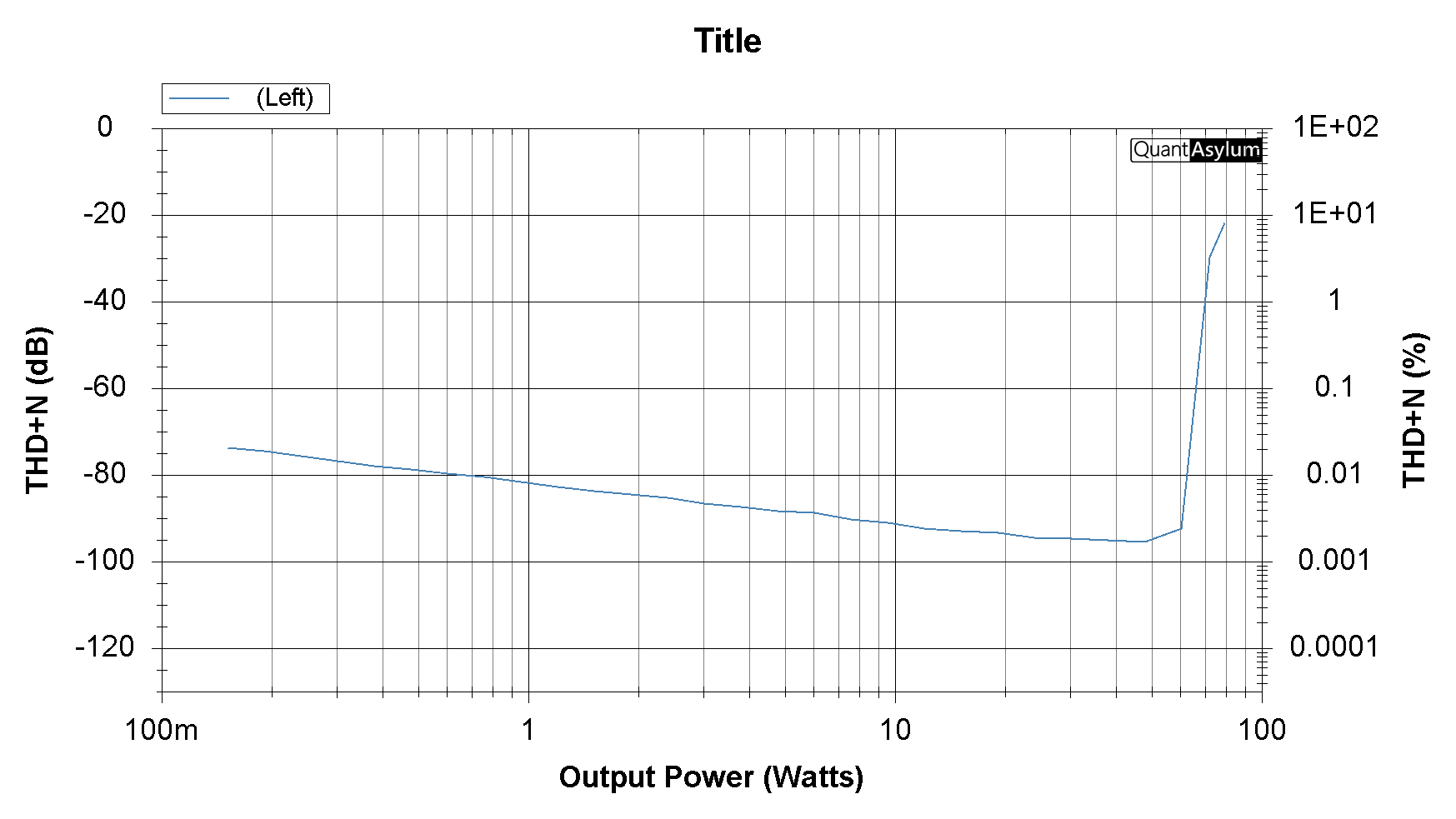

Got new device in the mail and now I am able to measure distortion with greater precision.
Output power graph is for 4 ohm load.
At 5W into 4ohm load THD+N is 0.00144% or -96.8dB

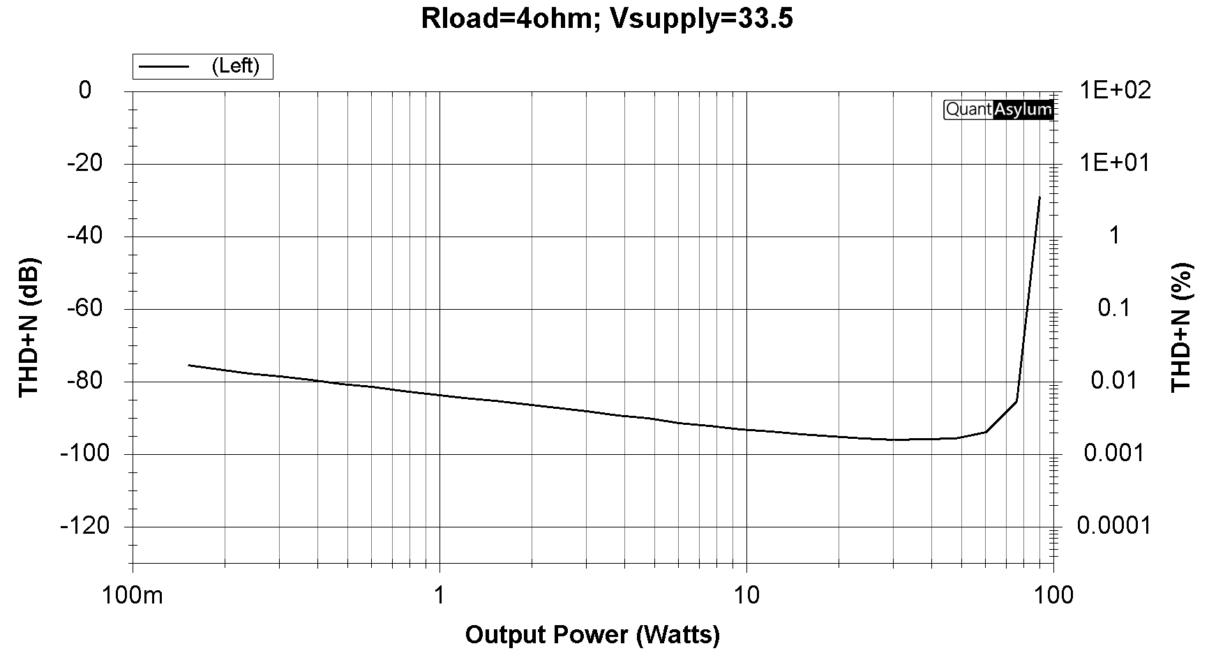

I had a chance to swap transformer for 24V-0V-24V AC secondary - gives 33.6V DC.
Output power increased to 80W into 4ohm at THD+N <0.1%
and 50W into 8ohm at THD+N <0.1%

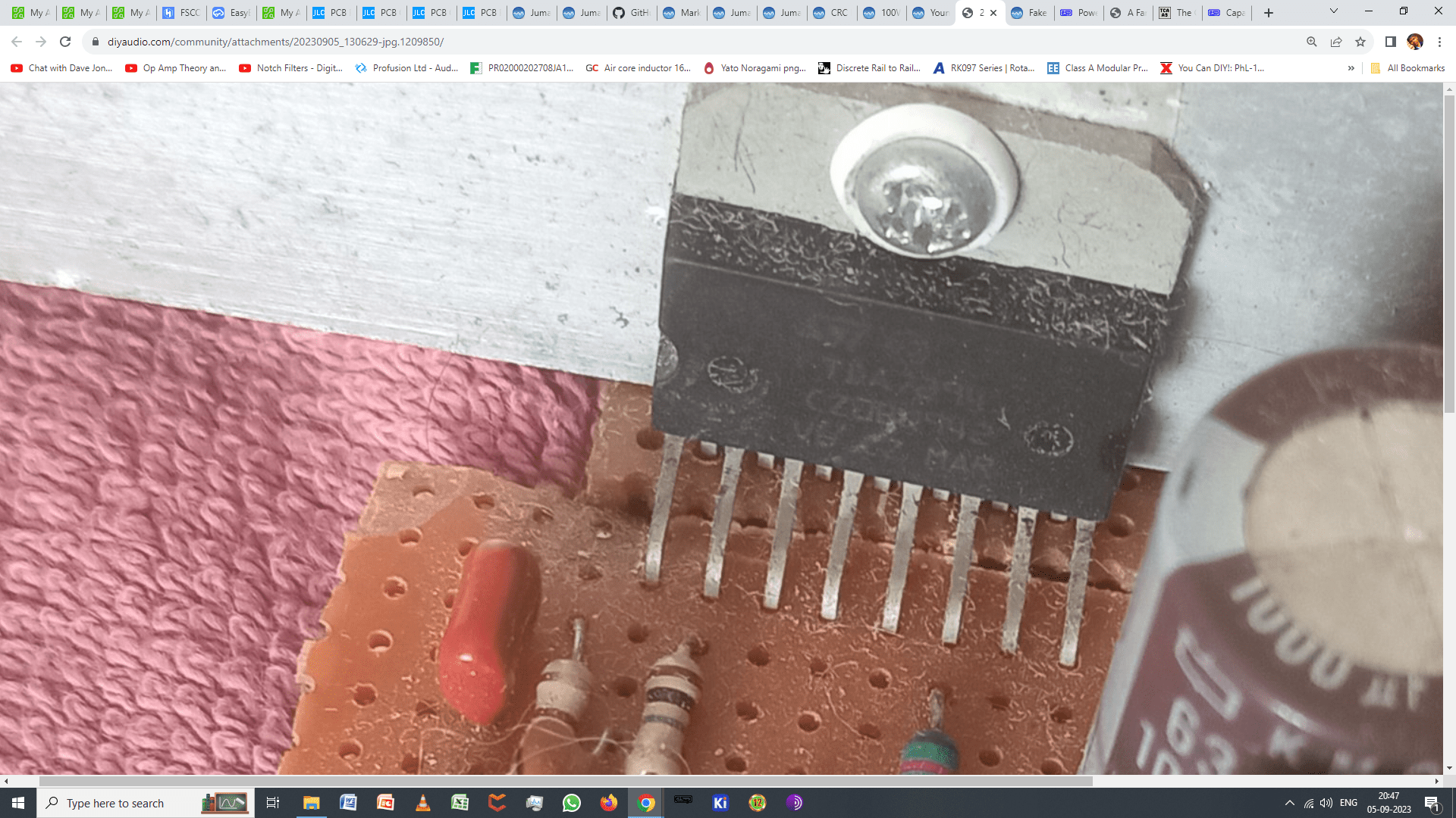

Can you please share the pictures of"Sanxin made TDA7294", Which one you got from the seller as Sanxin made.I tried out a Chinese version of TDA7294V from Sanxin, a serious chip maker for medical domain.
H
HAYK
The chip has no inscription, just black probably to let the vendors write what suits best for their commercial.
Post in thread 'Fake or orginal' https://www.diyaudio.com/community/threads/fake-or-orginal.402947/post-7444790
The circuit you see with 2n7000, makes this chip sound vocals reminds me the quality of 45rpm records.
if that the case then ,how come it have ST logo."write what suits best for their commercial" if that true then they will put their own name/brand on it just like other.The chip has no inscription, just black probably to let the vendors write what suits best for their commercial.
now tell me do you really have that ''Sanxin made TDA7294".
just because you read the "sanxin" on Aliexpress sellers post ,it didn't make it true that it is really a their product.
There are many companies called Sanxin, no chip makers, the medical device company does not make chips.
So your information is wrong.
There are some reputed Chinese companies, who put their name on their products, like CRC Micro and Unisonic Taiwan.
Those are more reputed here than the ones marked with others names like ST.
