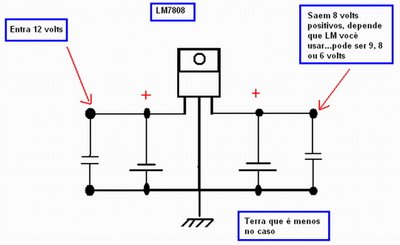

But the better modification is to assemble an LM7808, or LM7806 voltage regulator inside the case... using 2200uf into the input and 2200 into integrated circuit output.

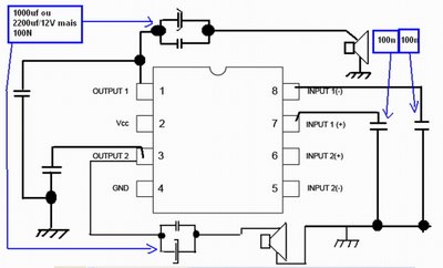

To identify the output observe the speaker wires and also
2 electrolitic condensers that you may found very close one each other.
To identify the input, use the "finger super signal injector"... touch the input pins and you will be able to find them.
Of course, you can download the chip datasheet into the WEB.
regards,
Carlos

Another helping image.
You will appreciate the result, also using headphone you will perceive no more mains noise together your audio.

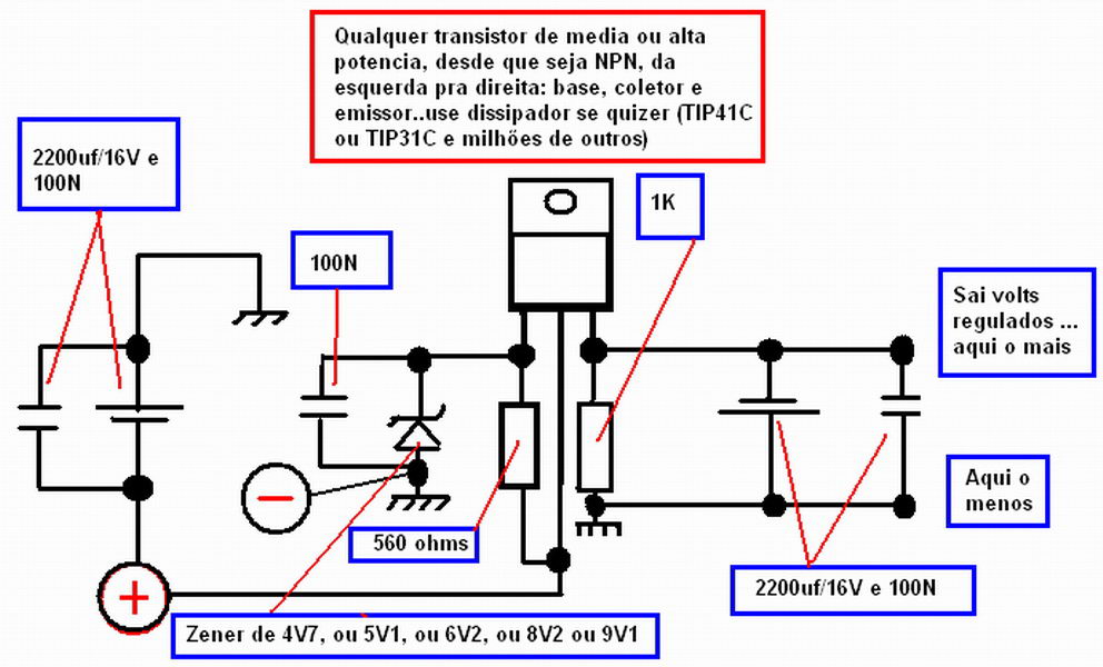

If you have not any step down voltage regulator alike LM7806
or LM7808, or LM7809... then you can produce your own using any NPN transistor you may have into your junk box.... power is small, so, maybe you will not even need heatsink.
Select zener diode depending your chip amplifier voltage.... they use to operate using 6 volts and can tolerate till 15 volts...so.. select zeners to allow you to obtain voltages from 6 to 9 volts to be more safe to the small chip.
Voltage will appear into the output added by 0.6V that is the base to emitter voltage...so... a 5V1 zener will result into 5V7 volts into the output.
Use the condensers you have.... nothing is critical into this small voltage stabilizer, a step down regulator, helpfull and easy... i have assembled "zilions" into this life...so...guaranteed.
LM7908 and others that has the number "9" instead of "8"... are negative regulators...made to adjust negative voltages...to use those ones you will have to invert zener, electrolitic condensers and your input polarity....output polarity will be inverted too if you watch the schematic i have provide you.
regards,
Carlos
