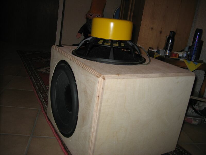

I would use it as an sub Amp for my XLS12 Driver. The advantage of this amp is the include protection and the presentet Layout.

PS. I made an Activ Controller for the sub with an 24 dB High Pass ( 25 Hz ) and an Variabel 24 dB Lowpass . Additional 2 Ful Parametric Filter for Equalisations.
If somebody is interested in ...
