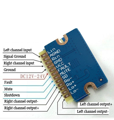

i try to figure out what the actual circuit is compared to the datasheet.
i'm going to solder a strip of 12 pin headers on it and build the rest of the datasheet-circuit on perfboard.
the output lc filter and the recommended snubber are not onboard.
the ic produces a voltage vreg (4V at Pin 15) which sets FAULT (pin 46), MUTE (pin 45), SD (shutdown) (pin 44) into on and off status.
there is no VREG output from the YL2020 board, but the FAULT, MUTE, SD have to be set external.
as the datasheet recommends to not leave those pins unconnected, i will get started with this amp as soon as i found a solution to get control of those pins.
the gain control pins are both connected via a 10k resistor to VREG.
i like how the R-output is close to the pin.
although the bootstrap cap of the L-output is close to the chip, the trace towards the board-output is looooooong.

Mine arrived a couple of days ago, so I tried (rather naively, I guess) to connect it as described by the usual ebay sellers - i.e. leaving FAULT, MUTE and SD unconnected.
Naturally, all I got from the speakers was rather loud buzz 🙁
(I used 12V power supply). The sound input was from my Rasberry Pi server via RCA connectors, input signal was connected/soldered to Lin, AGND and Rin...

Assuming it's like its bigger brothers...
Connect shutdown to VCC to enable.
Tie mute and fault together and connect to VCC through a 10k resistor. This way if fault is triggered it will automatically mute the amp until the fault is cleared. Alternately you can just connect mute to ground.
After looking though at a few pictures of the board more closely, it looks like there are already 10k pull-up/down resistors on the board. I also found a picture that says shutdown and mute don't need to be connected, which confirms that's.
If your board isn't working as-is then I would guess it's either a wiring problem or a faulty board.
THX for your help: as you noticed, the pullup resistors are already there, so nothing changes with these modifications.
The buzz persists, and it's probably a grounding issue - rather noticeable... 🙂
I've used voltage divider using resistors on the input, and got rid of the buzz when no input is connected. However, as soon as I connect input (plug in RCA interconnect cable), there's loud buzz again. Hmmm, will have to check everything thoroughly and fiddle a bit more... current connections are rather messy, will have to check soldering carefully and all signal paths/wires...
