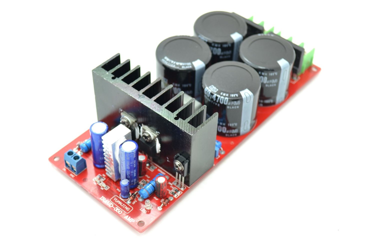

Hi DIYers
I paid a module YJ-IRAUD350 € 38 on Aliexpress and I was immediately pleased with his good sound. I have a big problem, in spite of the power supplied, the operation time, the impedance of the speaker, the power supply voltage, the resistors R6 and R7 adapted for the voltage of 45-0-45 "AC" by 3.9KOhm to 4.7 KOhm, the amplifier goes into protection mode ... and after a few seconds starts to work and this thing becomes cyclical.
These are the conditions of operation:
- Toroidal Transformer 45-0-45 AC - 1000 VA;
- Impedance speakers used: 4 Ohm / 16 Ohm.
- Input: iPod / Computer / Esoteric Analogic Preamplifier / Guitar Tube Preamplifier etc. etc.
The heat sink is hot (50 ° C) if the volume is high but is lukewarm if the volume is low. I do not know what to do ... Help please. Thanks to all those who will answer

Hi, change the mosfets with IRFB4020 or IRFB5615 if your power supply is not greater than +/-60Vcc

I think Jacob means that as your DC voltage is over 60V-0-60V then you need higher voltage MOSFETS.

The 2092 is detecting an over current event and is resetting itself for a few seconds.
I don't know what mosfets you have in there but if they 4019's they wont drive 4 ohm loads.
If you want to drive 4 ohm loads then you need better mosfet. The trouble is more powerful mosfets tend to have higher capacitance which will upset over current detect again.
I would try it with 8 ohm speaker and see how you get on.

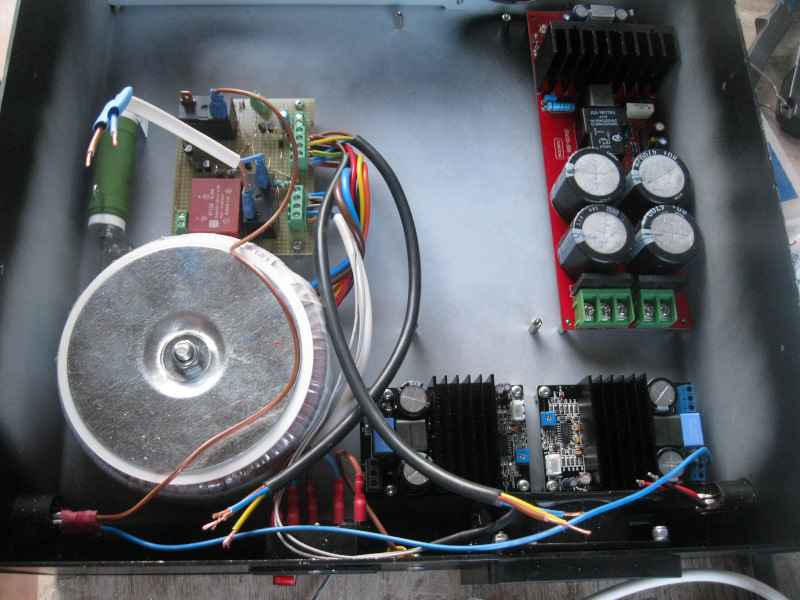

the infineon IPP320N20N3GXKSA1 is a much better choice, 3xlower rdson,still lower gatecharge and reverse capacitance than the fets normally sold with this aliexpress device. I changed the relay into a 48V device to save power in de series resistors.
the change to 4.7K may not be needed, it is advised for voltages above 50V AC. 3.9K for 40- 45Vac. you may run short on the local rails otherwise
it's a bridge mode using 2 IRAUD350, and 2 smaller ones for the HF side, bridge driving into 16 ohms. plus softstart and dc prot on the left PCB with 2 relays.
The fets that came with my IRAUD550 were IRFB23N20D: 100milliohms, Qtot 57nC, mostly due to the large feedback capacitance of this outdated FET (2004).
the infineon IPP320N20 (2011) has 22nC, and a resistance of 32milliohms. the heatsink between the caps on top of the irs2092 is the result of the large charge it needs to drive. it will run cool with the infineons.
also the 63 V supply makes that the IRS2092 needs to work harder because of the large drain gate charge of the IRFB23N20
I just need to check the deadtime as the lower output capacitance of the IPP gives a faster switching , also due to the lower gate charge drive requirements.
the current deadtime is 45nSec (10k,10k) and that may be OK for the infineon but maybe too small for the slower IRFB32N20 fets, maybe also why they heat up so easy.

the infineon change has a lot more implications. the dead time needs to be set to 25ns. the overcurrent thresholds need to be adapted to the much lower RDson.
on top of that the elcheapo output inductor heats up (100degrC at 400khz) due to the much faster rise time, So i'm winding a powder toroid. also the inductor seems to saturate on the temperature and medium power, then the dc detect (uPD1237)switches the relay off. all in all the infineon change may not be such a good choice...
it turns out all the idle power goes into the output inductor, as this one has to push quite some current back and forth especially at +/- 65V. tried various mixed of powder, but T200-2 gives the lowest idle power and virtually no heating of the output inductor. A bit large though. I will try the sagami or ICE parts, hope they do better than the chino's
