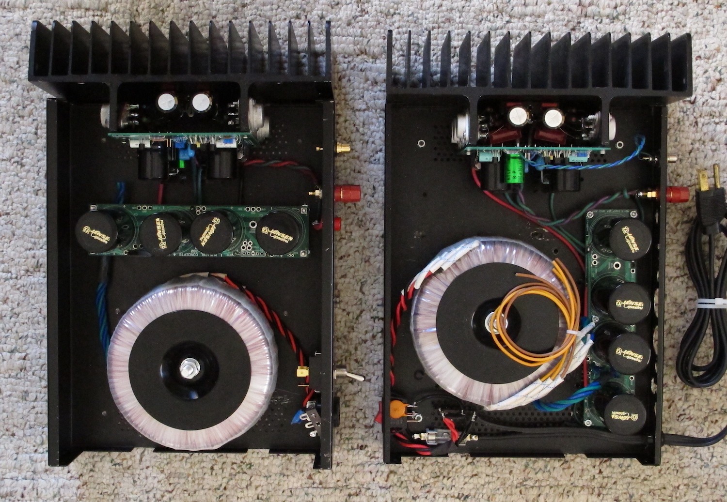

Sort of off topic ~ but related. I have been listening to several builds,
the past 6 months, with 6 single Exicons with 82 volt power supplies
("challenging" ' testing the heatsink capacity) running 8 ohm loads.

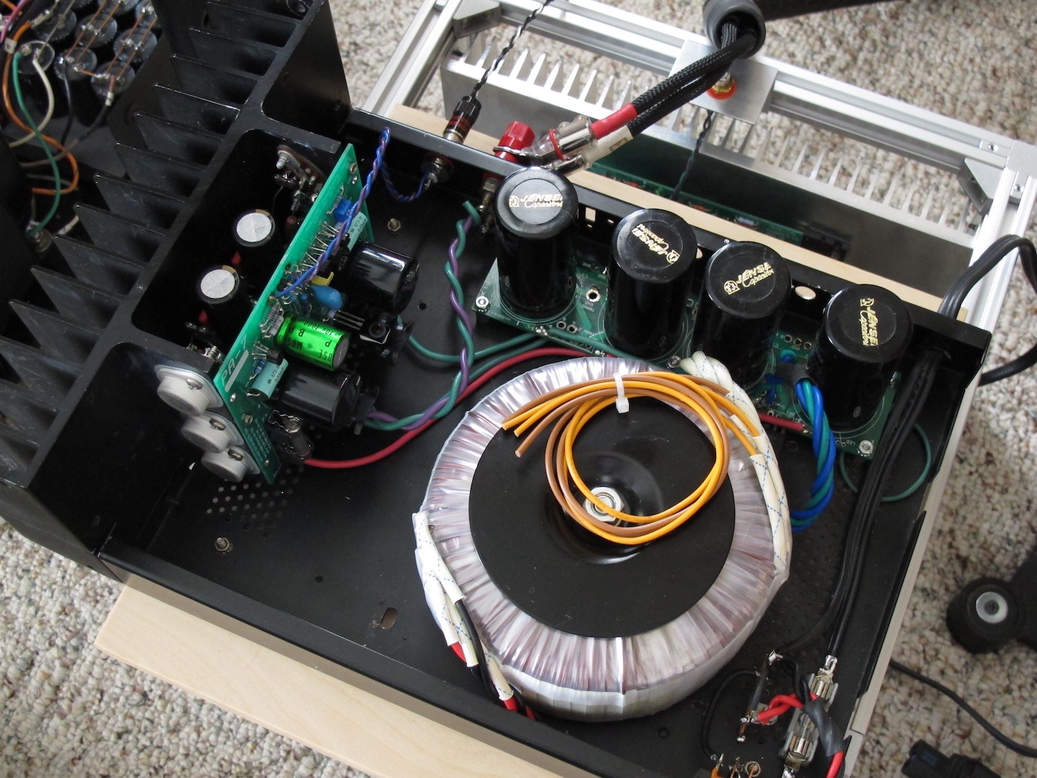

(L) 63 volt amp / (R) 82 volt amp, on image 2.

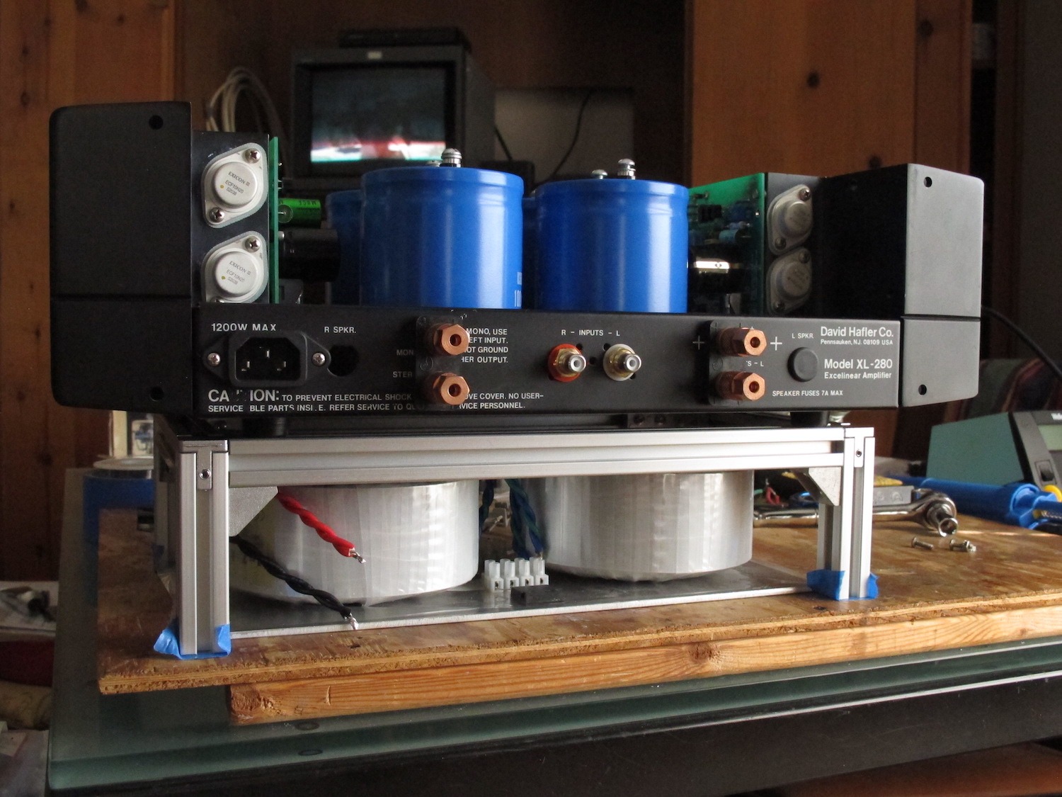

Well, I like it SO MUCH, I have plans >in the works< for a "XL280"
with "Hafler 500" power supplies, on a 200 chassis.
It had to be 2 story to fit. Stay tuned... 🙂
Beefy power supplies were required to deliver on this...
  • P230 : 82v:600w : Exicon singles.jpeg
  • P230 top : bottom copy.jpg

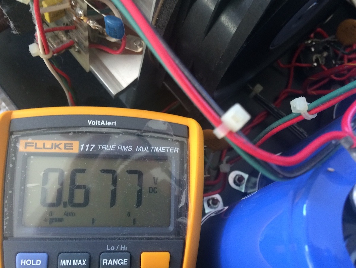

Be SUPER CAREFUL buying XL280 (and XL600) FWIW.
The front ends [on most] are "out of tolerance", DC offset is too high
with no means of adjusting and NO REPLACEMENT FETS!
Test these amps (people never do) for DC offset before buying one.
The image shown, XL600 .after. the "protection relay" connect
to speaker load...
This amp saw a resistive load, never drove any of my speaker
until completely rebuilt [ditched the stock boards]
it was unusable (as sold to me)

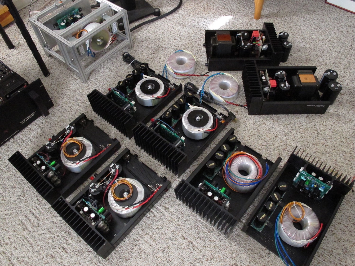

How about using two 220 chassis and make mono blocks. Lower voltage, but all the current you need.
I went this lop-sided amp direction, to fit the PS into a (single) chassis.
I have (4 pair) 8 similar mono amps, built in different configurations...
but as identical mono pairs, by using the chassis tops as chassis pans.
The XL280 (not shown) was for simply sh!ts and g!ggles!
Actually more like a "Hafler 500" .without. a fan.
~ the HIGHER voltages ~ to me, result in a more "propulsive" sound,
with greater weight and body, all desirable. Struggle for a word.
