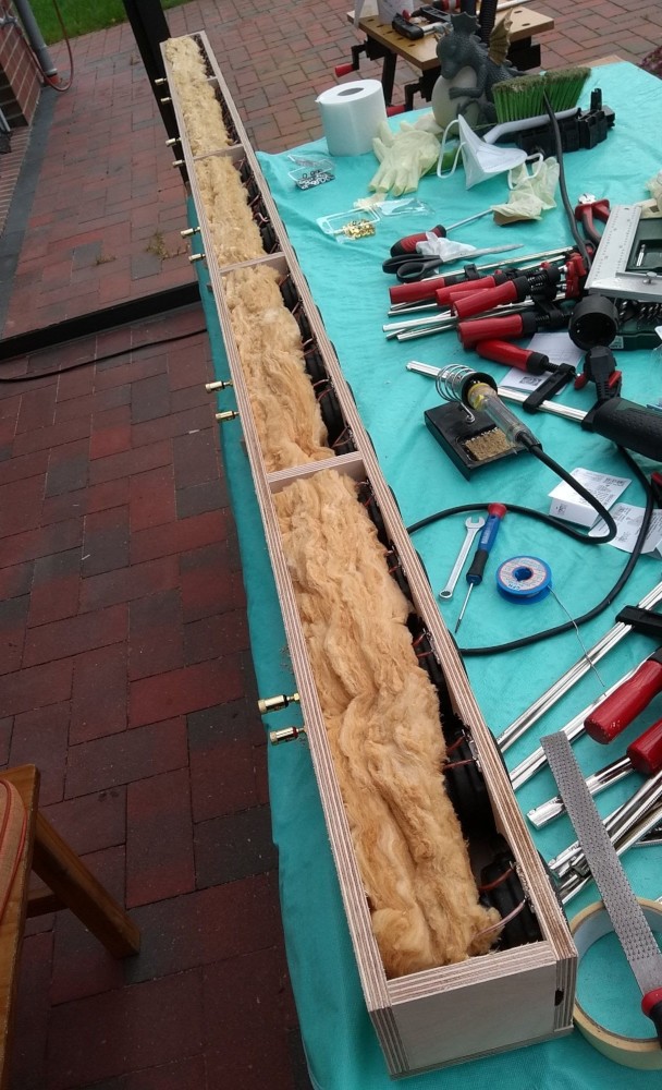

I've started the build on Oct 26. Here are some pictures:

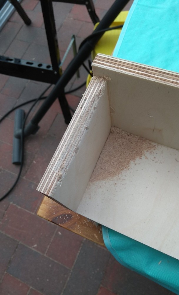

1 - First baffle chamfered on the back side
2 - Preparing the second baffle
3 - Both baffles done
4 - Cut outs on the first baffle done
5 - Driver fits 😀
6 - Cutting out the second baffle
7 - Both baffles done
8 - Preparing internal cabling. Five drivers in series, five groups parallel for 8 ohms impedance or all in series (200 ohms) for OTL experiments (I have lots of 6P45S sweep tubes to be used and enough power transformers for circlotron amps)
9 - Hooked up some cheap chinese 30W Class D chip amps for testing purposes
10 - Drilling 200 holes... 😕

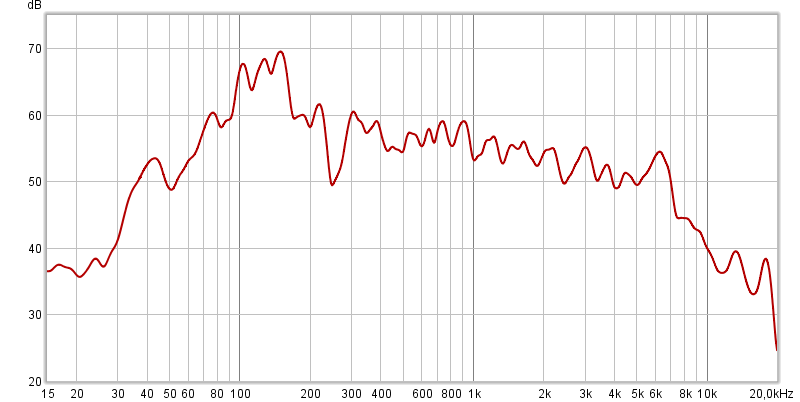

I've got my second USB interface so I can do measurements of the filtered system now. I'll do that tomorrow (it's 10 pm here and I don't want to annoy the neighbors with sine sweeps...).

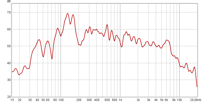

You want to see something ugly? 😀 I've got the in room response for you without any EQ!
Left:
Right:
Lot's of EQ needed, but that's expected. The low end will be Linkwitz transformed. (drivers are able to dissipate 500 Wrms / 1000W peak, to reach the xmax of +-4.75mm I need that power) Sensitivity in the highs seem to drop to that of a single driver, well that's expected with point sources in an array at short wavelengths. But fortunately Le is pretty high. Z is about 55-60 ohm @ 20 kHz, so I only need lots of voltage swing, current is low (I have two IRS2092 boards rated at 300W / 8 ohm, 600W / 4 ohm, even capable to go down to 2 ohm) I consider getting another two and bridge them if I like the sound.
Also there are four 625 VA / 2x 50 VAC toroids waiting, so I should be able to get something like 1 kW continuous with 1.2 kW peaks out (continuous power limited by the transformers and I probably need to upgrade the heatsinks, they look like they can dissipate 10W or so, but I have an idea for that). Right now I only need to make a PSU board and a phase splitter for BTL operation.

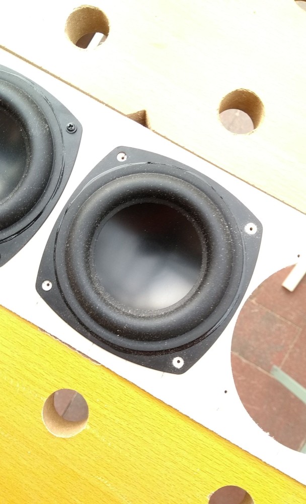

Drivers fit:
Or not. I've done the calculations in my head and messed up the internal height, so I had to improvise:

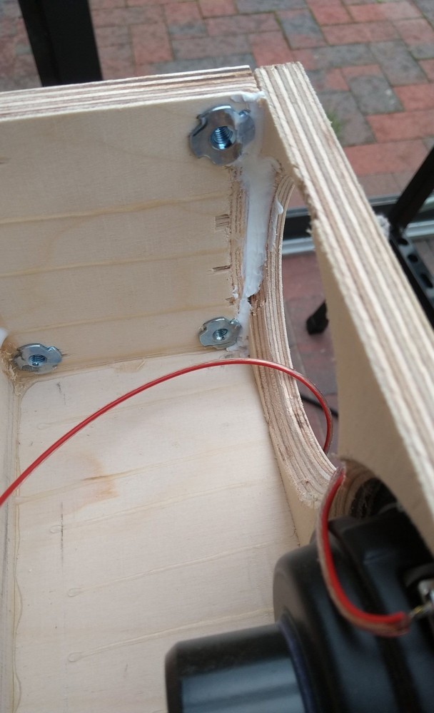

I'm using drive-in nuts for mounting the stand:
Left:
Right:

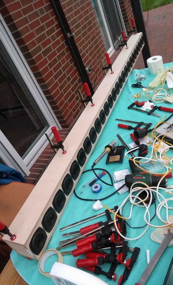

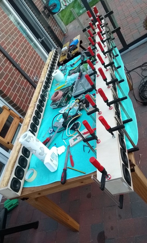

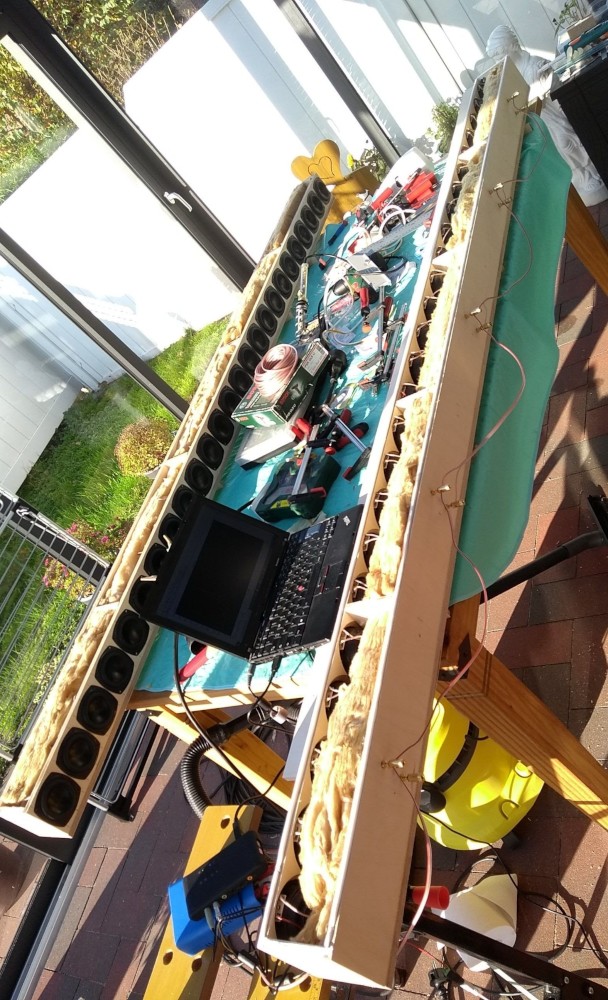

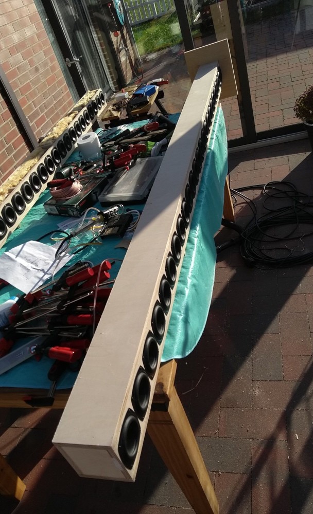

Here are the remaining pictures from the build process:
First array assembled:
Second array getting glued:
Preliminary placement in my room (excuse the clutter... 😀). I consider removing the stand, moving them completely into the corner and treating the first reflections with absorption panels, as much as it's possible. The old, disconnected floorstanders might have some use later. If I place a large AMT like the Dayton AMT Pro 4 on top of them, I get it exactly to ear level, since I have a currently unused pair of them to test it...
