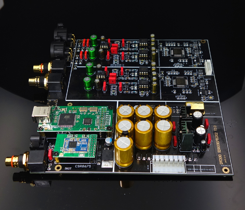

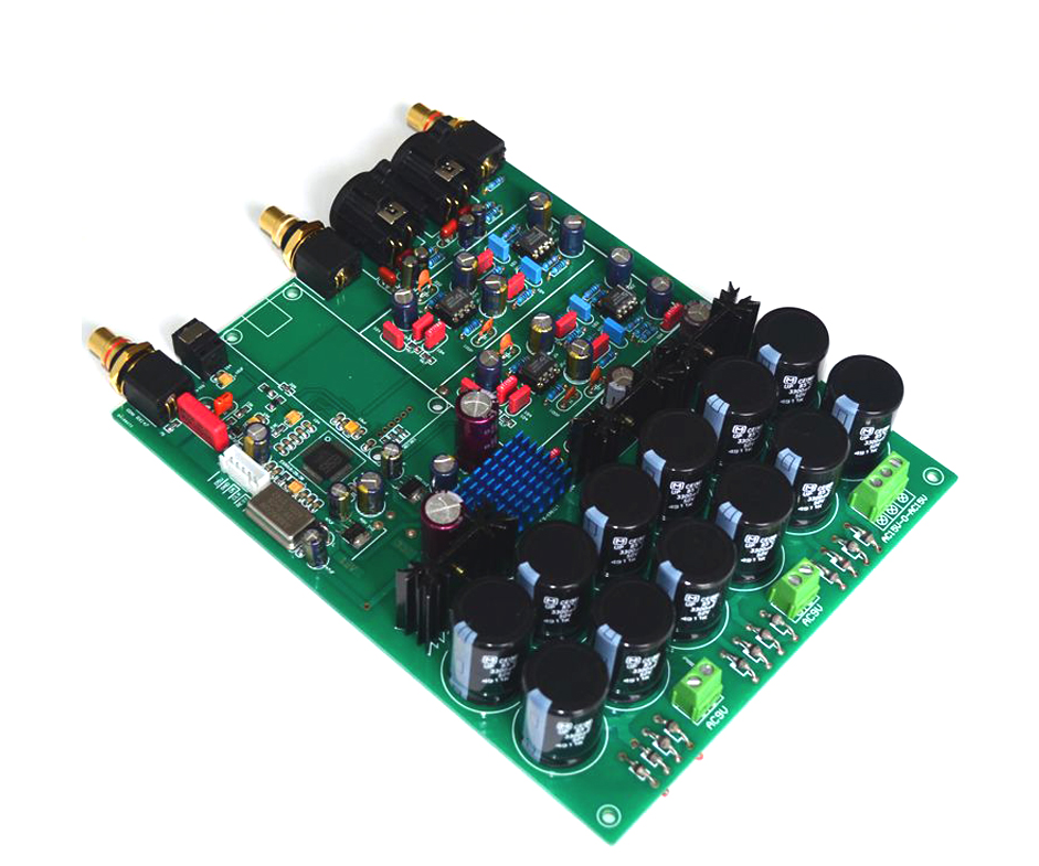

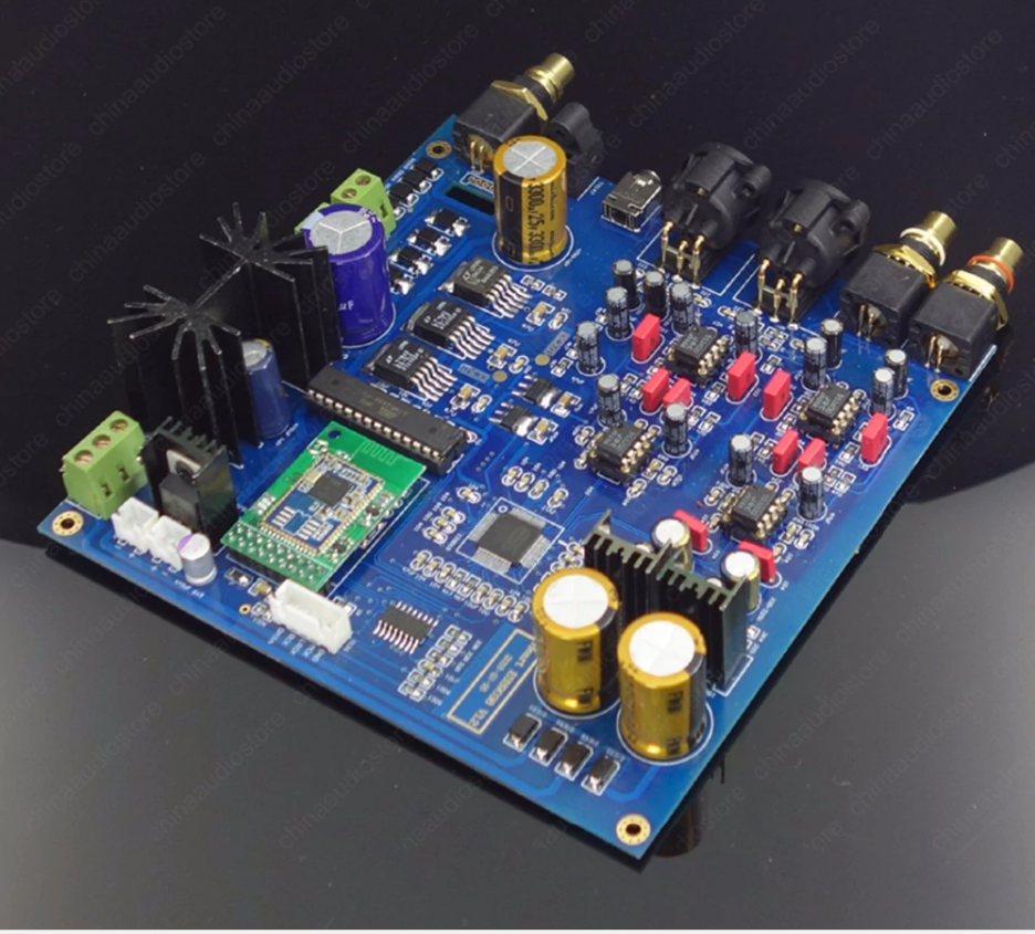

Hello all, I'm new here and this is going to be my project thread. As I briefly stated in my intro here I am looking to build a DAC to use with a power amp that closely mimics the Oppo Sonica DAC, but after reading so many threads here, I now believe there is a possibility to build something even better (somewhat based on this). So after processing the overwhelming amount of options and information overload, I have decided to do this project in two phases.
Phase 1 Goal: Use something off the shelf like the three options available on ebay/aliexpress and replace all possible components with better alternatives.
Phase 2 Goal: Pursue building something from scratch (either using something from audiodesignguide.com or scratch if I can find the help/resources).
For Phase 1, I need help with the following. I am reasonably familiar with electronic components but software is really my strong suite (if I ever get to the point of improving firmware).
1) Which of the three options here present a good starting point or has the best layout of the board to derive the most out of the ES9038PRO.
2) Based on 1, next would be what parts to swap out with better alternatives? (From reading around here, most obvious things would be clocks, caps and op-amps?)
Probably better to use ES9028PRO. Likely more practical to get better sound quality out of that verses ES9038PRO due to complications with powering AVCC in the latter chip.
Regarding Chinese dac boards using ESS PRO chips, most or all of them tie AVCC_L and AVCC_R together causing problems with left/right channel separation and problems powering AVCC with the best sounding power supply solutions (even for ES9028PRO).
If 8-channel outputs are wanted, don't know of any of the Chinese dacs offering that.
Also, costs of buying a board, replacing most of the parts and most all of the power supplies, buying a case, power transformer(s), etc., gets expensive by the time everything is done. May as well consider how much one can afford to spend on a dac, what it is to be used for, what level of sound quality is required, etc., first.
Another factor might be how much work one is willing to do to have a completed dac meeting the goals.
Often buying and modding a Chinese dac board is not the best solution. At least, one should know what one is really getting into. Lots of people start projects and don't follow through to the end. Sometimes in the end there is a working device that doesn't meet the original goals, sometimes not. Sometimes it can work out well, depends.
