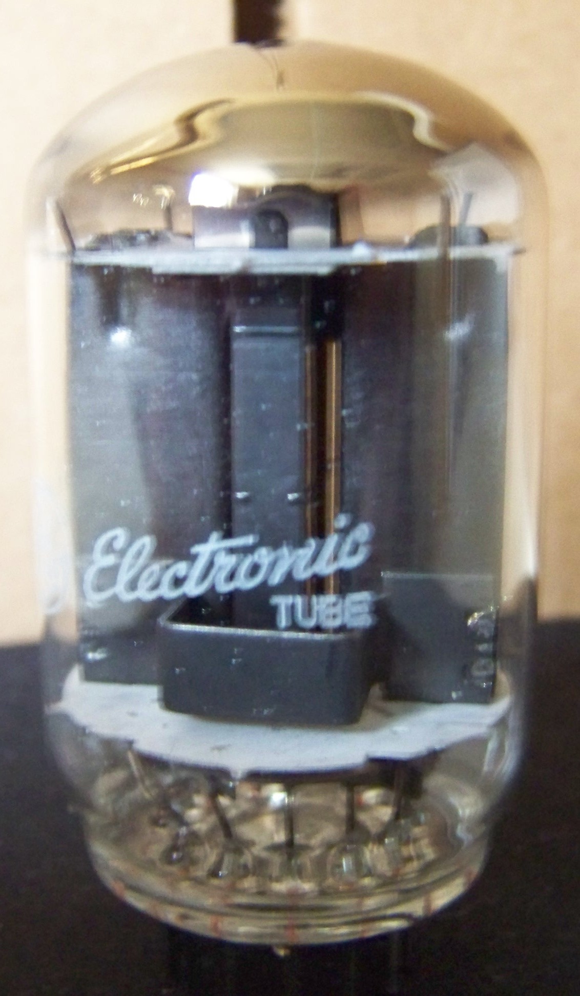

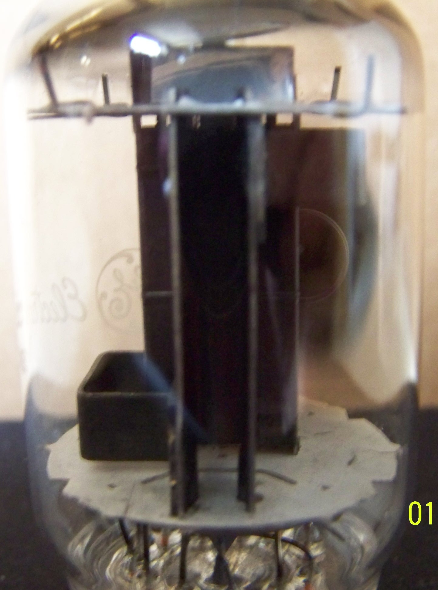

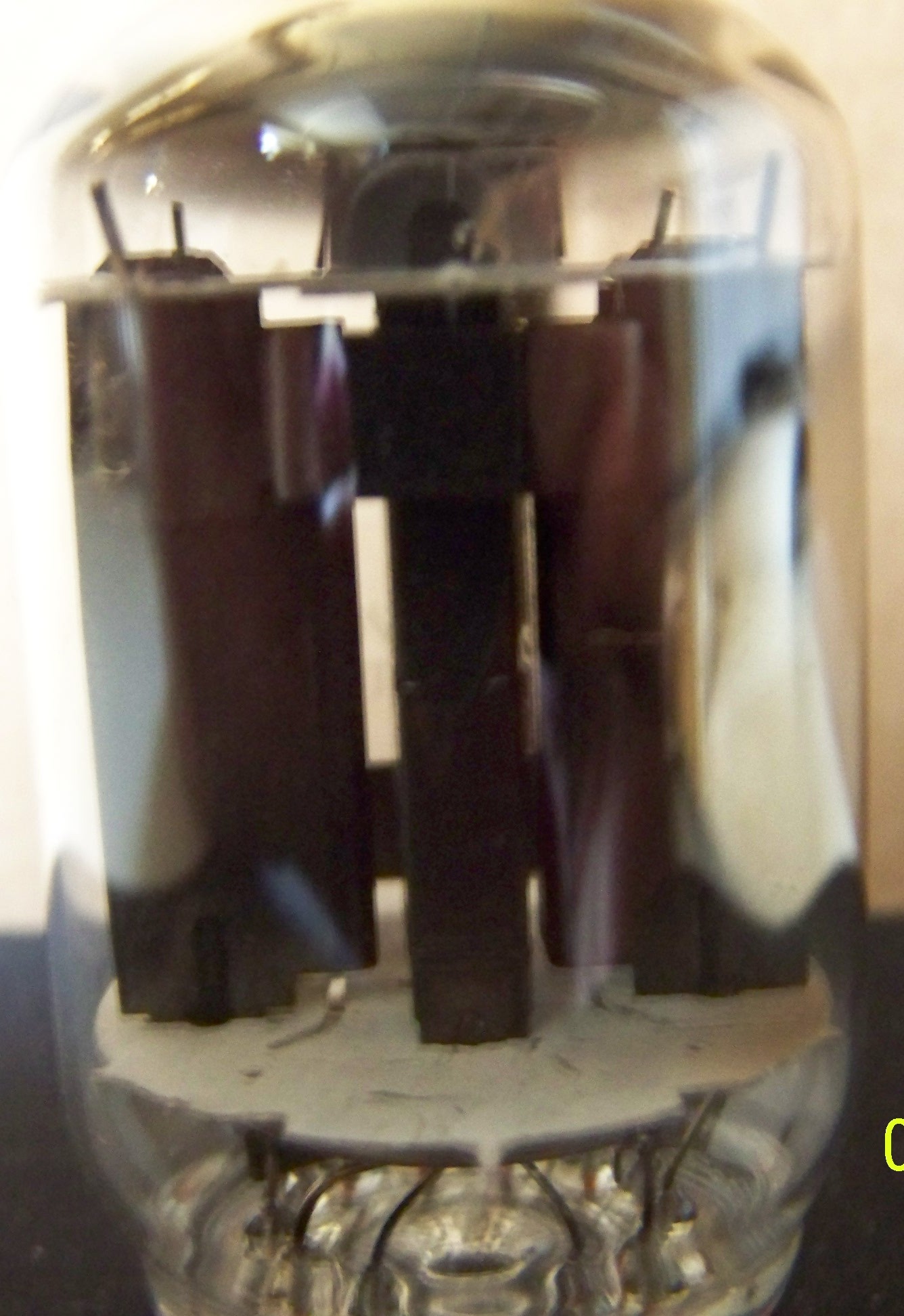

Got some 7984's to play with on the weekend. Thinking of 500v Eb, 250v G2 and 5K P2P. Thinking ~30ma/tube idle.
