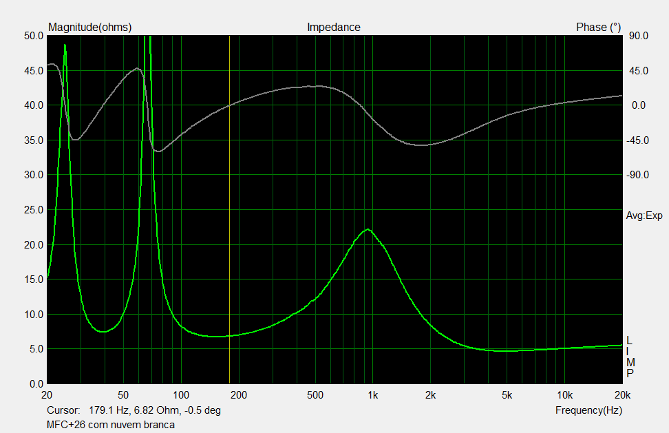

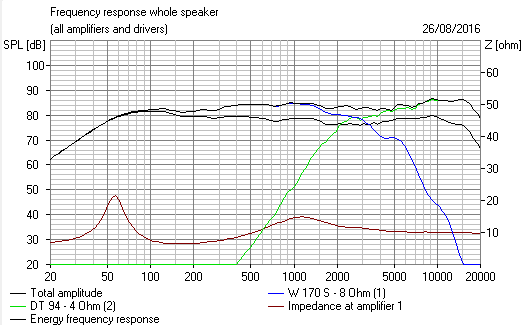

Some measurements, starting with the resulting impedance
The box is ported but at moment I have at work and don't remember the resulting dimensions.
Interesting is: the crossover point is 2.5kHz, but the impedance hump occurs at 1kHz (well, several projects have same resulting Z, anyway...)

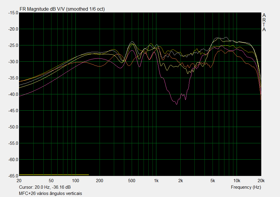

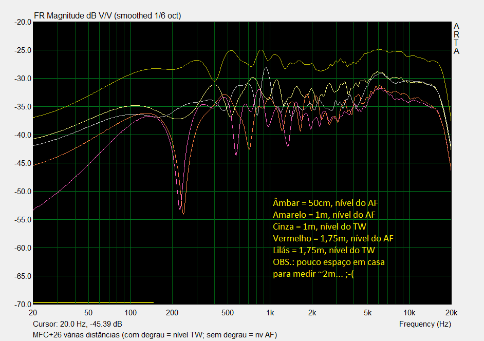

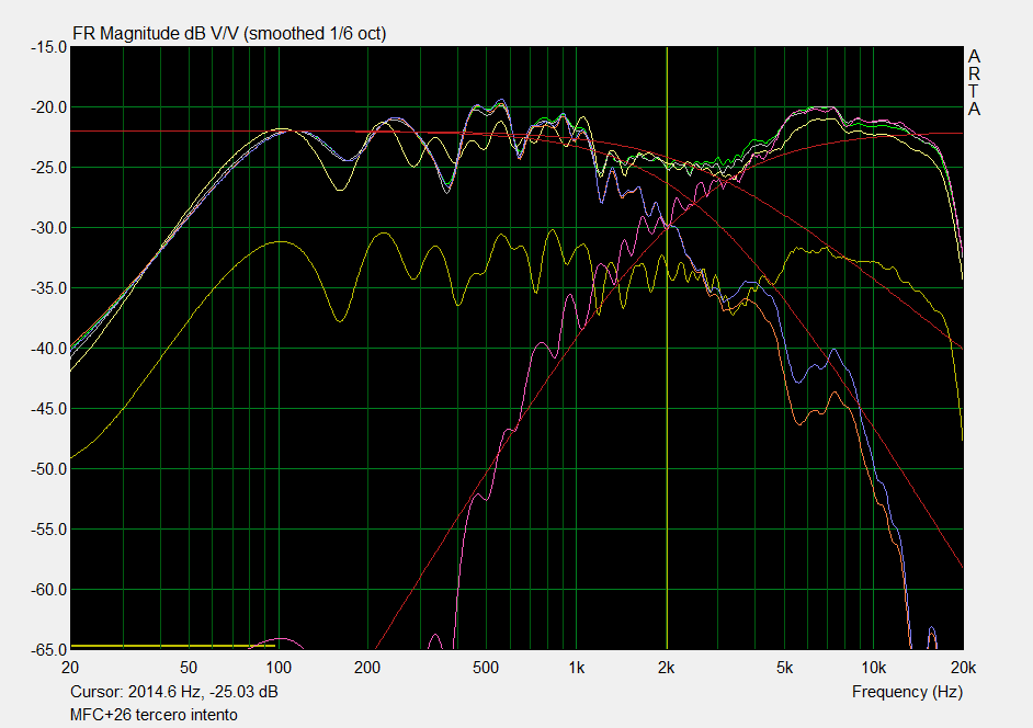

WARNING 😀 : Some acoustical measurements, for some tries
"Almost all" using 1/6dB smooting and some 6~7ms gating

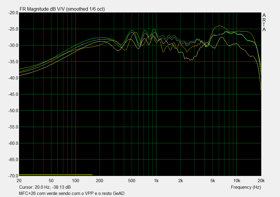

For the 7th figure (last figure), with portuguese inscriptions, note the higher measurement, is the most flat response I can obtain until today. +/-3dB or so from midrange up is not tooo bad, but is only at WOOFER axis ("nível do AF"). At this point, the midrange/low treble response with most music are basically neutral.
For the 5th figure, various vertical angles. Maybe the cross point are not yet well matched, since the vertical response changes too much (even considering the stepped baffle, I think). maybe need some refinement.

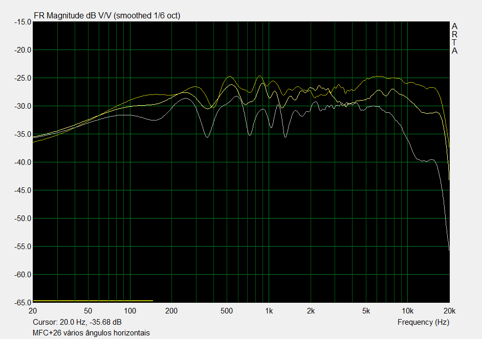

For the 6th figure, is to check the horizontal dispersion. The purple/blue (what a color...) is a extreme angle, so the tweeter HF suffers, but obviously the cross response is OK here (relative to not change with angle).

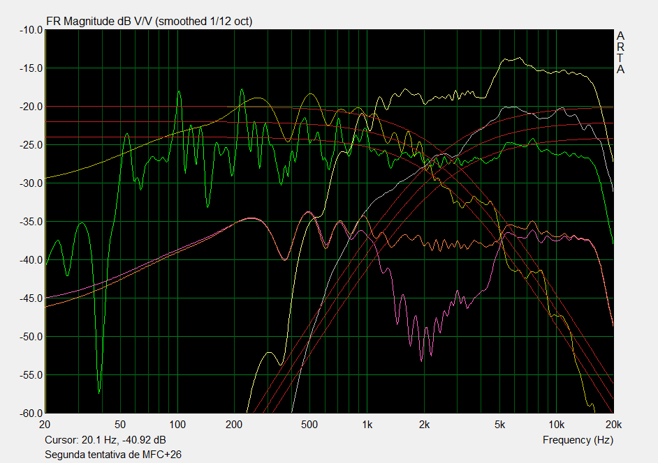

The first other figures are the first attempts, and I love to use too much the overlays
😛😀 Some show the attempts to match the desired response per driver/to match the L-R 2 target.
Since this is work at progress, tomorrow will have some new measurements, including HD sweep

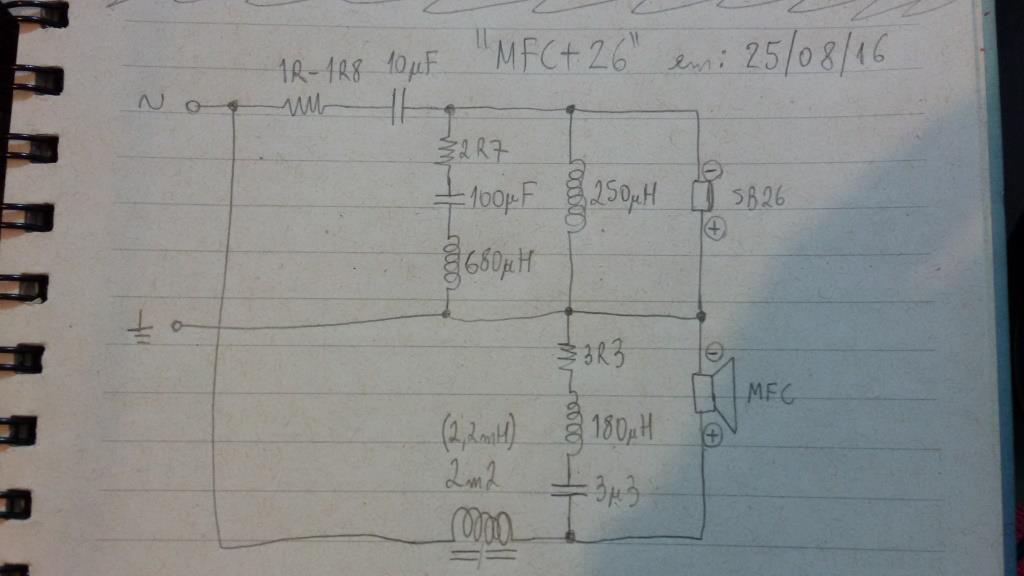

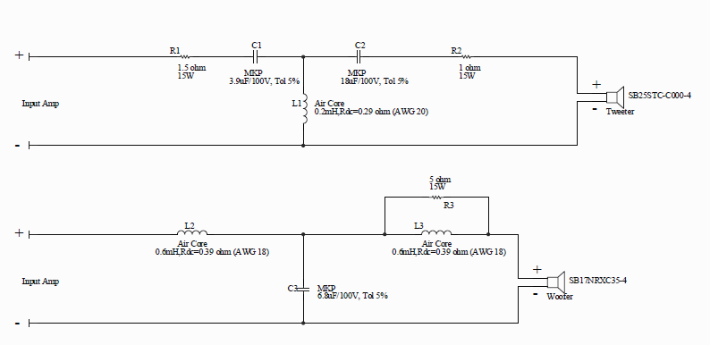

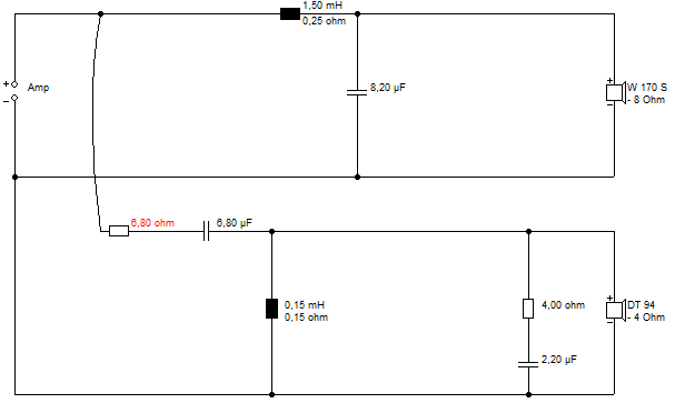

Follow the resulting crossover, for now. The component quantity is based on Troels project 😀
. The tweeter notch is made oversized, to cut down the response at tweeter resonance (is awful sounding) and to match the 100µF elcap.
By the way, even the Troels solution has some response anomaly near cross point.
I don't used speaker crossover simulator to obtain the values. I played with component values, starting from some other LR2 projects, and arrived here.

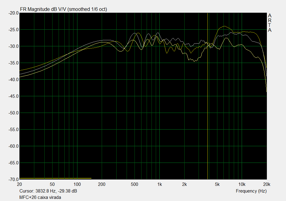

Some measurements with box upside down 😀 only to confirm the inversion of low/high vertical response (not noted in graph, but confirmed in practice)

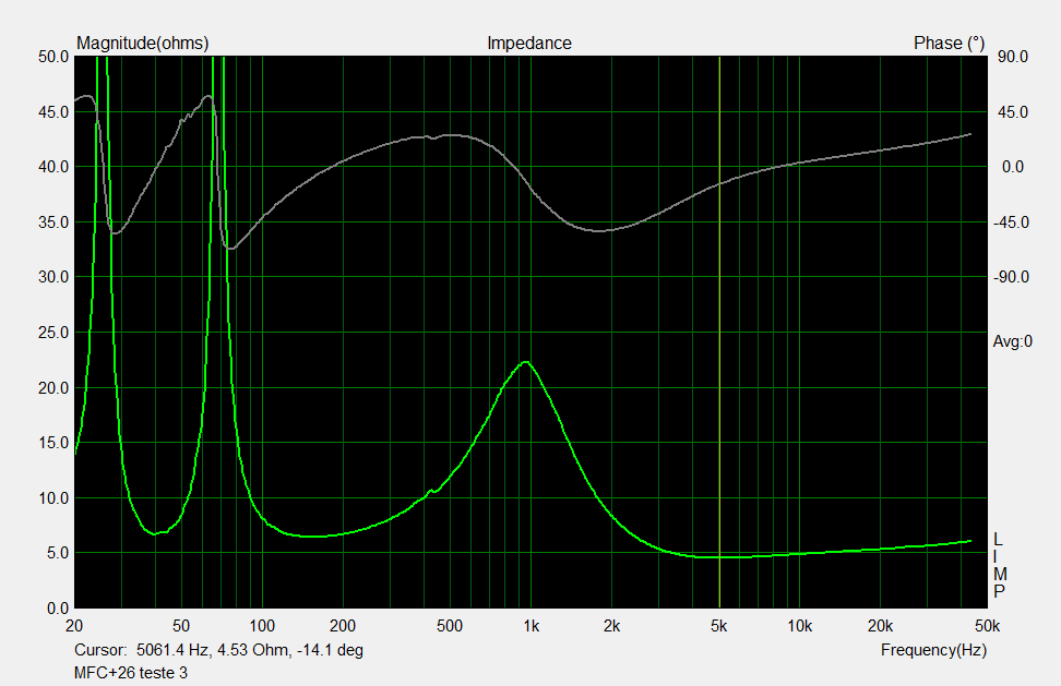

The resulting actual crossover Z, with some zoom. Note some glitch at near 400Hz; maybe need more stuffing

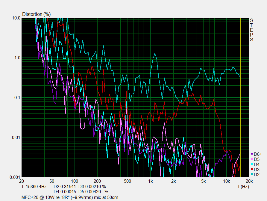

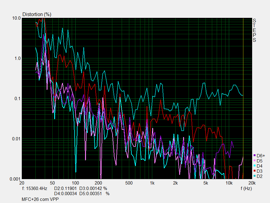

The HD stepping with 2.83V. For sure that SB distorts more than the Seas ER18 in bass department (now I need to find my ER18+DXT measurements...)

I've never liked second order with 6" bass. You can't get steep slopes on the bass, and so you hear breakup IMO.
I was looking at SB Acoustics EKA design, below. Add 18mm offset for time alignment, tweeter recess, by all accounts, which seems about what Troels and you did.
4 ohm NRX woofer: 6" SB17NRXC35-4 :: SB Acoustics
8 ohm bassier but less efficient MFC woofer with far less breakup: 6" SB17MFC35-8 :: SB Acoustics

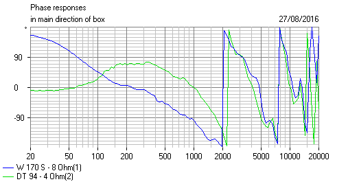

Anyway, it's the design that seems to line up phase nicely. It's third order in effect, but phase aligned. I like the look of it. Conversion to 8 ohm is just a question of adding 50% or so to coils and resistors, and reducing caps by a third. My own sim slightly disagreed, but I was using a higher inductance bass.
But what's not to like? 25dB down at 5kHz electrically, so no nasty breakups. Sort of thing I'd build and tune by ear. Tweeter level particularly. 10 ohms seems a lot! I'd suspect it could be smaller. But it's near enough the old KEF tweeter filter adjusted to 4 ohms.
So, IMO, this EKA filter is the right concept here. Just needs tuning. See with low inductance bass, you often add back some inductance and it then behaves like high inductance with second order to give you overall third order.
OOPS; ERRATA: the last graph are not the HD sweep. Here is it:Some measurements with box upside down 😀 only to confirm the inversion of low/high vertical response (not noted in graph, but confirmed in practice)
Is not bad; in fact, at this power level, the higher-order HD from midrange up is almost absent. And sounds smooth and "round". Comparing with some others measurements I have made, this is a good result. Even the ER18+DXT have more high order grunge than this (except in bass department).

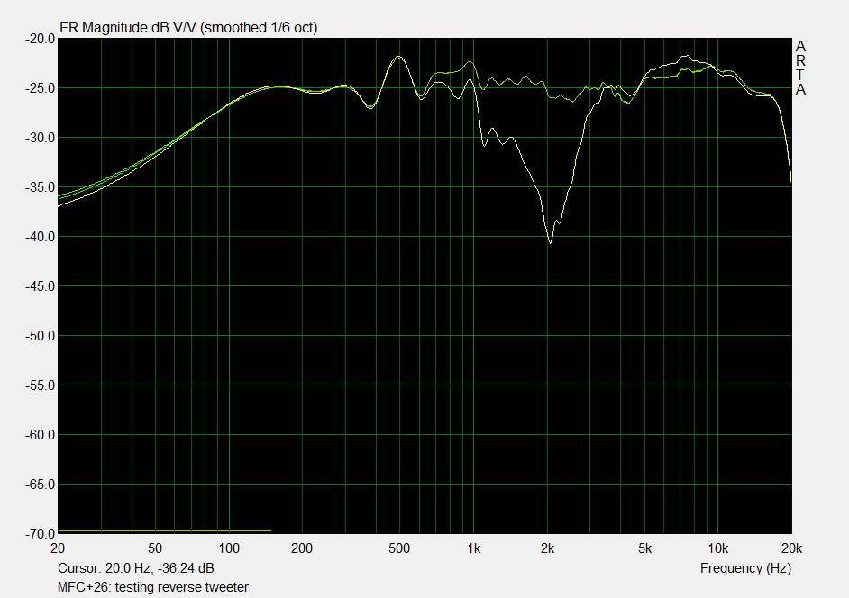

Now showing the reverse-polarity test for catch the null point. Maybe a point to be perfected.

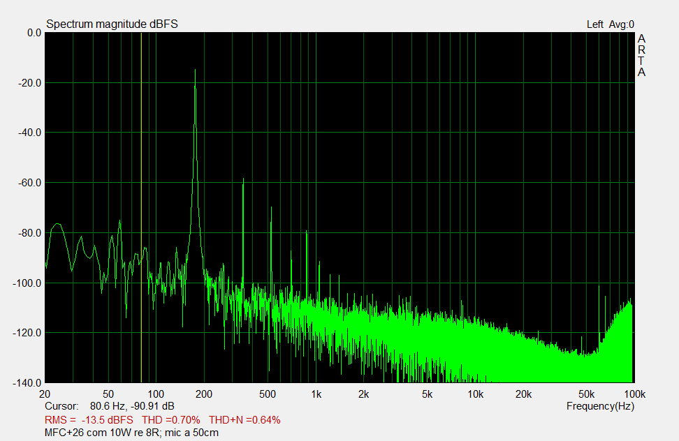

A FFT showing the HD content at some frequency (and shows the low frequency rumble from my living room)

A update...
For brave folks following 😀🙂
Since I've listened for various months, here is the "sober" evaluation. Starting with pros and cons, with comnparisions:
PROS:
**midrange+treble to die for... very neutral, very natural, detailed and not fatiging. In fact, is difficult do end the listening session.
**Low HD in midrange and treble area. Good response and fair-to-good dispersion (poor in one axis)
**Good in the "DDR" area, ie, in live recordings, is possible to liste the public even with musics playing, like a good headphone (but Stax eat it for breakfast)
**I liked very much this tweeter. I prefer it to various models costing much more.
Comparisions: is more detailed than JA-8008, but JA-8808 is a different animal with much more bass capability (make sure to read the CONS 😛)
Seems to be more musical, less fatiging and more "neutral" than MarkK project, but it can be my tastes 🙄
CONS:
**"strange" bass. What?! Well, the perceived bass response is good, but the HD is very high. Muddy sound if recording is bass heavy (intermodulation). Better to use it like a midbass... I've read in some site a Klippel result with a mere 1.9mm for a linear Xmax from suspension, so I can imagine this suspension optimized for midrange only...
In this regards, the SEAS ER18 is very better, rivalling some 8" in bass linearity!
**Need to use a notch filter is not very funny, but is easy in this driver.
**Low tweeter efficiency.
