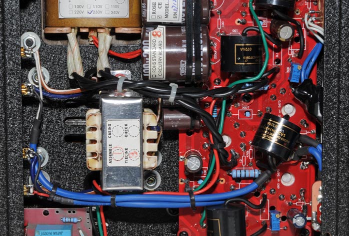

Yes you cann't go wrong that the price if you want something to modify and tweak.
With mine I changed the coupling caps but didn't really notice much change.
I then altered the driver valve connections to enable me to use the ECC*** range.More readilly available here in the UK and I've got a shed load of them.
This means cutting the PCB tracks and soldering some links.
I,ve not really come to any firm conclusions as to which ECC is best.
I also slightly lowered the feedback.
If your incoming mains voltage is high you might find heater voltages are a bit high.
I,ve tried various output valves ie. Mullard,TFK and Brimar thinkI can safely say that there is not a lot wrong with the suppied Sovteks.
I also have the Yarland FV 34A which is an SE design using 2 EL34's driven by 5670's.
With this amp I triode connected and removed feeback altogether
As the amp has fixed bias I can treak it within reason for a load of different octal fit valves. I've used 6L6,KT66,EL37,NR77 plus a few other obscure CV marked valves. It has a massive power TX and runs cool all day.
To be quite honest it sounds so good I won't be bothering to make any further changes and all this for £180 delivered.

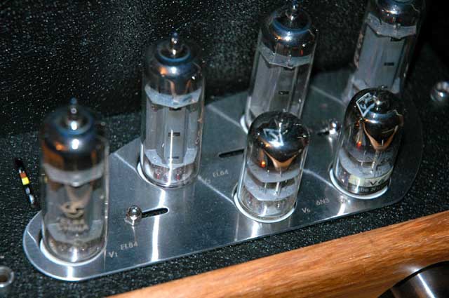

I also own a FV-34C III....mine has arrived with Shuguang EL84 tubes and not Sovteks....anyway, a very good sounding little amplifier....better than most solid state integrated at the same price....I found it to be very natural sounding...sweet, very detailed...very well integrated in my system with NAD C521BEE and B&W DM601 S3....
for Svein: I'm planning to change the Shuguang EL84 with JJ or TAD.....I'm assuming that no bias settings can be made....can you please describe the procedure to set the AC balance? Do I need to set those two little screws between the tubes? Any particular tools are needed to set that balance? Many thanks.
The AC balance of the paraphase phase splitter only need adjustment if you change the driver tubes.

I sell these amps with Shuguang EL84 tubes and Beijing 6N3 tubes. I tried JJ EL 84, this degraded the sound. The JJ's sound harsh in this amplifier. In other amplifiers the JJ tubes work pretty good. Just not in this one.

Svein,
Any chance you could post a pic of the inside showing where exactly to place the probes to measure the AC balance.
It looks like you found the caps; the big black cylinders across the PCB.
One side of each cap is connected to the driver anode with about 150V DC on it, the other end at the EL84 grid at 0V DC potential. You can measure the AC signal on either side of the caps.
Be sure to use a multimeter with a reasonably high input impedance (preferably 1 Mohm). If the impedance is low you will load the driver and measure lover voltage than the actual.
If you are not comfortable poking around inside the amp, adjustment is not critical if you use the same type tubes as before. A little AC unbalance only reduces the max power a little, and increases 2'nd harmonics which could be "ear-friendly".
