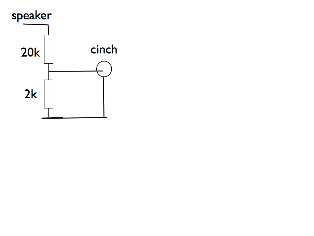

What I have done when I tweaked someone's Yaqin is take a tap off the speaker output. It has been amplified some 30 db, so you can make a divider. I did something like 20k/2k.
This then goes to one of the inputs that is unused. There you can link it with a cable. Best of course is do this in stereo. If you have one center bass only, then this needs to be summed.
It works satisfactory.

Since sub looks like it has a good active crossover, you want to stop the speaker powering your mains from working too hard trying to reproduce the low frequencies. I think active is best, but you can still reduce the low frequencies getting to the main amp with a simple capacitor/resistor network at the input of the main amp.
alberti, could you give me a drawing of that please? Helps clarify teh words for me 🙂
Here it goes. The drawing is not very nice as I now use Keynote which is not user friendly for this task.
It is just a few parts.
The cinch is of course not connected to the input selector anymore. That could send electrons round and round, aka oscillation! 😱
alberti

Why would you want to do a setup like this? It will exacerbate any problem that the tube amp has powering low frequencies and will increase the noise to the sub. The best situation is to stop the lows getting to the tube amp to start with. An active filter will do this. Since he has such a filter on the sub, the full signal can be sent from the pre to the sub. You now want the signal from the pre to the tube amp to have the base taken away so that you are not wasting precious headroom in that amp trying to reproduce frequencies being processed by the sub. You can do this with an active high pass filter, but this will take a few opamps and another power supply. If this is seen as too complex, a simpler method would be to place a simple capacitor/resistor network at the input of the tube amp. Since the first stage of the tube amp will have a grid leak resistor, a simple capacitor in series with the input may be all that is required. See this site for a frequency calculator Guitar Pedals: R-C Filter Calculator
You are quite right that a pre-out is preferable.
But the YQ-MC5881 I worked on has no separate pre-aplifier stage. The Yaqin has an amplification factor of more than 40 dB (5k1 over 47 ohm). This is good for connecting an MP3 player like an iPod. But for normal use this is not OK.
And there is no point to take out the signal. That is why I devised this little tick. (It is the same way active speakers from Philips also were configured in the seventies and later: they had both a DIN input plug and a speaker-out input plug.)

Maybe I am confused. I thought the original question was how to use the two sets of pre-out on a Yaqin MS-12B pre-amp and how to best send that signal to his Meng X1 Amp and active sub. From his description there are two outputs on the pre-amp, a .25V output and a .7V output. Are you saying that the pre-out amplifies the signal too much to be useful? I would try the .25V output for the sub and see how well it integrates. If the signal level is too high for the sub, I would then look at padding it down.
Apologize! I should retract my posts. I was thinking of a different Yaqin equipment. Should have double checked.😱
