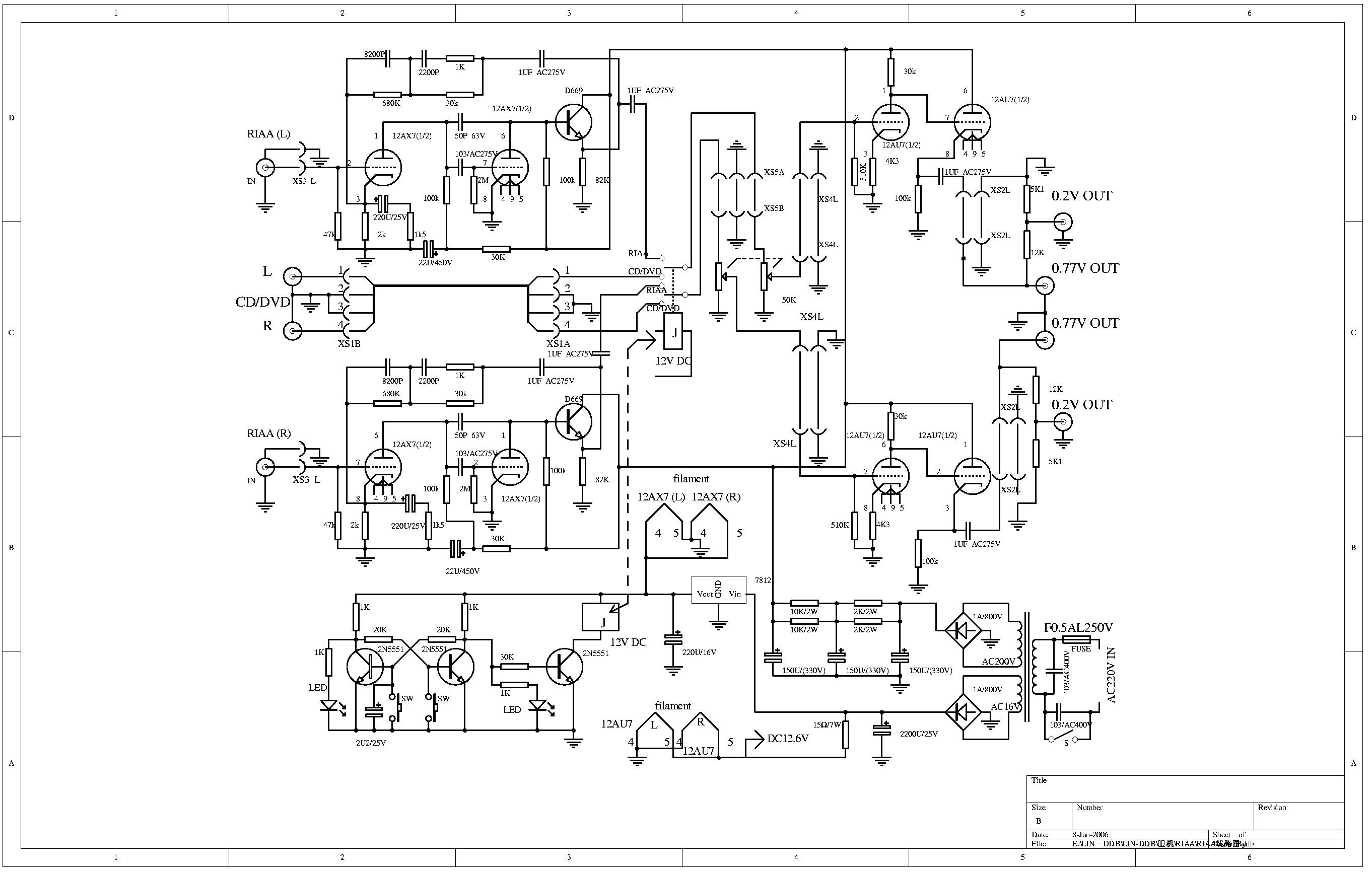

I have acouple of other ideas for this phono preamp. If anyone has suggestions, That would be wonderful. Below is what I plan to Mod if I can or if it makes a difference.
Here is the schematic for the MS12B. I have one, but the sounds is a little bit too muddy and mushy for my taste (compared to a Pro-ject Tubebox I had and an Aikido phono amp I currently use), I didn't try to modify it, other than changing the stock tubes to NOS.
Thank you so much. Well for me its all about learning and venturing to the unknown. Great Hobby...I'm having great fun reading about mods with Capacitors, resistors etc..etc.. I used to be a generator Tech for the Army some 20 years ago and used to read schematics like nothing. I was great at it and Its all coming back slowing, very slowly..lol.. this is my first Phono preamp but I'm sure it won't be my last. I'm sure there are way better phono preamps out there for less.. Cheers and thank you again!!

Hi Everyone,
Back again. This phono amp is sounding sweeter and sweeter. I guess it takes time for those Caps to break in. I'm amazed on how the sounds changes when using different tubes. Thanks to Audiotux for helping me with that risistor. I can listen to vinyl for hours and the chassis is nice and cool... I have pairs of 12ax7 and 12au7 tubes coming in next week. Which comes to my second question. GRID STOPPERS. I'm getting slight oscillation "only" in certain tubes on the output. Looking at the schematic that TOUFU kindly put up. Should I also add Grid stoppers to the 12ax7? if so, I figured that 1k carbon Comp Resistors should be soldered directly on pins 2 and 7. Pin 2 (L) Pins 7 (R) goes to the input and pin 7(L) Pin 2(R) goes after the 2M resistor? after would be closer to ground or at the 2m symbol? Do I need to cut the circuit on the pcb? Pin 2 and 7 on the output (12au7) is where I get totally lost. Usually pin 2 and 7 are soldered to a 470k type resistor?
Danke, Thanks
Danke, Thanks
Hi Migkiller ,
nice that you enjoy your vinyl !
i am not a tube guy , but as i understand the schematic ,
that 2 Megaohm is the Grid-Thingie .
So check the tubes or maybe a 2M carbon will help you out .

To tell you the truth I'm not really worried about the 12ax7 (would Be nice) but I really need to put grid stoppers on the 12au7. I get slight oscillation when I used my Ribbed Telefunken 12au7 (which I love) but none with the Cheap Chinese, or the Jan phillips or the a pair of baldwins which I don't like. I have some NOS RCA Clear top coming in. Looking at the schematics, I think I have to cut the pcb track to the grid. I also know that these grid stoppers should be put after the grid-to-ground resistor.
