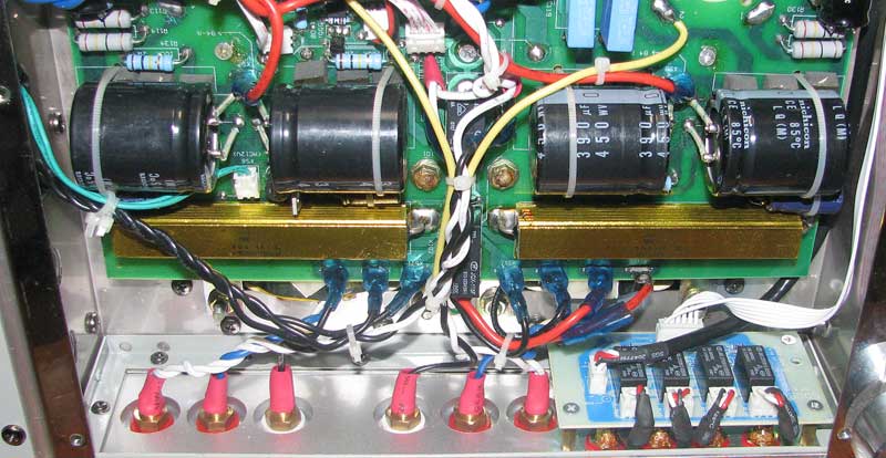

I bought one six months ago. Everything was find until last monday, a big white smoke came from underneath the ampli and a lot of blue sparks in the head of the 274B. After removing some screws I can tell that 2 caps of 10uF under 450v are gone. Is anybody else have had this problem yet?

There is a 50 Ohms/50 Watt resistor and a 100KOhms resistor on parallel of each 10uF/450V Caps.
What happens on the GF version of this amp, is that the metal clad resistors -- not being heat sinked -- get REALLY hot, and prematurly expire -- so far everytime by spraying their guts all over the inside of the amplifier.
We have been mounting better quality 25w metal clads to the bottom plate & replacing the caps. This is best done before the caps go.

GF = Grant Fidelity.
Does your amp look like the attached?
We replaced the 100w (not heatsinked) Rs with 25W ones (heatsinked to the bottom panel).

Your amp is a bit different Schema wize, althou the topology is the same, so it is possible layout is the same. I don't know for sure which caps they are in the schema... i do know the physical location, and it would have helped if i had attached the picture i intended.
