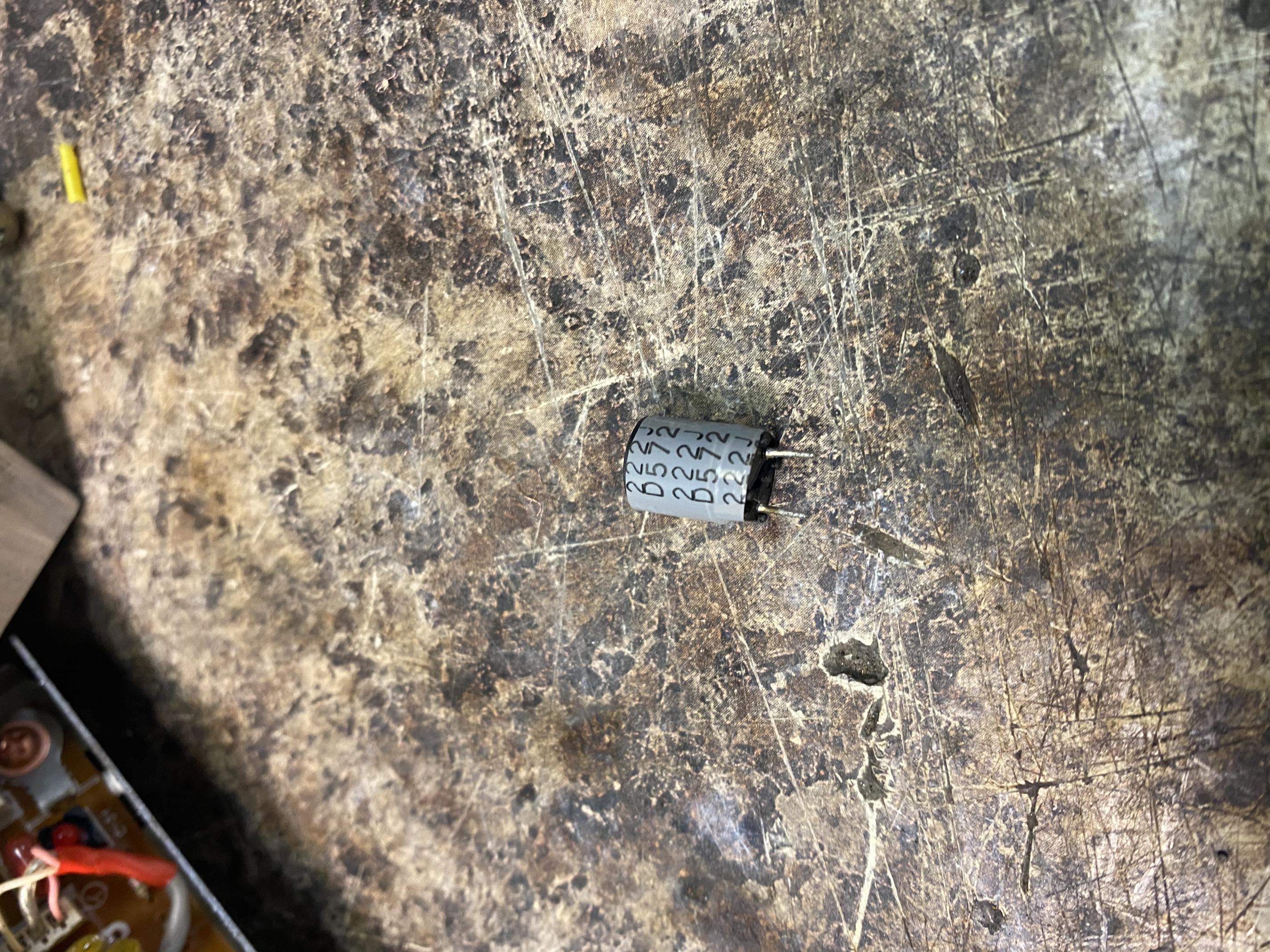

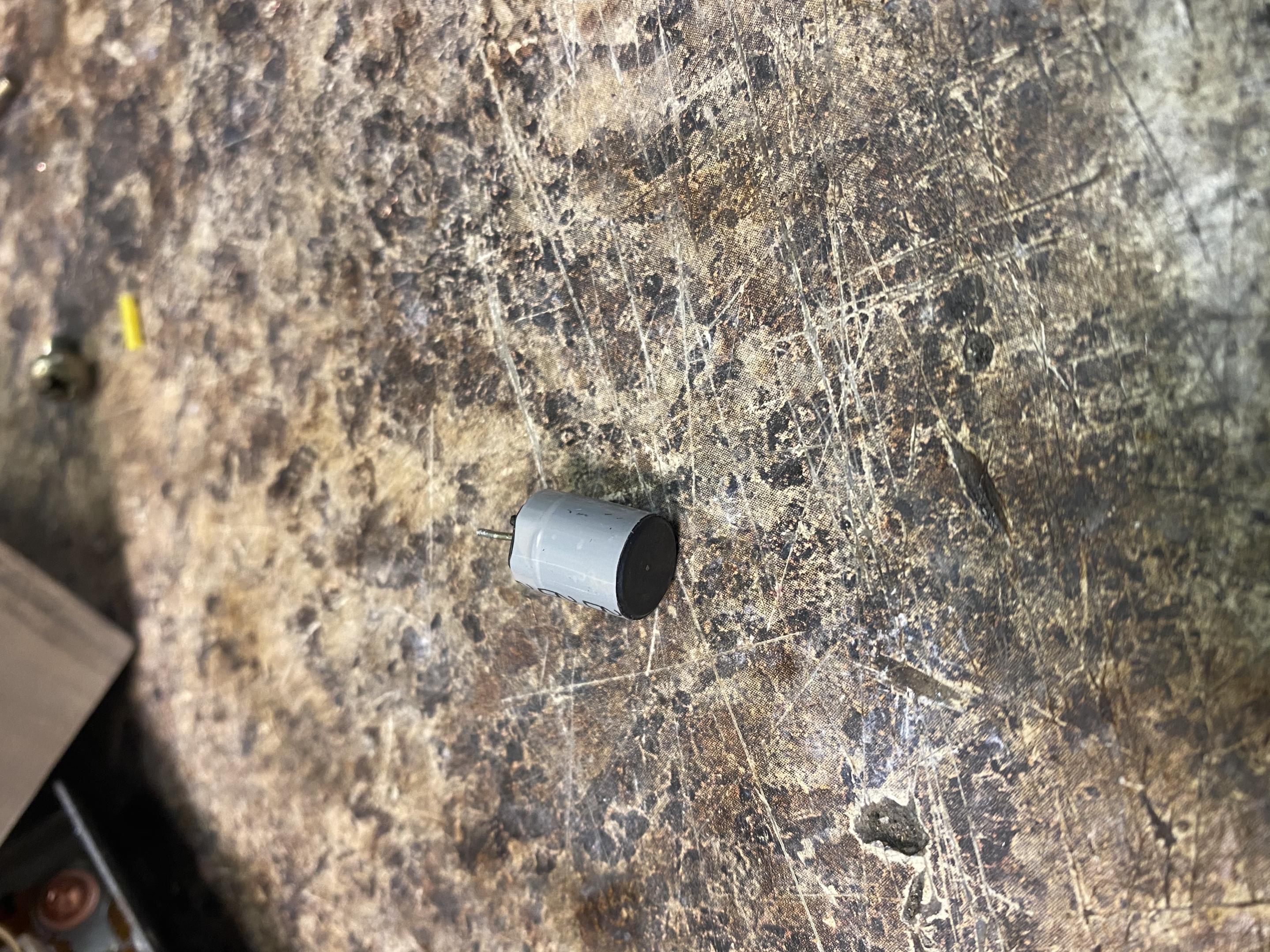

That's an inductor and should read approximately a dead short.
