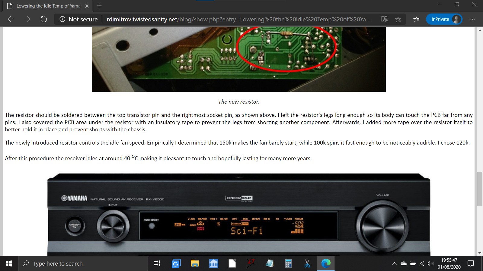

Hi
I bought a used RX-V2500 and wanted the fan to be acrive sooner, before the amp becomes too hot, a few years ago I read an article of a guy who put in a resistor, that makes the fan coming in quicker, but I can not find the link any more, if you give it in in Google search, you are being directed to a weird website, nothing to do with this article, has anyone saved it by chance?

The fan is fed from pin 4 of IC501. IC501 senses the temperature and there is no change of resistor to be done. It is written into the chips programme.

Hi
Thanks, that was the article I was looking for,
Will use it in multichannel (8) mode for my diy active 3 way speakersetup, using a Najda digital crossover, it will be my second setup, alraedy got a setup like this one going for several years now, really good! 6 poweramps and the volume control used in the Yamaha, can not go any cheaper, when going active, paid 90 dollars for the (very good) Yamaha
