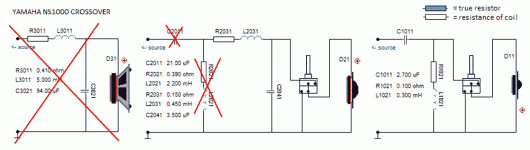

Very careful selection of bass driver(s) will be needed to minimize any mods to the XO, the high pass of the woofer will likely need tweaking no matter what you do.
Maybe easiest — much greater woofer selection opens up — just to bi-amp and just use the mid HP & tweeter LP part of the existing XO. A whole slew of PassDIY active XOs are about to hit the diyAudio store which makes active speakers even more appealing than they already are.

Mirror imaged NS-1000.
dave
… just use the mid HP & tweeter LP part of the existing XO.
Forgot to attach what that should look like.
dave
