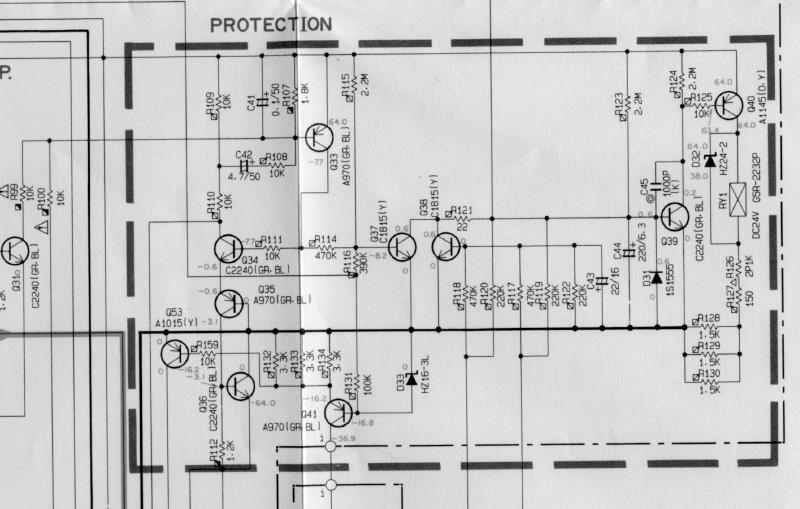

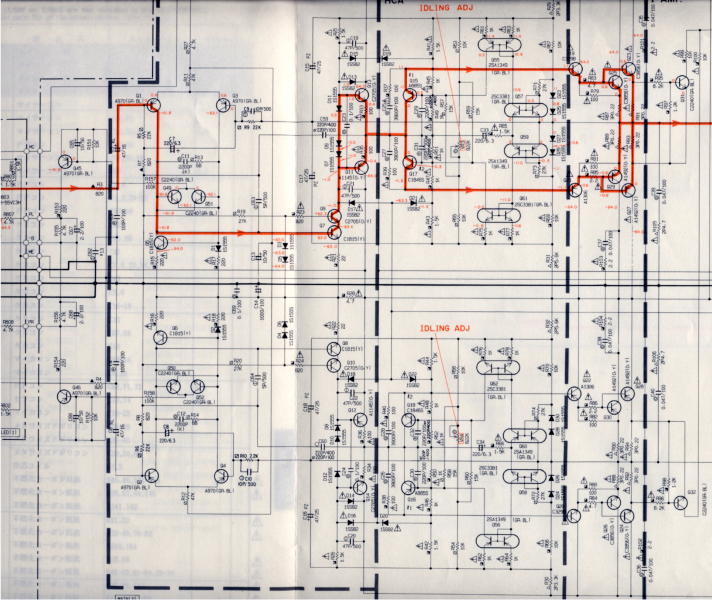

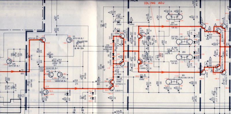

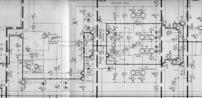

succesfull repair
I would like to inform you all, especially thanks to Peter Daniel, that the amplifier has been restored to its previous condition.
It had taken me two days in a span of two weeks to get it fixed.
Downloading transistor data and finding replacements with the correct specifications also took a long time.
Those Japs ( my wife is one! ) discontinue stuff like rabbits !
It was obvious for me to replace the output transistors and drivers but I almost could not believe I had to replace all semiconductors in the soundstage and the protection circuit as well.
The PCB has more wire bridges than components on it.
As you can see from the schematics there are no active current sources at all.
Not for the diff input and not for the VAS. And on top of everything there is no bootstrapping (common when there are no active current sources like aksa, P3a).
The schematic is also overwhelmed by compansation caps.
The amp can produce good bass because the input capacitor and the feedback capacitor (both poor quality electrolytics!) are huge compared to there resistive loading.
The rest of the sound is poor to my ears. There is a hole in the mid's and the highs are made of plastic.
Tiny heatsinks as well.
Must have been a panic product from Yamaha.
The conclusion is that I have managed to repair this mediocre equipment cheaply and made a friend very happy again. The cost was about 70 euro's.
By the way he has Tannoy defenition D900's , lucky ducky.
No money to let me make a real amplifier for him.
