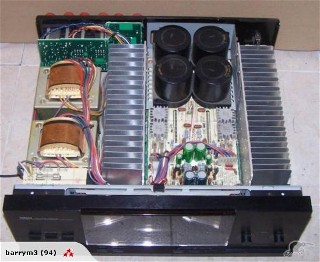

Have a MX-1000 that is always in protection mode. Haven't opened yet since I don't have a service manual, schematic, or even an owners manual.
Anyone have any of these or any suggestions?

The first thing I would check is for shorted rails ie. output transistors. I dont have a schematic for a MX-1000 I do have one for a M-4 & M-45. MX series is much newer probably changed quite a bit. If no obvious shorted output transistors then possibly a power supply problem or even a problem with the protect circuit itself .Some would even say"Tap on the relay". Just if you should choose to tap on the relay dont have the amp hooked-up to your favorite set of speakers!Lookover the amp for other obvious causes such as swelled up or split-open capacitors , burnt or broken resistors etc.🙂

Thanks! One of the rails has very low voltage. I measures 90V and 50V on different ones, and one has only 2-3 V. Also found a a dark spot under a transistor attached to the middle of the right channel heatsink between the banks of the larger output transistors. Not sure if it was soldering heat or a damaged trany. Any recommendations on the best way to check a transistor?
I hope I don't need to disassemble the whole thing to get to some of the connections and soldered surfaces. The MX-1000 has two layers of boards with a connection in between that I'm not sure I want to tackle unless someone knows how they come apart easily.

Check the outputs with your VOM set to the HFE setting should get base to collector- emitter ranges of 450 to 650 or close, check for dead shorts or opens on all output dissconected from circuit.
Probably there will be more wrong then just the outputs, the circuit topology has not strayed much from the original M series.
Shorted outputs like to open the emmiter resistors, also check the Drive trannys and pre- drive they will go by by with the outputs.
The circuit can be a little hard to track, but on the lower PC board you will find a row of resistors and diodes for both channels right to left, check the diodes for foward conduction, by the way 4 of them will be zener diodes they also like to let loose when the outputs go.

Well the most accurate way to check transistors is out of circuit or isolated from the circuit and to check for emitter to base,base to collector and emitter to collector shorts . A in circuit check for a shorted power rail would be to measure the continuity between the collectors on both of the channels and the central or star ground. All this will tell you is either + or - rail(s) on a given channel is shorted or not ie. through a output transistor but that gets us right back to transistor isolation. Really no easy way to do it. Other than paying someone else to do it. LOL
