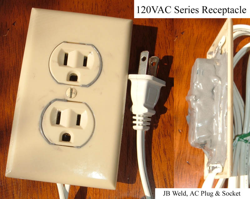

One last question about the light bulb: the amp will not fire up
if the light bulb is to low of wattage. . . so it is safe to start with
a low wattage bulb (40 watts) and then increase the bulb wattage
until the amp fires up?
I made a cable assembly that has a plug at one end and two
sockets at the other end: the two sockets are in series so one
can accept a light bulb fixture, while the other will accept the
amplifier plug. Took me 30 minutes and with parts in the parts
box!
I will make sure I order new insulators and get new heat sink
compound (old tube is about 12 years old. . . ).
With Mica insulators is there more caution with how tight the
mounting screws(since they tend to be brittle)?
box!
Buy a $0.99 two-wire extension cord.
Buy a $0.99 lampholder.
Cut one wire on the cord. Attach those two ends to the lampholder. Screw in a 75W bulb.
Anything plugged into the extension cord will now have the lightbulb in series with it.
I'll upload a picture of what I made. . . I wanted something that
was simple, but very specific for the task. . .

The bulb test... yes start off with say a 40 watt and if it doesn't lite then move up in bulb wattages. If the bulb stays lit you have a power supply short.
I guess a good question to state now is:
What are the states that the light bulb will be in when testing
an amplifier (and what do they mean?)?
Bulb doesn't light: amp isn't completing the circuit due to a blown
fuse or bad connection (make sure the bulb actually works!).
Bulb glows steady and amp works: both are getting some percentage less than 120VAC but sufficient to operate.
Bulb burns at full brightness and amp doesn't work: short in the power supply (bigred).
There must be more like:
glows bright then dims
Pulses
glows dim then brightens
I think a full list would be very helpful (not only to me) but
anybody that has or will run into amplifier problems and needs
to perform the light bulb test.
I will try a test on my working M-45 so I have a baseline for a
light bulb response.
Pulses
Light Bulb Test Circuit: 25wpc single chip amplifier
25W light bulb (208mA at 576ohms hot, 48ohms cold)
(1) Turn On = Very Bright then dims quickly
(2) Amp stable and output relays latch = very soft glow.
(3) Loud music = Bright and pulses (lags in brightness behind peaks).
The amp has a 4amp fast blow fuse in it (Accurian Mod found in the
DIY Audio thread).
Hint: A clear bulb is easier to see the faint glow.
70W light bulb (583mA at 260ohms hot, 14ohms cold)
(1) Turn On = Medium Glow, then no glow
(2) Amp stable and output relays latch = no glow
(3) Loud music = medium glow with slight pulsing not as strong as
the 25W bulb.
Will test with Rotel RB850 Saturday after replacing Bias circuit. . .
in another thread at DIY Audio. . .
DIY Audio thread).
the 25W bulb.
Bright bulb = normal current for bulb = current in circuit
but voltage less than 120VAC at amplifier.
Working M-45 and bias set to about 16mV to 17mV
95.1 VAC CT
93.5 VAC CT Class A
25W light bulb. . .never turned on.
(1) Turn On = Bright glow for about 10 seconds.
Then protection circuit turned off.
(2) Steady running = Medium glow. . .filament visible through white.
(3) Bias down to 9mV
70VAC CT
Switch to Class A
(1) Bulb goes bright, but less than turn on bright for 3 seconds.
(2) bulb medium glow, but brighter than idle in AB mode.
61 VAC CT
95.1 VAC CT
93.5 VAC CT Class A
70VAC CT
Switch to Class A
61 VAC CT
