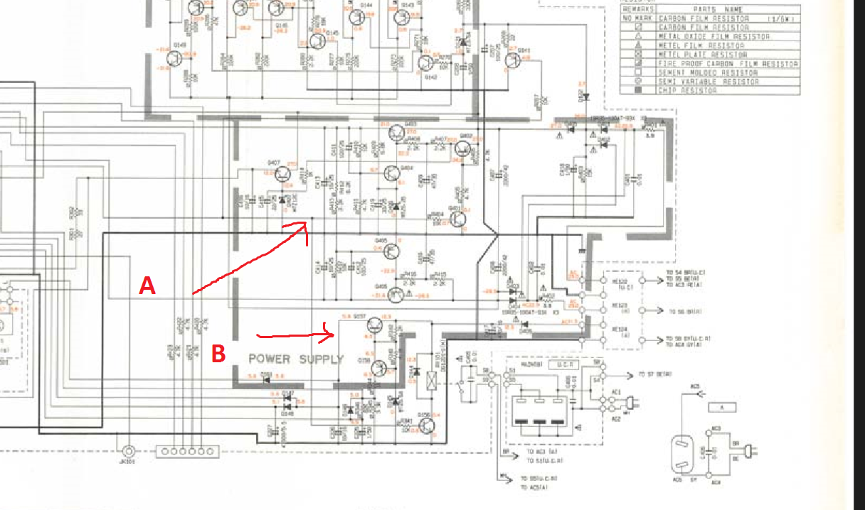

Do you have a circuit for this preamp ? A few basic voltage checks would help locate the problem.

If you can come up with a circuit diagram then there is a real chance of fixing it. Common problems could be something as simple as a poor joint on a regulator transistor or IC. It happens all the time on commercial stuff.

You need to check the basics first which is all the supply voltages. Can you report back with the voltages on point A and point B. Be extremely careful measuring, particularly around that transistor. One slip of the meter lead between the pins could result in major damage. It is best to find a convenient point it goes to and measure there.
When you switch on, do you hear a relay click ?

From the symptoms I would guess that at least one of the small-fry electrolytics in the regulator or the relay driver circuit is leaky and shorting out at power-up until the dielectric has recovered. Looking at the various voltages should clear that up. I see only a handful of such caps anyway. I would replace with good quality parts of same capacity and about the same physical dimensions (which should mean a voltage rating that's a step higher or two).
If the big ones were bad, there would be issues like hum, or the fuse would burn out.
