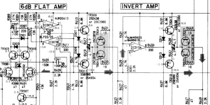

Does the headphone output also fade?
The headphone amp bypasses the "invert amp" so if the headphone out is good then the problem is most likely with the "invert amp"
I'd first suspect the mute transistors, I have shadowed them in the attached pic.
