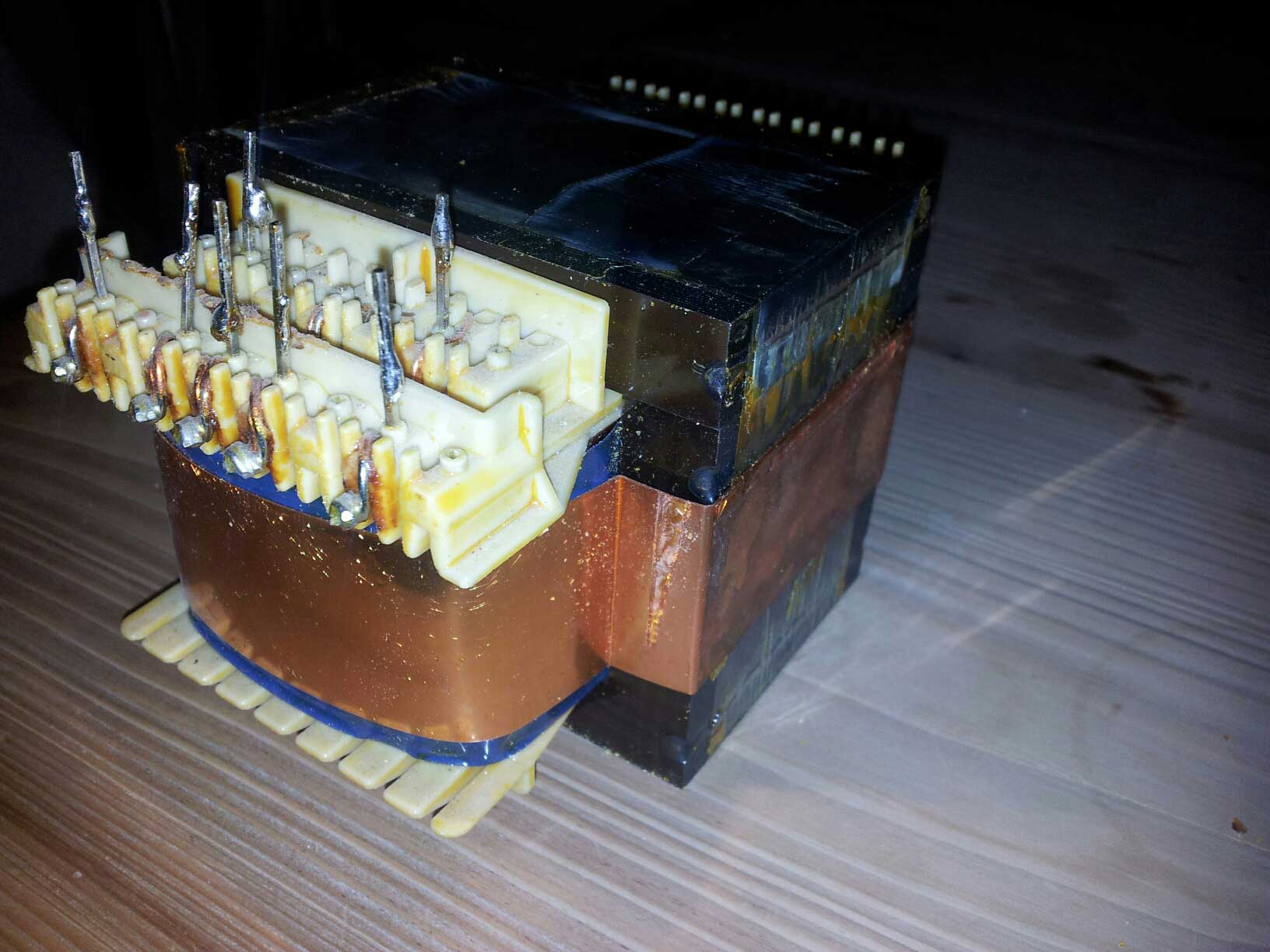

Hey guys, Thanks for all your replies!
Pulled the transformer out (see photo's), no continuity on the primary side however secondary's were fine as predicted!
Started pulling it apart and am at the point now as shown in the photo...
Do I have to fully delaminate the core to gain access? Is there any (easy) way of doing this? It seems the laminates are strip welded together so I could get the grinder out....
I'll look for a replacement regardless, I just wouldn't mind taking it apart at checking this fuse for my own curiosity!

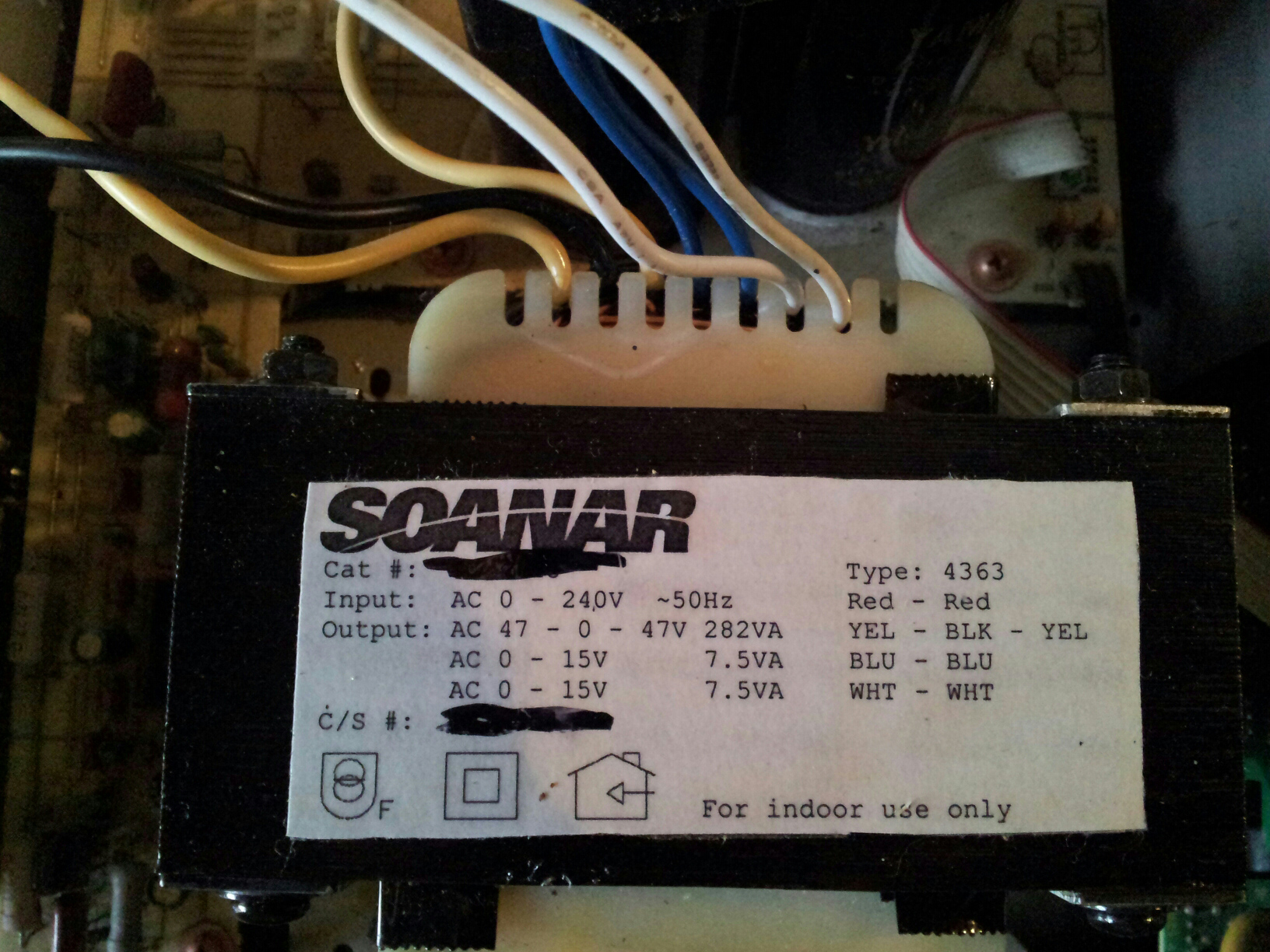

Ian - I've been looking around and have sourced some Toroids. However, I did stumble across this EI. Transformer 47-0-47 3A Centre Tapped 2 x 15 500mA - Jaycar Electronics.
Would this suit? If I use the centre tap to get 2x47v and the two 15v? Slight different voltage from specified however not too bad?
I can't find any current ratings on my amp/in the manual I found online and there seems to be little info about this unit. Apparently it's 110w/channel@8 ohm so would this 300VA transformer be suffice? My quick mathematics say yes however being such a newbie to Amps I need an expert!
Thanks again for all your inputs!
Felix.
Yes, that's the unit, but it seems less current than I recall and probably not enough for the amplifier on any but 8R loads. As a stopgap replacement, it would be acceptable, provided you didn't try to run the amplifier into low impedance (<6R) speakers or invite the gang around and party with it, as someone always tries out what volume knobs can do to get attention.
The other concern is how much current is needed for the low voltage secondaries. If they are only used to supply the control circuits, relay and the preamp at no more than 15V, no problem. (look at the size/rating of the smaller rectifier bridge or diodes.)
A crude but effective comparison is to compare weight but whaddayaknow, a heavy item and Jaycar don't state shipping weight even! 'Pity, but I think it will be a bit anaemic in the role. 47VAC suggests about 65V rails and 130W/8R, so I think a bit more current, around 5A, would be more appropriate for 4R loads. That gets expensive.

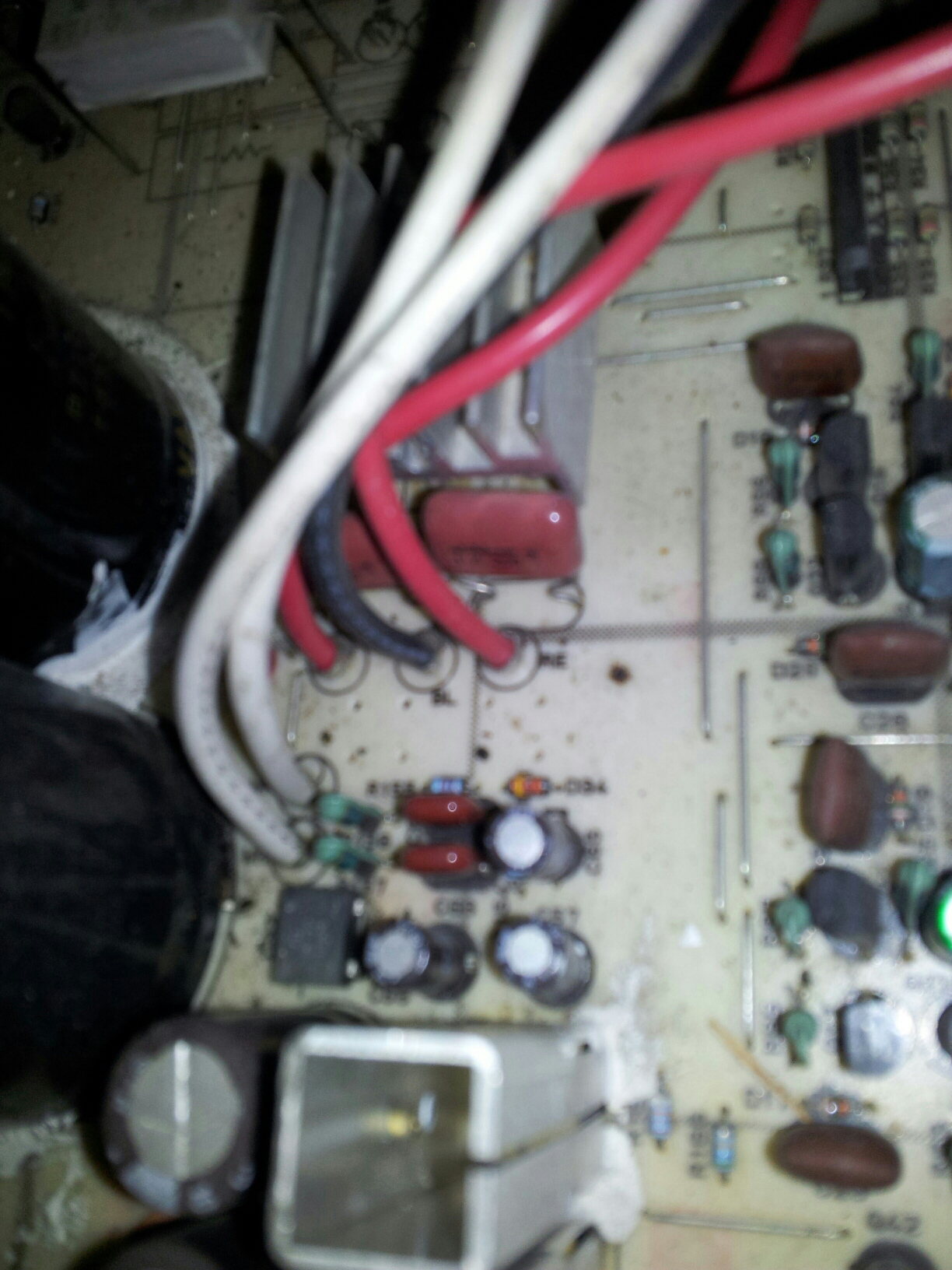

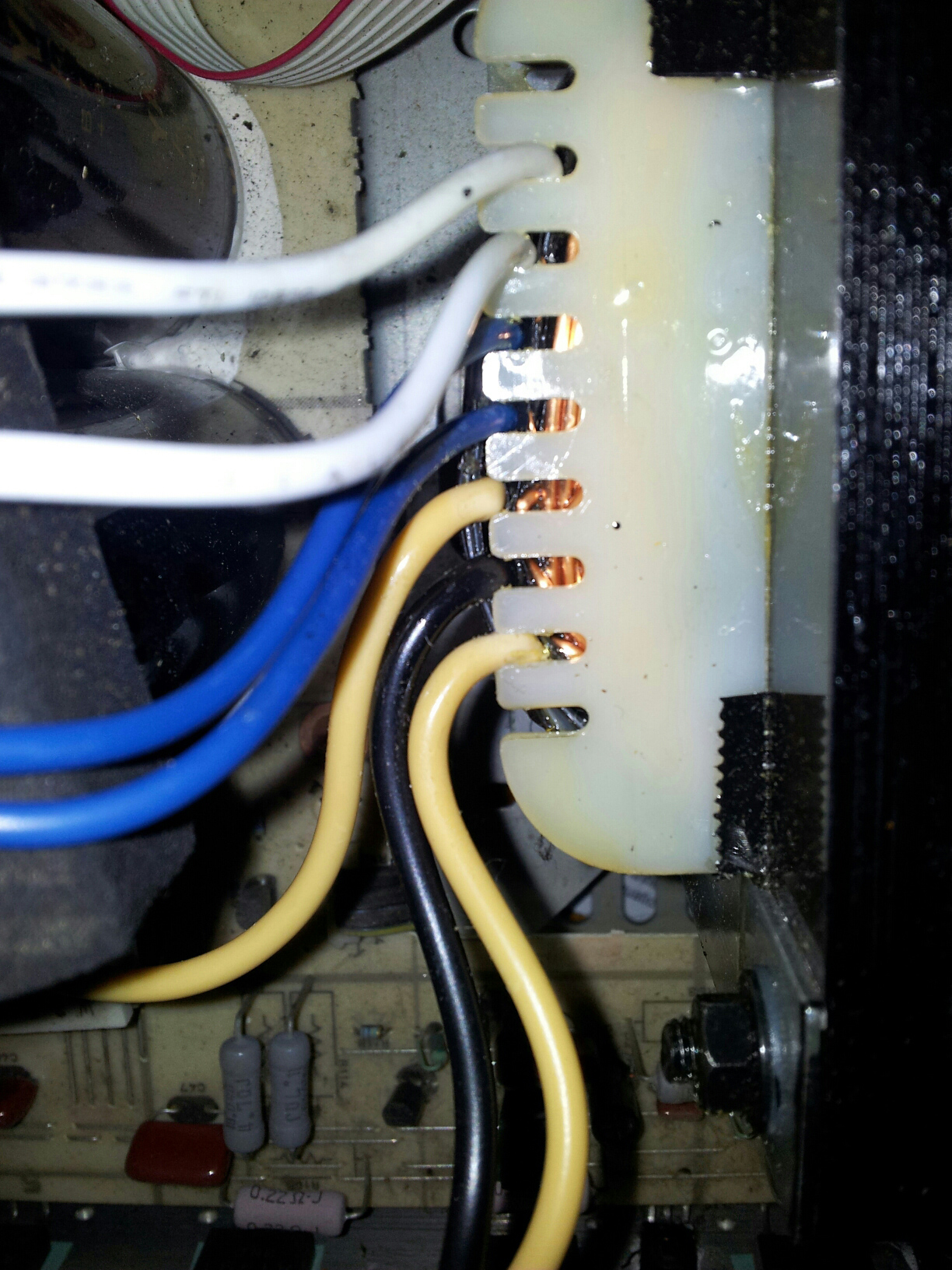

Hi again,
Went into Jaycar today and inspected the transformer, decided it looked of reasonable build quality so I purchased it.
Got all excited and screwed it in and now have a slight problem.
With the 15v secondary's (in the pictures the blue and white wires) there are two of them. With the previous transformer there was only the white. So, assuming each is its own 15v, does this mean my amp only takes one of the sets of wires (requiring 1x15v for the preamp) and leaving the other ones not connected.
Or, would it need 2x15v meaning 1 blue and 1 white going into the PCB and other 2 tied to the 0v (black) of the other secondary?
I'm not sure how the old transformer was wired, maybe these other two were tied to the 0v line internally, or maybe this new transformer has a another 15v line that I just won't be using?
Does that make sense? I guess summing up is would my preamp need 2 15v supplies or just one? Maybe i'm over thinking it....
I don't want to blow anything up 😀
Felix.

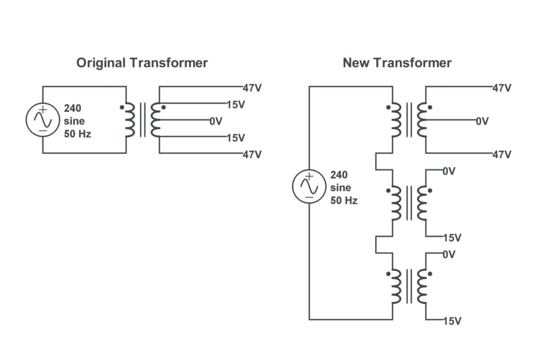

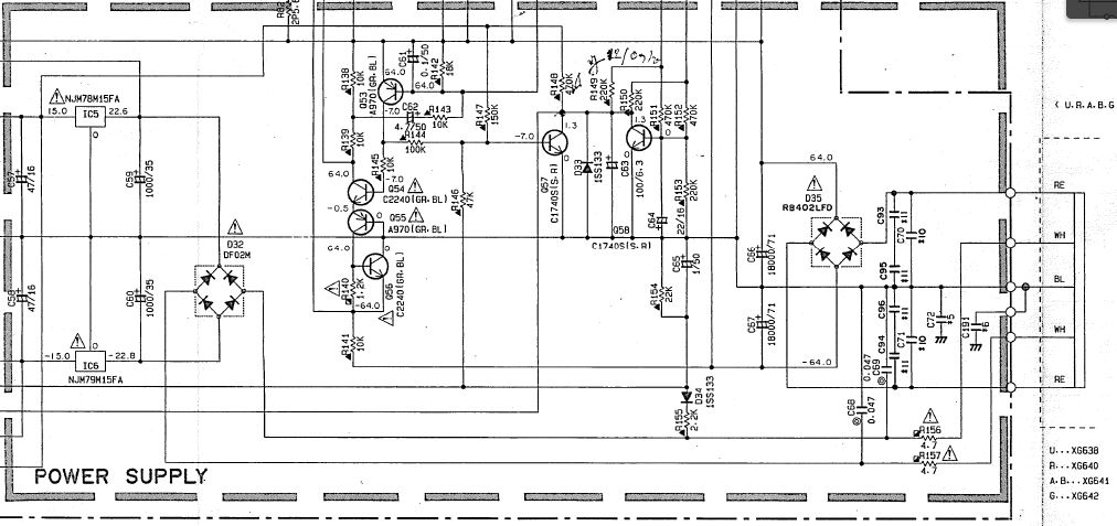

Got it all back out again today and for something that should be relatively simple I can't quite get my head around it.
After doing some continuity checks with my multimeter this attached diagram is what I suspect is happening. I've also attached the circuit diagram for the power supply into the amp. It seems the two 15v lines are both going into a full wave dc rectifier then into some voltage regulator IC's. Once I get this connection from the transformer sorted I should be able to test it from there...
So, Should I be fine to tie the 0V lines together (Forming effectively a 47-15-0-15-47 as the original transformer) provided I pick the right phase wires?
Felix

Not the two 0V.
The 0V and 15V between the 15V windings should be connected together and to GND, and ultimately together with the centertap on the two 47V windings.
Then the two 47V ends to the rectifier to the right, and the two remaining 15V ends to the fuses in front of the rectifier to the left.
The original transformer seems to have 2X15V + 2 32V windings on each end of the 2X15V. Funny arrangement.
To take it lead for lead on the transformer at the left in your post:
47V to the point ending at the top of C93 (Right side of the rectifier to the right)
0V to the point ending at the bottom of C95
47V to the point ending at the bottom of C94 (Left side of the rectifier to the right)
15V to the point ending in FuseResistor R156
15V to the point ending at the bottom of C95
0V to the point ending at the Fuseresistor R157
All this providing that the manufactorer of the transformer has provided a drawing one can trust.
