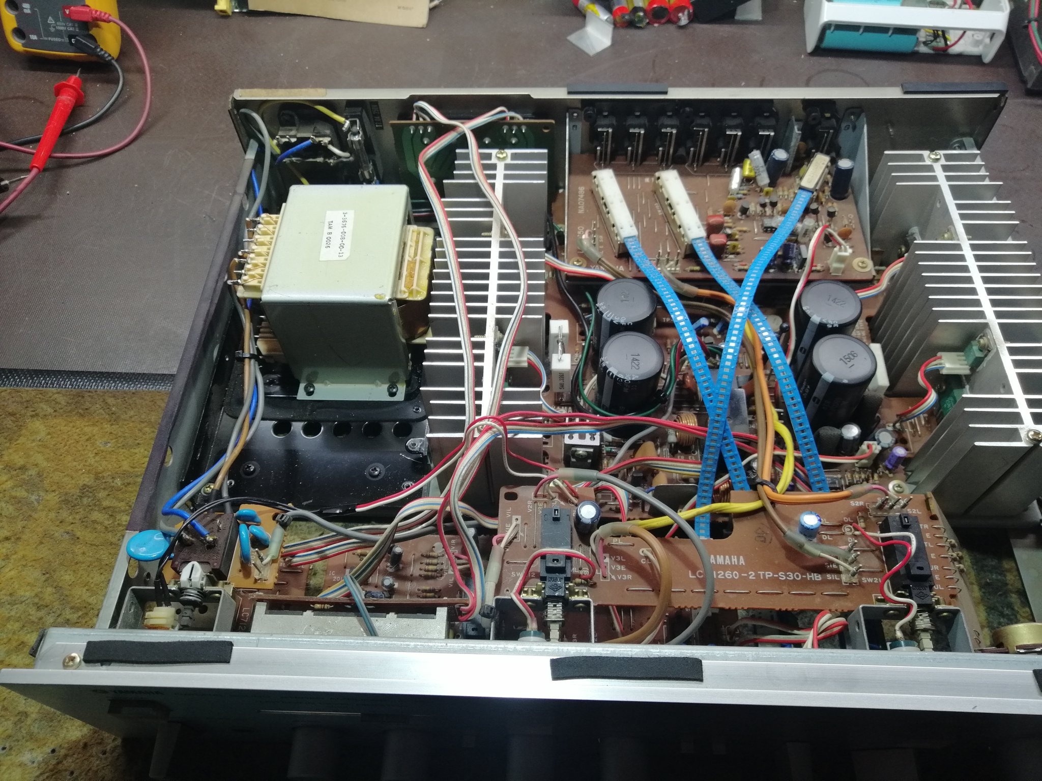

Hallo madis64, no thank you I've got it sorted. The one winding in the the transformer of the Yamaha a-760 were damaged, I took it out and put in another transformer without the power control board, works fine now. 😉

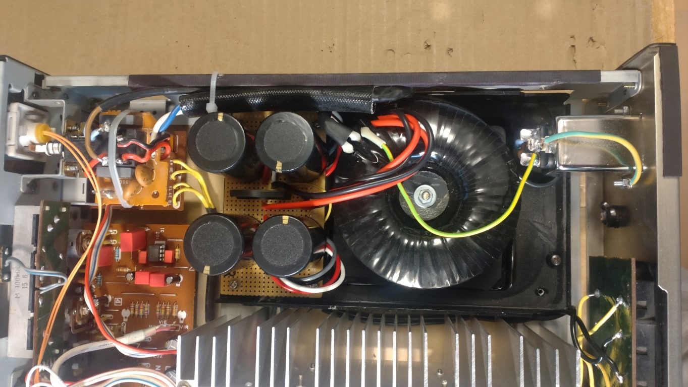

I also replaced the (fully functional) PSU on my 760 because I did not like what I saw in the measurement results (noise and THD wise).
So I ordered a custom toroid transformer to get 50V DC and also moved the rectifier and power supply capacitors from the main board to the PSU section (like e.g.in A-700):

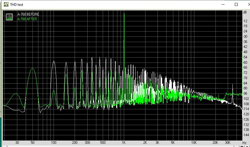

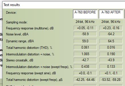

Measurement results before and after show improvement both in noise and THD. THD improvement I would attribute to removal of the "cycle-interrupted" power supply rails, 100 Hz noise reduction should come from the rectifier and power supply caps location and wiring changes.
