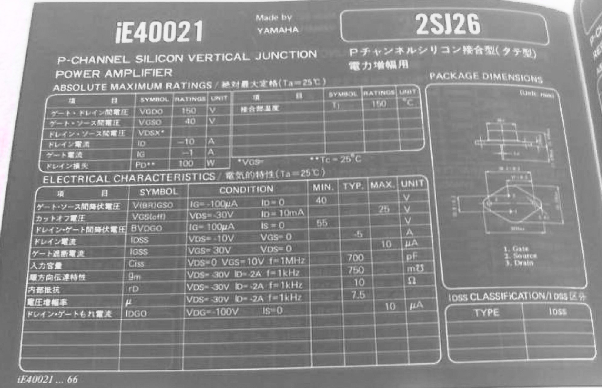

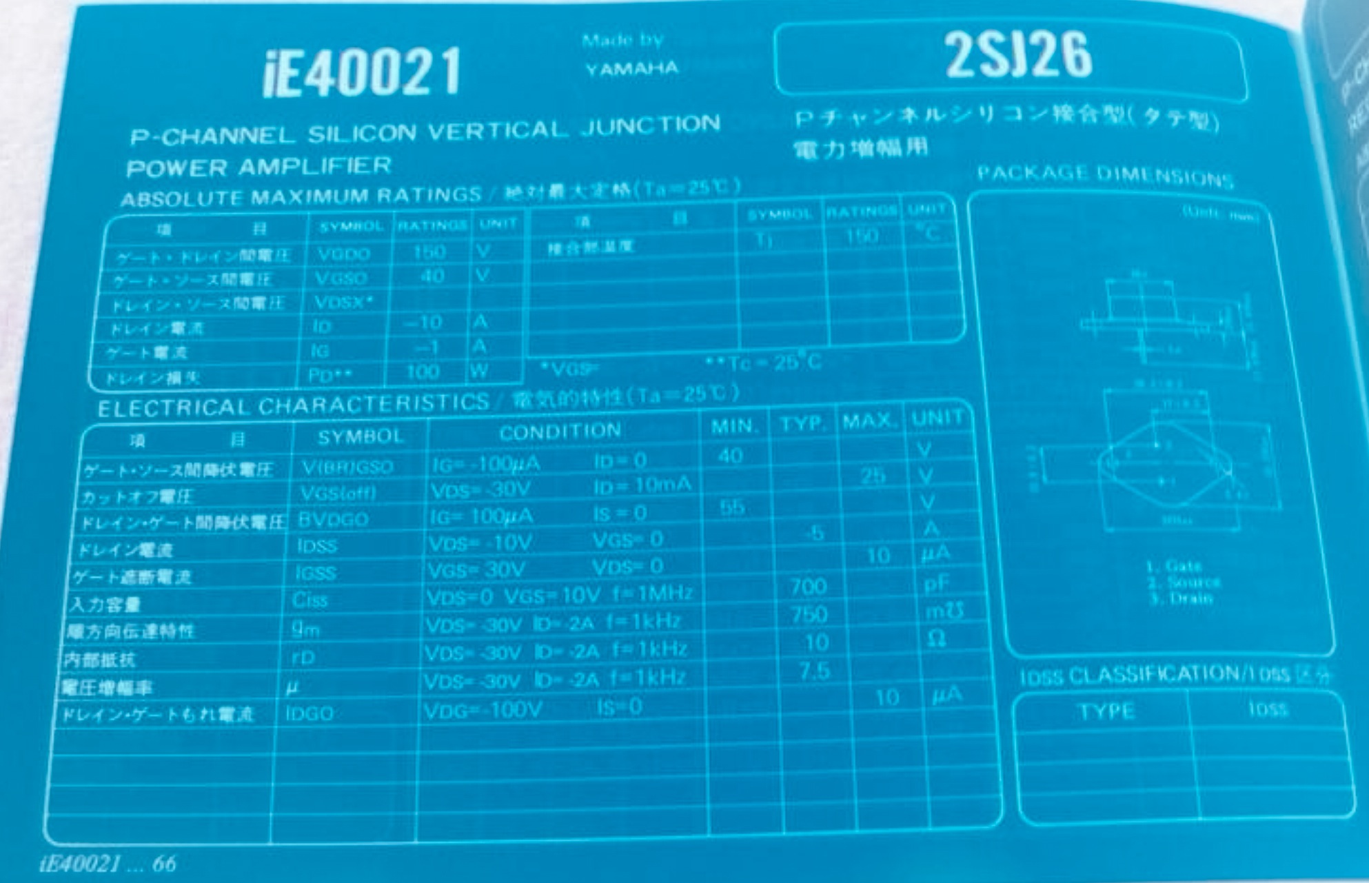

So many thank's, the second message helps a lot. So I can make good use of this transistors. I am looking forwards to receive 4 pairs of them. Nice.

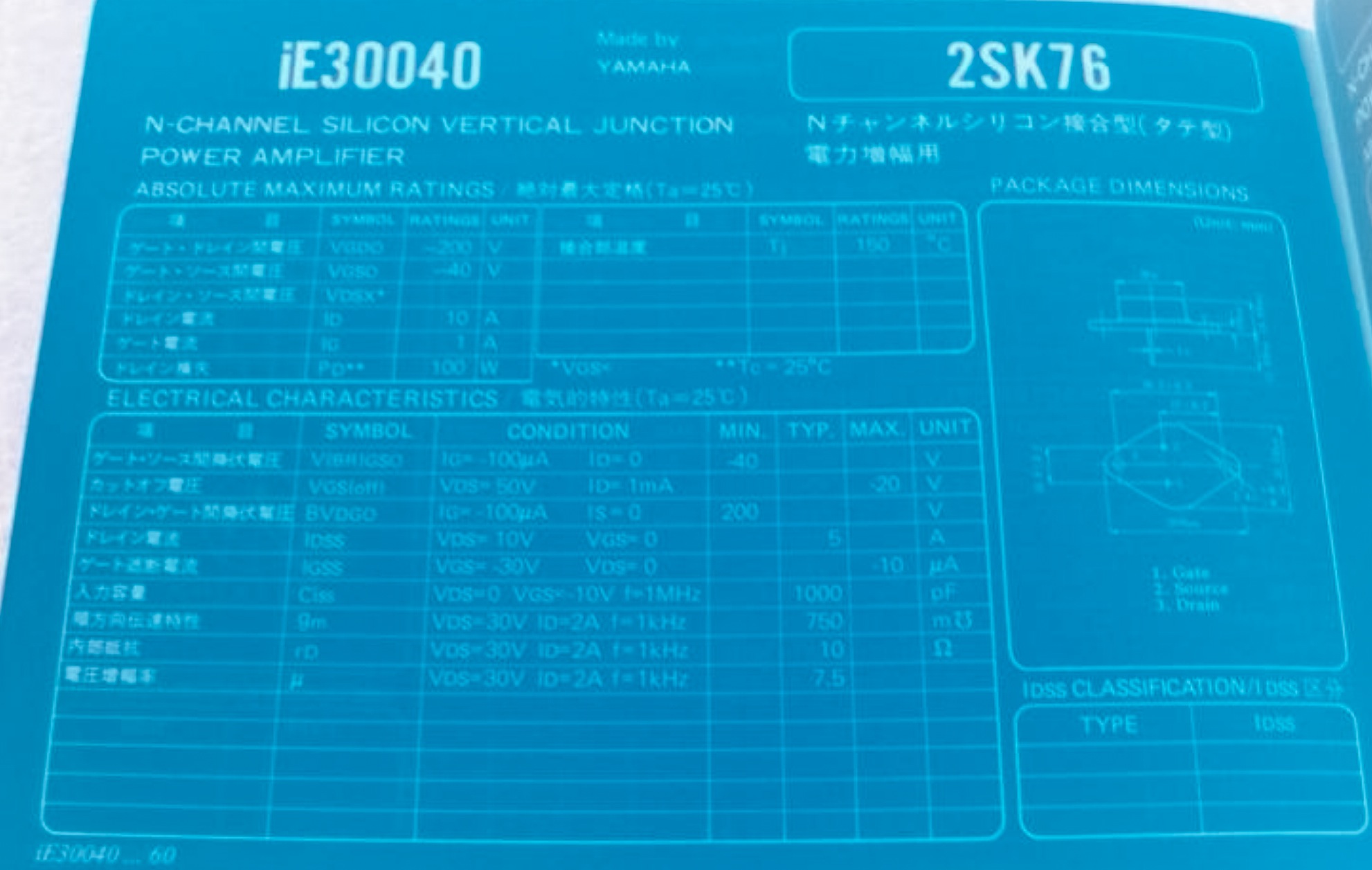

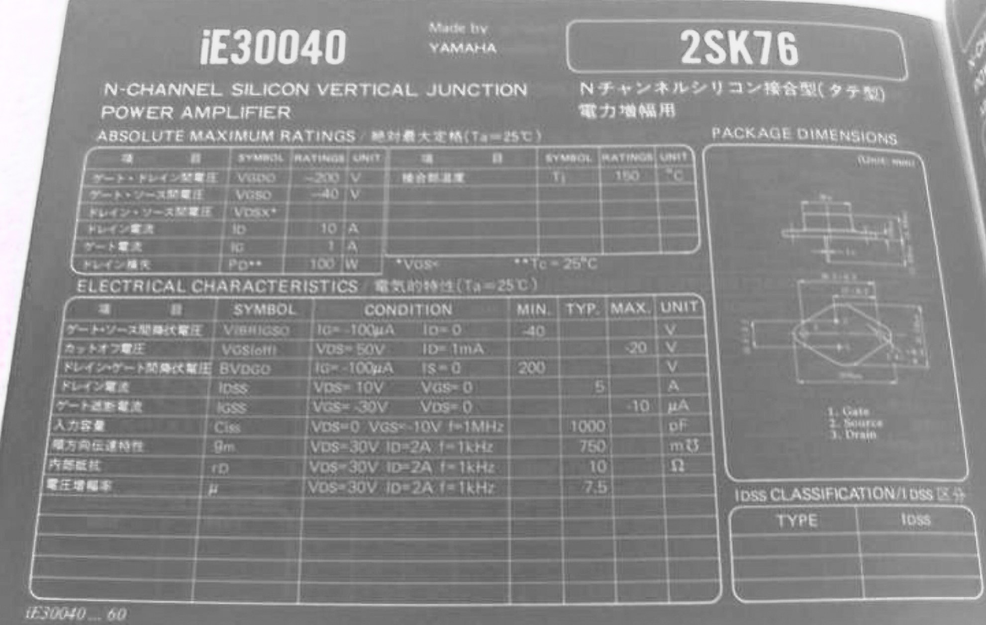

Soundhappy Member Joined 2012 2020-09-24 7:55 pm #7 2020-09-24 7:55 pm #7 Yes Yamaha Pd= 100Watt's Have a nice evening
