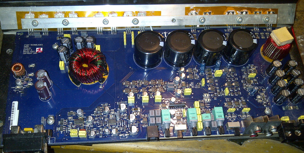

It looks like it's very similar to the MTX6500. If so, the circuit would be similar to the Sony amps. I'd need to see more detail to help.

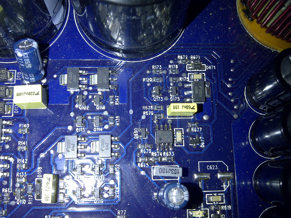

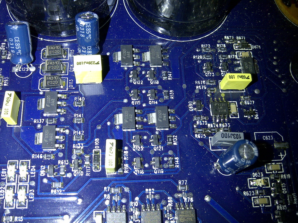

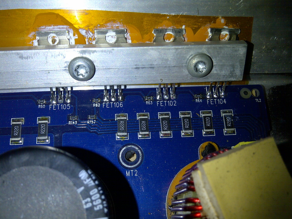

It's part of the over-current protection. It's sitting on the negative rail and senses voltage across the 0.22 ohm resistors that are between the negative rail and the source legs of the low side output transistors.
