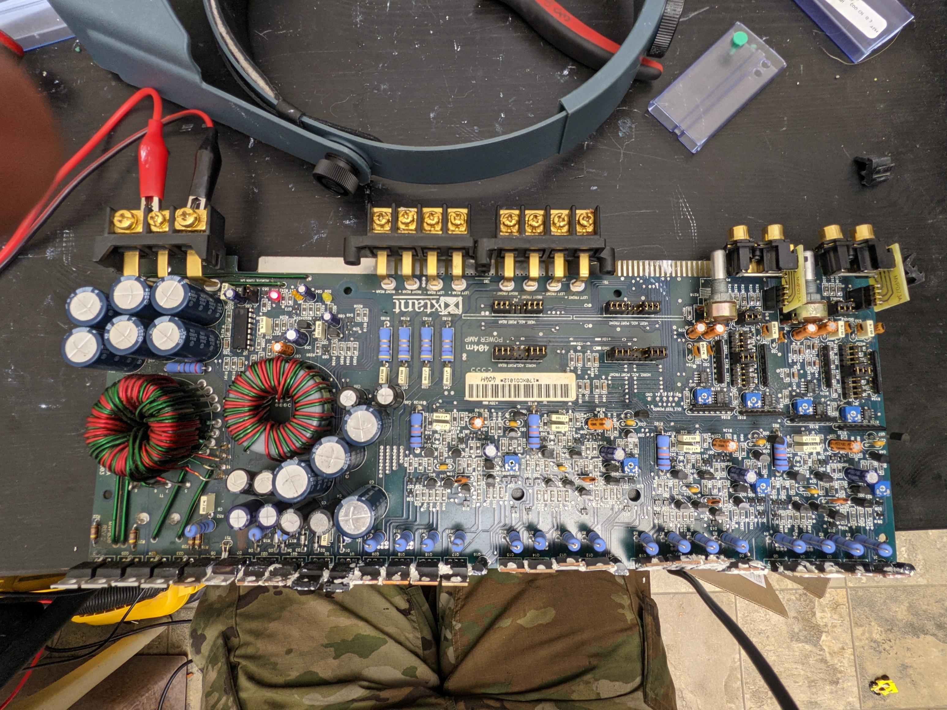

When I got the amp, the power FETs were shorted out, so I replaced them.

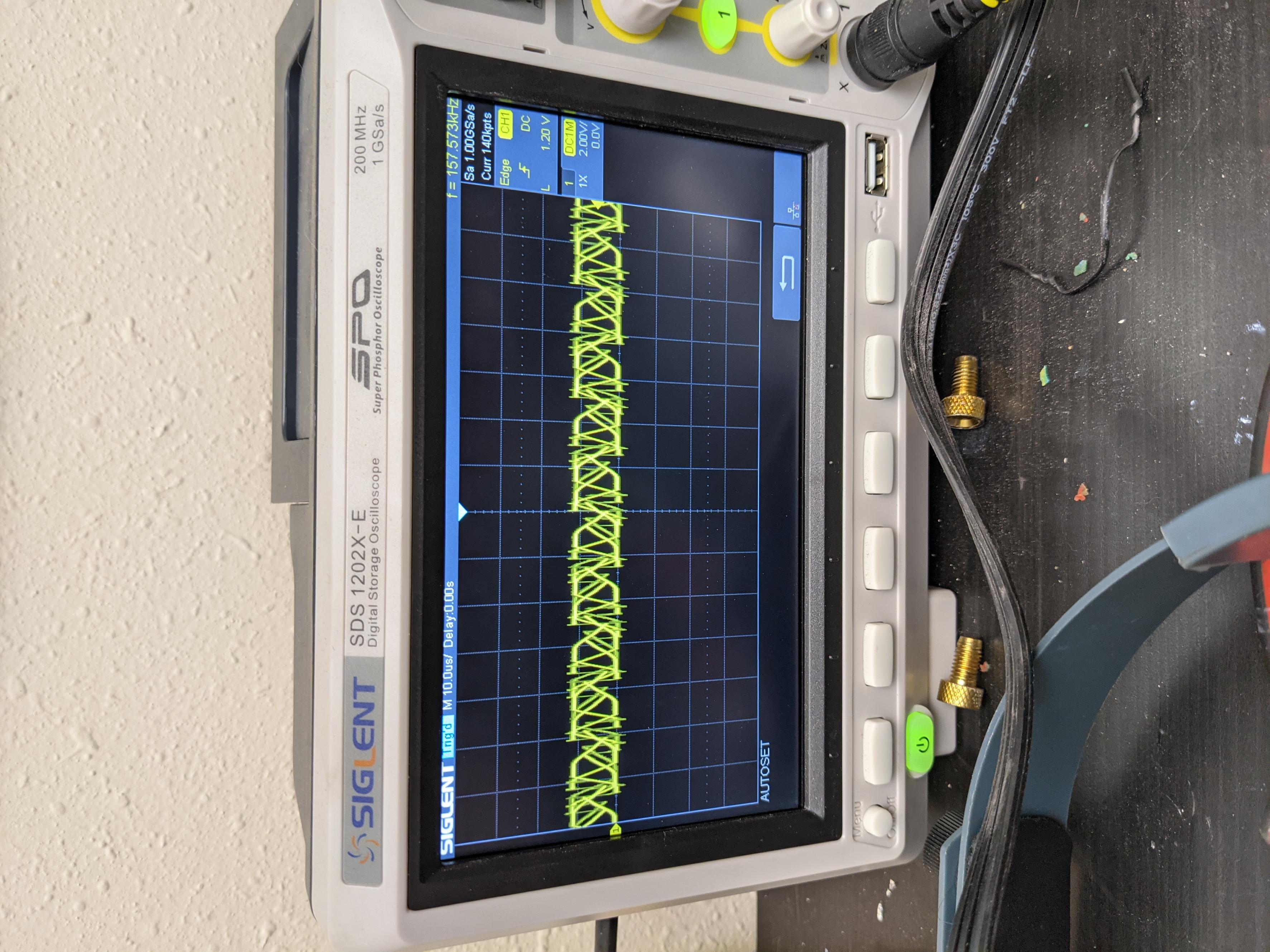

This amplifier will show a normal signal on the power FETs when the rectifiers are out, but when they were in I get this... where it's like two or 3 waves over top of each other. When the power FETs were out, I had the same signal. I thought maybe it was the driver, so I replaced that, but clearly it didn't help.
I thought maybe someone would have seen it before or have an idea what causes it. I'm all ears!

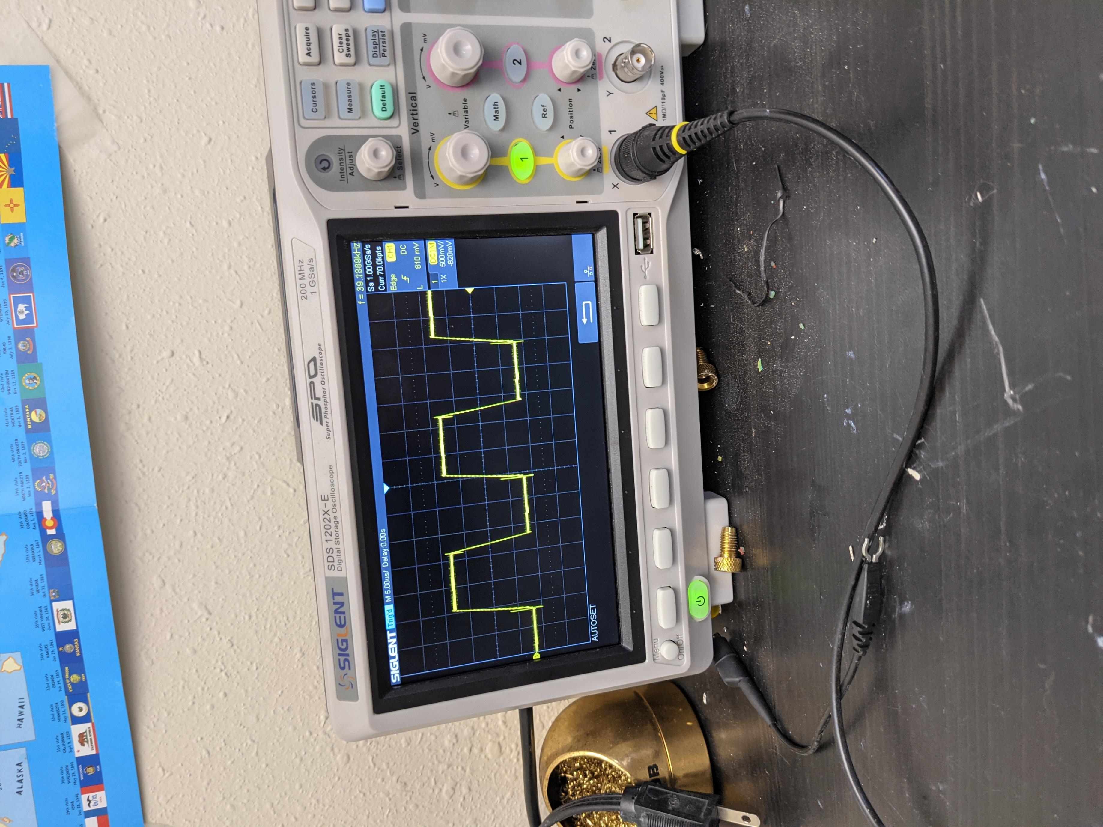

The scope isn't triggering properly. Take it off of auto, set the timebase to 10us, the vertical amplifier to 5v/div and the coupling to DC. Adjust the trigger level until it displays one single line of pulses on the base.
Change the vertical amp to 10v and then probe the drains. Readjust the trigger level is needed.

This is just above 9 volts, iirc.
So is this normal for this amplifier? When I have it at around 13v, it'll show +-25v on the rails. The rectifier wave looks so much different than the other amps I've worked on.

The power supply is regulated. When the pulse width decreases (when the rails reach their target voltage), the waveforms won't look perfectly square. Decreasing the 12v supply voltage forces the pulse width to increase to try to maintain the target voltage.
Awesome, thanks for the explanation. Makes sense now!
So when I had the rectifiers out, it wasn't getting any rail voltage and was commanding full pulse width to increase power, which makes for a nice wave.....correct?

Yes. It was doing all it could to get to the target rail voltage but could not, even with full duty cycle.
