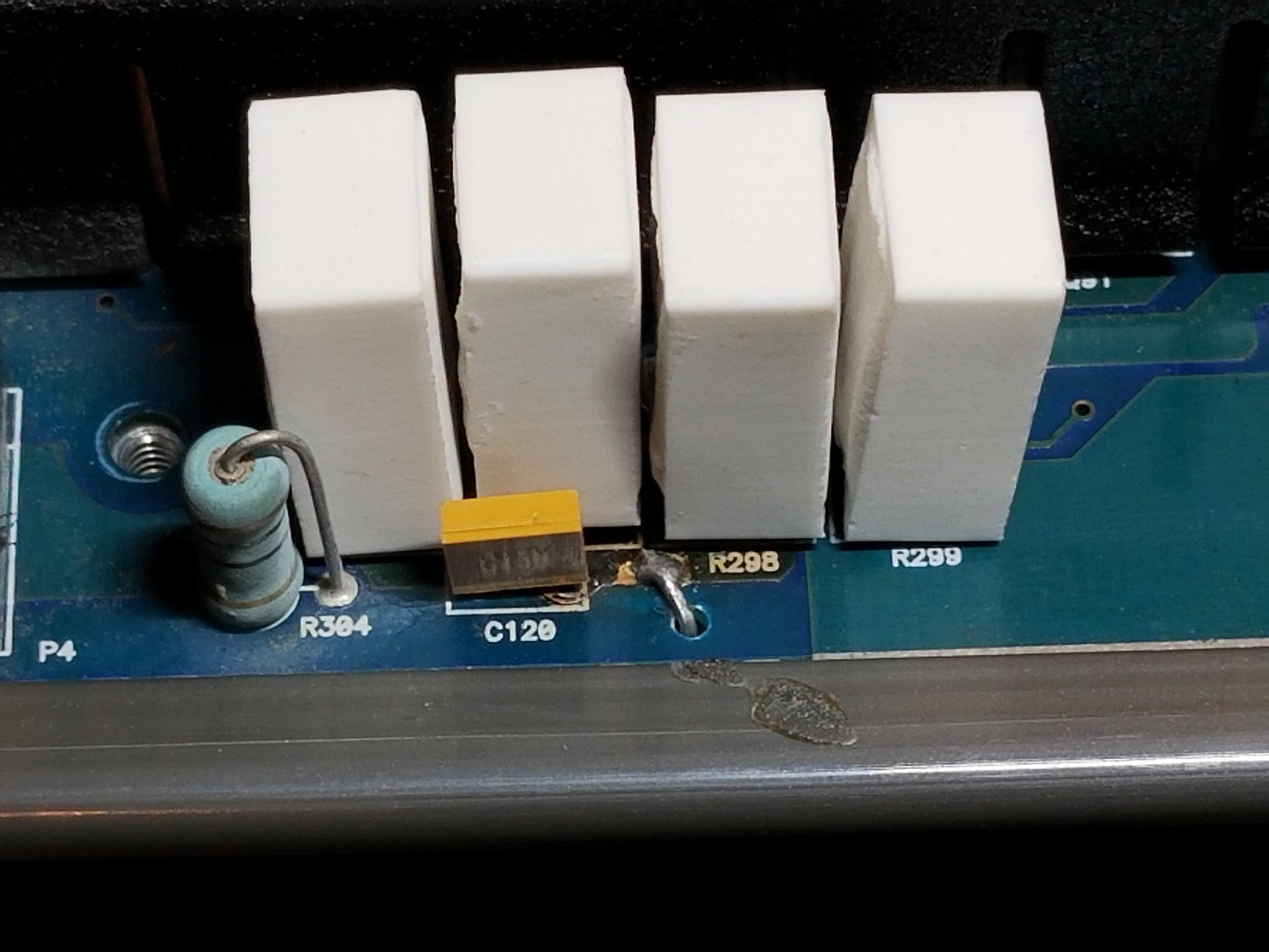

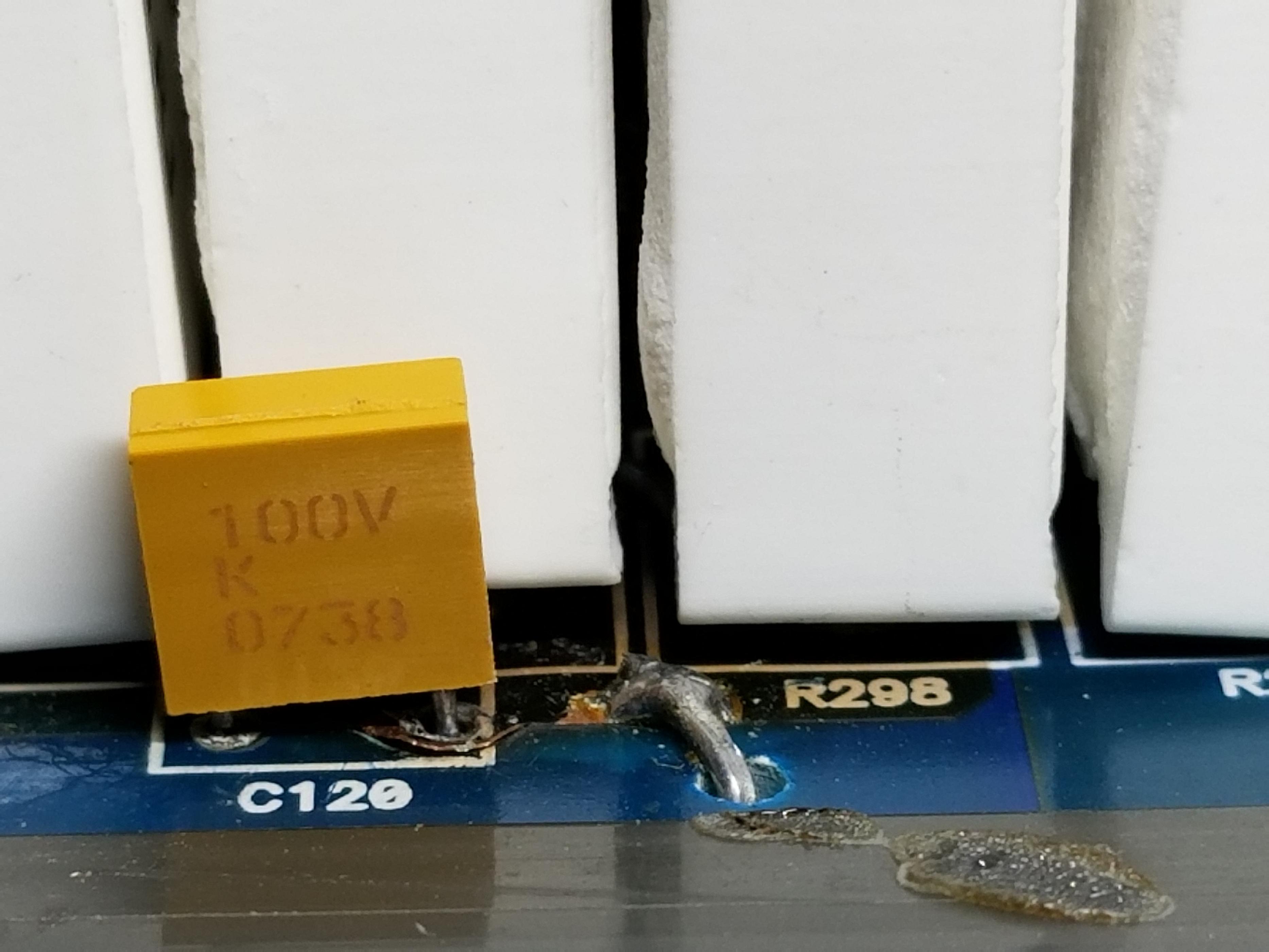

Only one of them is actually having problems. The orange low impedance LED is blinking at a steady beat. When I measure dc offset of both channels I'm getting readings that are fluctuating rapidly anywhere from 35mv to 135mv. I connected a test speaker to the amplifier outputs and I am hearing a distorted buzzing type of sound that matches the blinking low impedance LED flash. Someone has been in the amplifier and has did some work. I don't know if this could be causing the problem. I can post pictures tonight when I get home. The rest of the amplifiers are working but bias seems to be different on each one. Dc offset seems ok with the rest of the amplifiers at around 25mv.

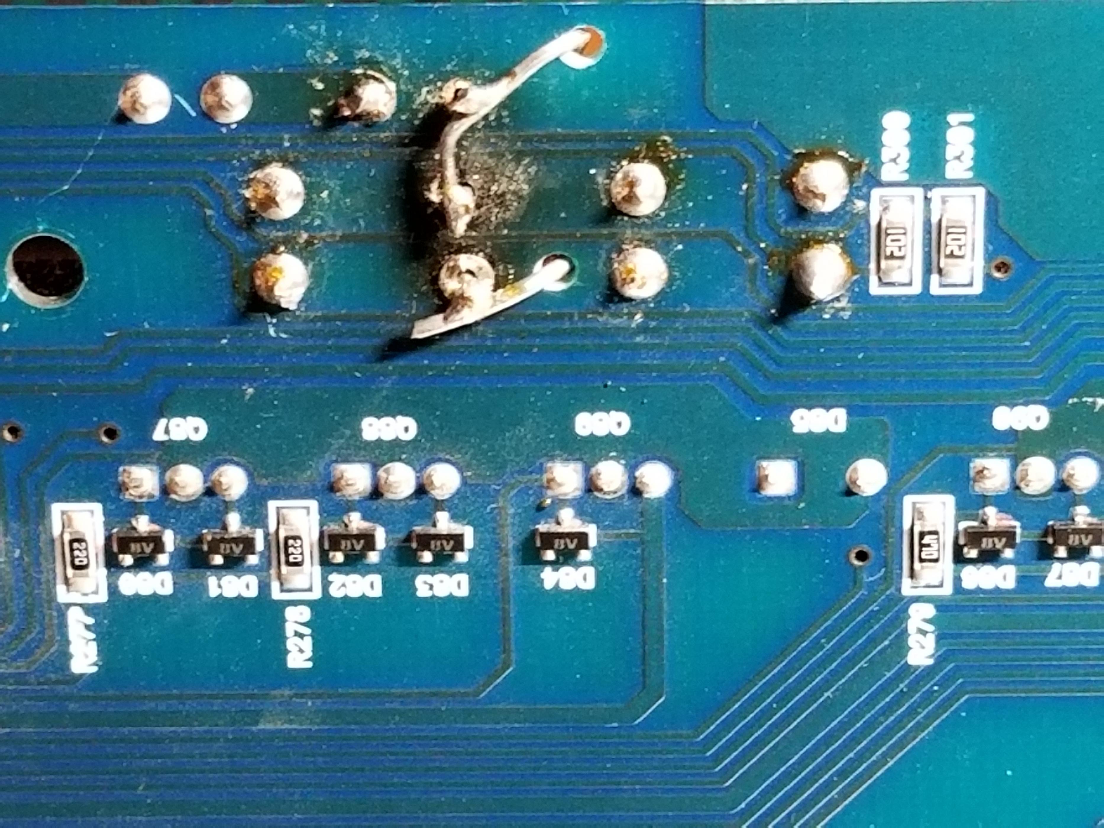

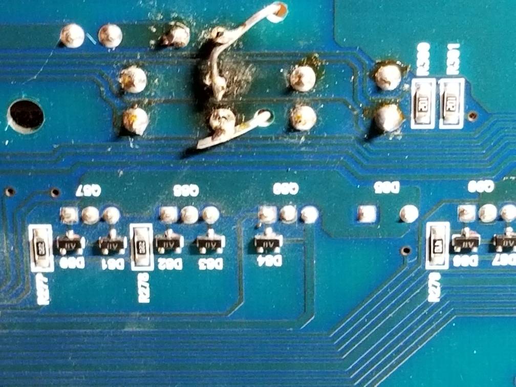

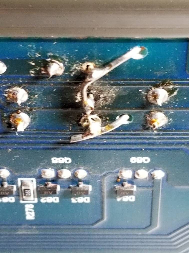

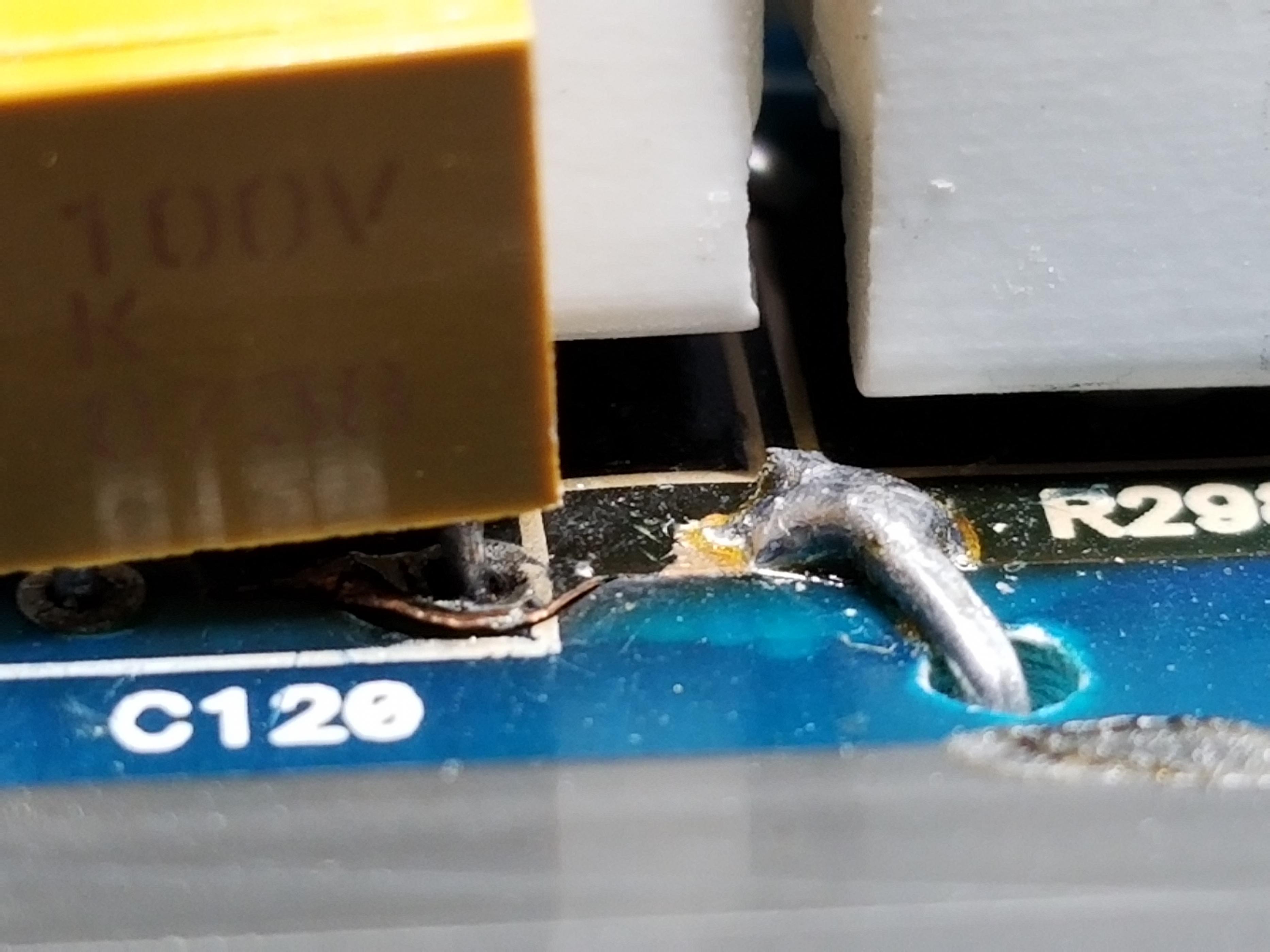

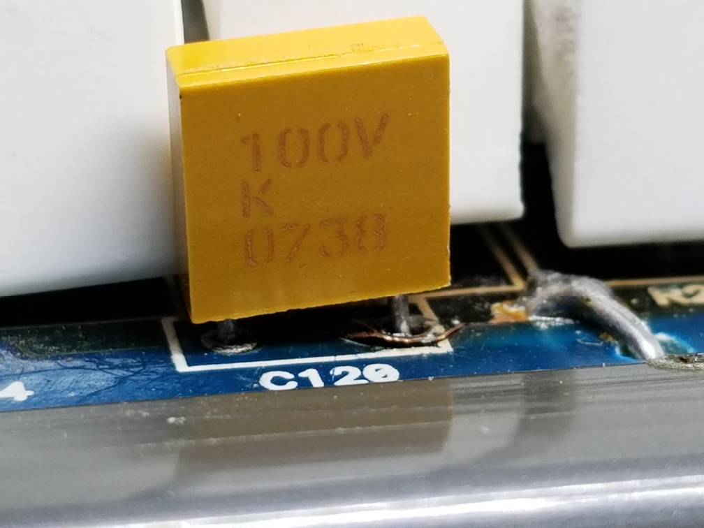

Well, after reading up on how to post pictures on the forum, I think I may have gotten it. I should have done my due diligence before attempting to upload the pictures without knowing the process. I apologize. So, here are the pictures of the board and the suspected repair. I have googled the capacitor markings but have not found any specific info on that capacitor. I know the original value of the cap since I have multiples of this amp. I am just trying to determine if this replacement that was used is the correct value. Hopefully, the pictures give you an idea of the repair and if this could be the issue described in my second post.

This is a 2-channel amp. Both channels should be identical. Compare the connections of the components on this channel to those in the other channel.
You may want to remove those 4 resistors and the small cap to inspect the board condition under the resistors. The capacitor could likely be soldered to the top of the board. The jumper may be for a damaged via for the resistor.
