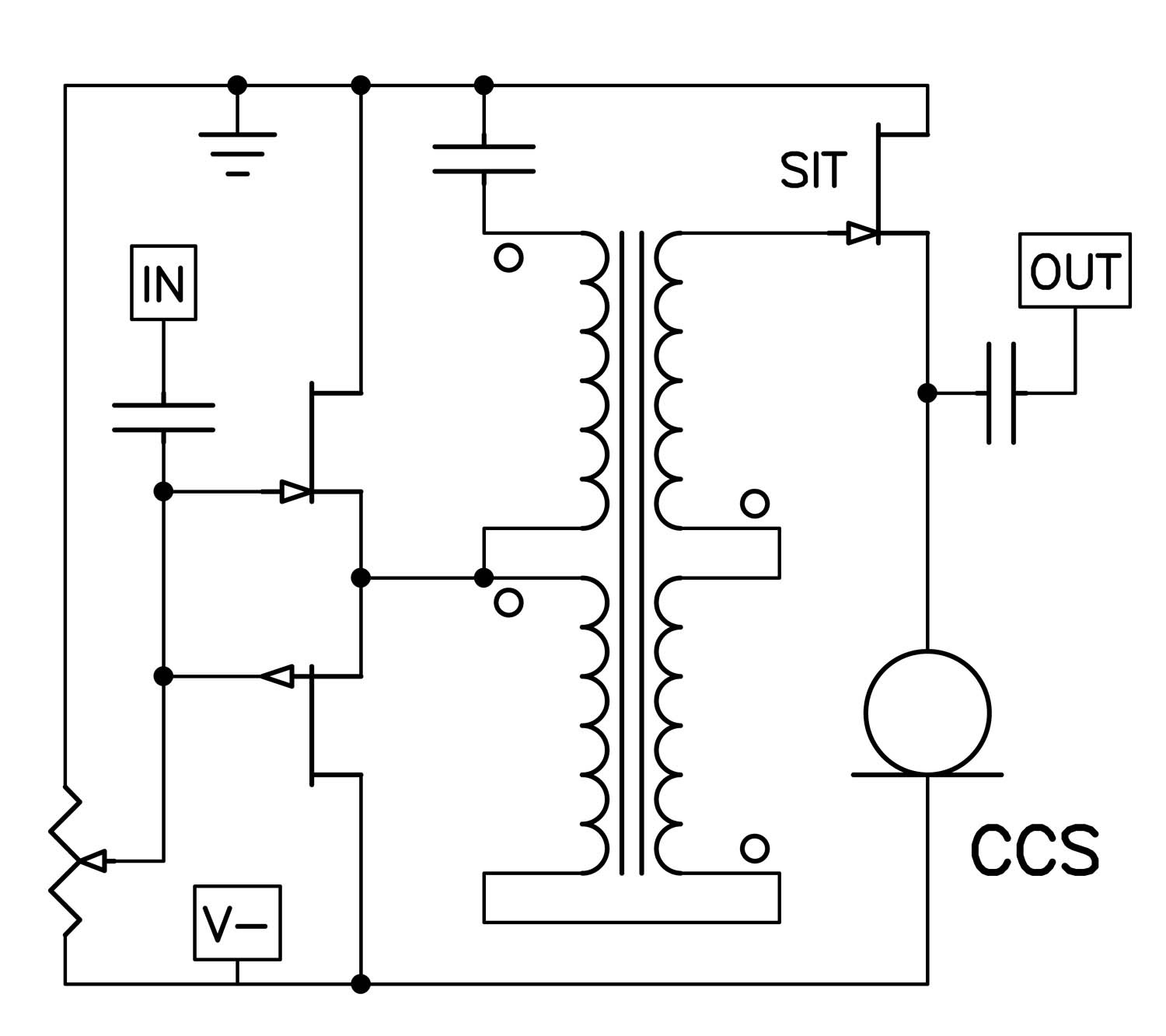

The SIT-3 circuit you posted in the past shows a jfet pair input. I think this is limited to ~30V or so? The sweetspot of the 2SK180 is more like 35V I think and then you going to lose a bit across the CCS. So how best to change this circuit for the different optimal rail voltage?

Wow. Interesting circuit.
Single ended power supply.
You could probably go to 50V but that will only give 25V across your Sit.
You would need to cascode input stage to go higher.
How critical is 35 Vds for 2sk180 when used as a follower?

The Vds and Ids you select depends on the performance you want from the SIT
and the load impedance. SIT-1 transistors like something resembling 15 volts
and 1.5 amps with an 8 ohm load. Not a lot of point having a 50V rail for the
part in that circuit, but you can do it, the extra dissipation goes to the current
source.
Other parts and loads, YMMV.

If I were to have a B1 Korg front end and couple it with an input capacitor, could I drive the transformer directly and remove the two input JFets.... the concern over rail voltage across the input pair would go away.

Korgie is , at least as I'm understanding Papa's article , too sissy in swing department
happy up to 1V ....... though , for a moment I'm puzzled - is that for RMS or p-p ?
I'm always thinking in p-p terms , but I presume graphs are all for RMS figures

First, how important is it for you to have 35Vds for 2sk180?
Surely it is not too bad at 20Vds.
Remember this is source follower operation.

Use j103 k246 instead - theyve a higher voltage rating and should still be fine as a buffer.
second this info. THD null at 35-36vds in follower mode too?
