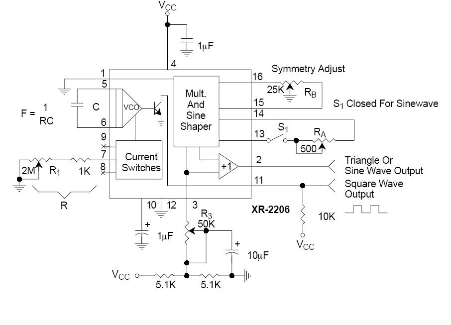

my ELV XR2206 function generator does a acceptable squarewave.
What is your problem with symmetry?

3 problems
1-the upper part is rounded ....
2-and then again there is no way to adjust this ( at least on this circuit )
3- scuare wave doesnt function throuthe all spectrum of freq ( sine wave was perfect )
the circuit is done as is in the book

The problem comes from the open collector output: the high level is created passively, with the 10K pull-up.
The current in this resistor is insufficient to overcome the capacitive parasitics and the stored charge of the transistor. You have to use a resistor as low as practical, and add a totem-pole buffer to remove the effects of loading.
But in my opinion, it is rather silly to use a full-blown function generator just to generate square waves.
If you want clean, frequency-variable square waves, you can use a schmitt trigger oscillator (CD40106) followed by a flip-flop to get a symetrical waveform (CD4013) and an output buffer made 8 bus drivers paralleled (74C244). This is just an example, there are many others options that are simpler, cleaner and cheaper than the 2206.

all this sounds very fine
but really dont know how to do this ....is there a schematic that you know that is tetsted and working that you can point to me ????

Make an oscillator like this one:
http://www.interq.or.jp/japan/se-inoue/e_ckt13.htm
eventually followed by a 4013 in divide by 2 mode if you need a perfect symetry, followed by some kind of buffer (you can use the five remaining 40106 or a supplementary IC).
Alternatively, you can use a ready made oscillator like the 4046 or 4047; with the latter you have the advantage of having the flip-flop already included.

old thread but i am back to this cause now i need it again ...
fixed the square wave issue adopting the output scheme of this circuit http://electronics-diy.com/electronic_schematic.php?id=818
then the problems are
1) i get spikes on both up or low sine ( will post pics tomorrow)
2)also it is impossible to adjust the lower wave form correctly , the lower part of the sine is out of center
any ideas ?
any ideas ?

Hi Sakis
That glitch is inherent in in all simple 2206 sinewaves.
Elektor Function Generator generator from ~1980 had the same issues, even as a complete and well built instrument.
The problem is with switch and lead capacitance at pin 13 and the solution they used in a revised circuit, was to fit a very closely wired BS170 mosfet switching device. I hope you will know how to wire that up, because I can't recall all the details of what voltage was used.
EDIT: This might help: http://www.granta.g4axx.com/pdfs/Generator.pdf

This IC was meant for easy build of a basic functions generator ,
good for its waveforms versatility but average not to say mediocre
performances wise.
performances wise.

Though square waves are poor past 20khz compared to a TLC555 wired as a schmitt trigger astable oscillator.
I use XR2206 for sinus, and Schmitt trigger for square.
This might be a very wrong answer.. someone else will have to confirm, or if you have the parts it wouldn't be hard to try.
A schmitt trigger on the output might give you 'sharper' output. A high-speed opamp in a buffer config will give a low impedance output.
I would recommend the 555 timer-based oscillator that bobodioulasso posted. Simple and effective.
