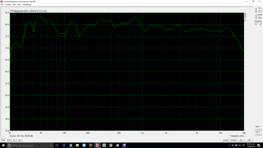

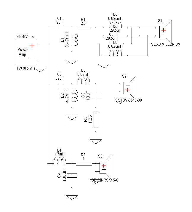

Xover to add super-tweeter in a 3 way loudspeaker, I have laying around a couple of Focal TC120TDX2 that I want to use as super tweeter in my current 3 way system. Need help for suggestions what frequency to cross them, attached xover used in the current 3 way loudspeaker & Focal datasheet.
FR two loudspeakers smoothing 1/3
IR two loudspeakers
What about using a xover at 15kHz 2nd order 12dB/octave 3dB slope @ fx?
IR two loudspeakers

Another view on the seas design : a) resistor in series b) 😕😱 a lowpass?
Between the attenuation resistor R1 and the tweeter is a filter for time delay alignment😉
