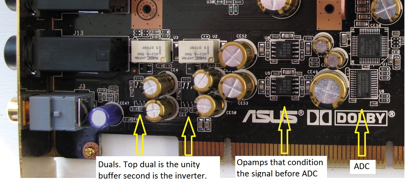

Either way the input to the Xonar follows the data sheet for its ADC fairly well. The first pair of opamps that you reach are a unity buffer followed by an inverter. This creates a balanced feed. This then goes into another pair of opamps that condition the signal prior to entering the ADC.
The first opamps aren't really suitable for modding. The second pair are but I would do so with caution. The Xonars PCB is quite fragile and the surface mount parts are quite small and tightly packed. Not to mention there are plastic SMD caps here too. These do not take kindly to an accidental poke from a soldering iron, often outright failing if you do so.
Either way I have attached an image that shows you what is what.
I strongly recommend you use a preamp before the xonar instead, or mod your phono stage to output more voltage perhaps.

The inputs to the Xonar wont fry unless you feed them with a signal that is far past the clipping point. All that happens is that the first opamp in the input chain gets its inputs fried, replacing the opamp solves the problem. The opamps used cost very little but if you want to replace them you need to be careful while doing so.
The input to the Xonar is configured so that an analogue signal of ~2Vrms = the maximum amplitude on the digital scale (0dBfs) from the ADC. This is the normal standard voltage level that CD players, DVD players etc will output when reproducing a full scale digital signal. If you exceed this value the inputs clip but you have to overdrive them quite a lot for them to blow up.
Now the control centre is very basic, all it does is digitally attenuate the signal coming out of the ADC. This means that if the analogue signal level reaching the ADC is clipping the ADCs inputs, that turning the inputs down in the control centre wont do anything to stop the inputs clipping. All you do is turn down the clipped signal digitally.
All sound cards tend to work in this kind of way, if any change in levels is needed it is all done digitally, this is because we don't exactly have potentiometers wired up to our sound cards such that we can alter signal levels in the analogue domain. This means that if the Xonar did offer some gain on the inputs it would most likely mean that it would be done digitally anyway, after the signal had been digitised. The headphone output on the Xonar for example can be configured to work at different output levels depending on the sensitivity of your headphones, this is done in the digital domain. The PCM1792 DAC has a built in volume control and all the Xonar does is turn the output down via the DAC if you select 64ohm sensitive headphones.
