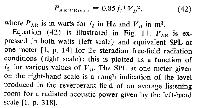

Here is the quote from Small's 1971 article.
I can send you or anyone reading this the whole article if you want, if you are technically minded. I have both parts on my hard drive. 🙂

I just figured out that this chart does not include room response for sure.
http://www.diyaudio.com/forums/attachment.php?postid=55867
How do I know?
Try this. Take a look at 101 dB SPL, and notice the volume of air that must be displaced as you go down octave by octave.
The displaced air volume is:
80 Hz: 3.2 cu in
40 Hz: 12.8 cu in
20 Hz: 52 cu in, (approximating from chart).
In each case, when you maintain the same SPL but go down an octave, the amount of air you must displace increases four times.
That agrees with the general rule, for outdoors or anywhere-going down an octave in frequency while maintaining the same SPL requires four times the volume of air to be displaced.
If you included room gain in this chart, this would not be so. If you maintained SPL and moved down an octave, you would only have to displace 3 times or two times the air. The room gain would supply the rest of the SPL.
But that does not happen in this chart. Therefore, this chart does not reflect room gain.
As a result, you can count on your output in a real life room as being above the SPLs listed here, especially the lower you go. Just about every real life room you encounter is bound to have room gain.
