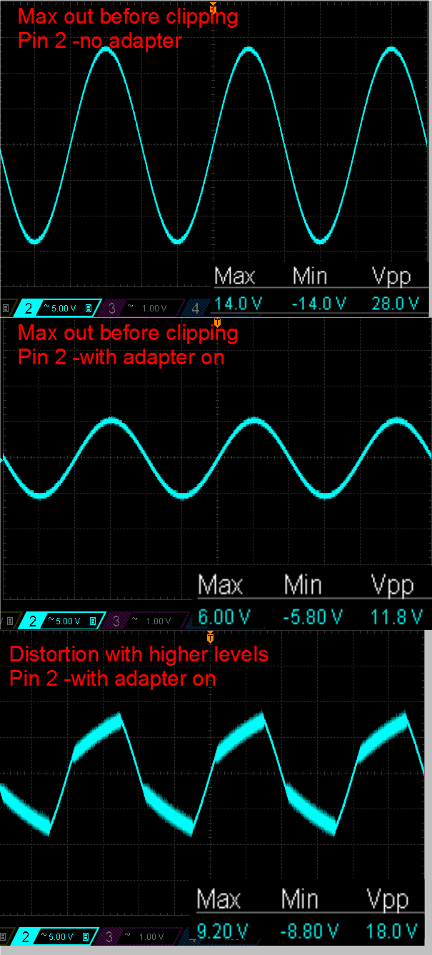

I've always heard that when making an adapter that goes from XLR to RCA, you the standard way of wiring it is to tie pins 1(ground) and 3(cold) together like this: How to Wire an XLR to an RCA Connector
When using such an adapter though, it limits the maximum output of the preamp by almost a third.
This attached picture shows the maximum voltage out of the hot(pin 2) line without the adapter and then with the adapter. The adapter that ties pins 1 and 3 together causes a lot of distortion past ~6Vpk.
Does anyone know why this is the common way to adapt XLR to RCA if it causes this problem?

Connecting a balanced source to an unbalanced input is always a bit tricky. Whether pin 3 should be grounded or left open depends on whether the source has a high or a low common-mode output impedance.

Shorting an active output is always a bad idea, leave 3 open.

It depends on the whether the source is more or less floating (high common-mode output impedance, for example a transformer-coupled output) or not (low common-mode output impedance, for example two amplifier stages driven in antiphase, one of which drives pin 2 and the other pin 3).
With a source with floating output you need to ground pin 3 to stop the source from floating. When it doesn't float in the first place, you have to keep pin 3 open to ensure you don't short circuit anything.

Say we're talking about an 8pin dual package op amp with 2 inverting buffers to get the hot and cold out. There is an AC coupling cap and then 100 ohm resistor to isolate the op amp from the capacitance of the output cable.
Is leaving one side of the op amp floating bad in this case?
Wouldn't it make more sense for the adapter and put a load resistor between pins 1 and 3 so the output amp isn't floating anymore if this is a bad thing?
I guess because this thing is distorting badly with pin 1 and 3 tied together it's common-mode output impedance is high?
Would it make sense to put a resistor load from pin 3 to ground then?

Some professional equipment is setup (on purpose) such that providing a pin 1-3 short on the output increases the gain available on pin 2. (The Behringer equipment for example.) However, I agree that it's probably preferable to not have the pin 1-3 connection.
Shredhead, I would perform surgery on your adaptors to remove the pin 1-3 connection. That will most likely eliminate your distortion. If you have enough gain then you're all set. Limiting your preamp maximum output is not necessarily a bad thing. This "floating" output on pin 3 will not be an issue at all.
FYI, a lot of source equipment with balanced XLR outputs doesn't even have signal on pin 3. Just a resistor to ground with a value equivalent to the source resistance on pin 2 to create the balanced source impedance.

In this case I'd leave pin 3 open. Both op-amps produce a voltage referred to ground, so it doesn't float with respect to ground (not at the signal frequencies, that is).

Op amps are stable with their outputs floating right? Cause if so, I don't see myself ever connecting pins 1 and 3 for an adapter again.

Oh, an op-amp output certainly CAN be floating. 🙂 Or at least in a state that allows it to drift to one of the voltage rails. I don't believe that's the case here with shredheads inverting buffer setup.
The "floating" issue is being confused here. Even if you leave pin 3 unconnected, that op-amp output is not floating.....it's just unconnected.
To get the output to "float" you would need to be running it with the inputs unconfigured in some way. Normally, with an unused opamp (or section) you would tie the output back to the inverting input and take the non-inverting input to ground via a resistor.
