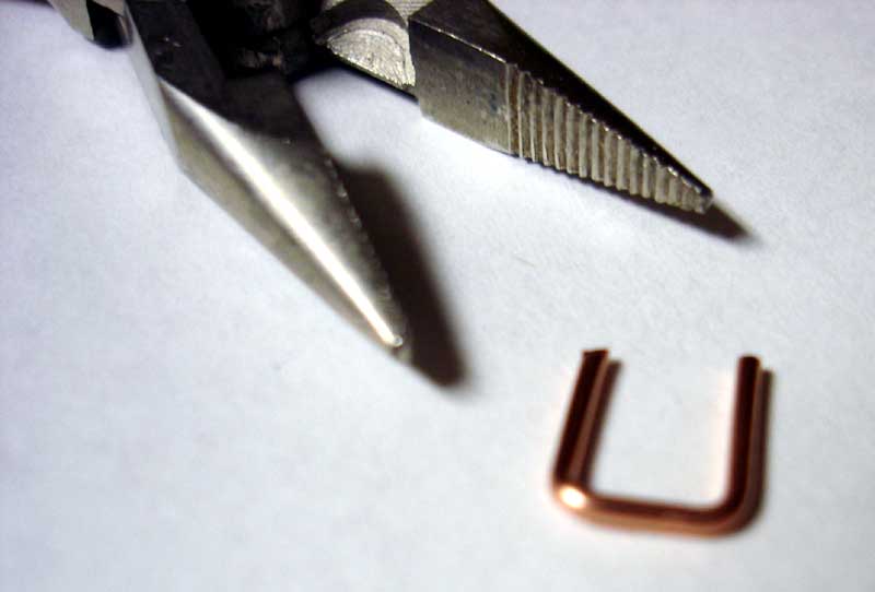

i dont know what you are doing wrong, but making your own shouldnt look any different than a commercial one.
step 1, get some large guage copper wire (solid of course). cut and strip a length of it. maybe about 3 inches long.
step 2, using your fingers, pull it straight, so you get it as straight as possible.
step 3, using a pair of pliers, firmly grasp the wire about 1/3 the way up. firmly press the wire so that you bend it at a nice 90 degree angle. it should look like a right angle, not a smooth curve.
step 4, measure the distance from hole to hole on the xlr jack. position pliers so you can make another 90 degree bend, repeat step 3.
step 5, cut wire so both ends are the same length, so they are even.
step 6, use!

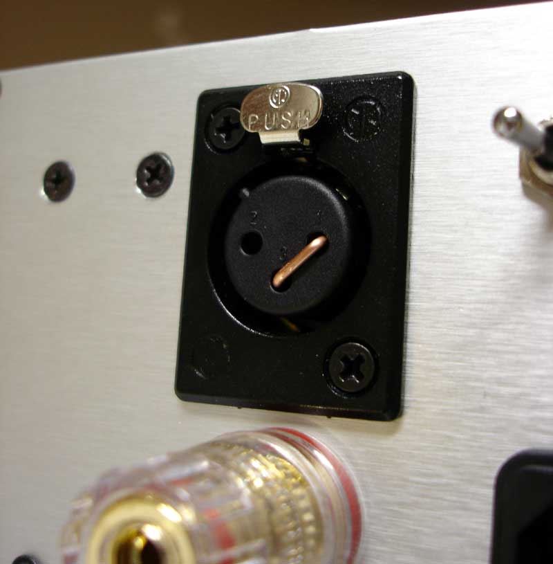

see picture. took longer to write this email. took about 30 seconds to make the jumper. (it looks uneven, that's just the angle of the picture).

I think the copper wire will oxidize pretty quickly, so I'm still going to hold out for something plated on the XLR shorting things.

i said specifically not to use that exact wire. if you get a plated wire, you will be fine. also, just dont touch the wire, and use some wipes on it, and it will be fine.

Sharing this paragraph from P.5 of the XA200 manual:
The amplifier may be driven single-end or balanced, your choice. Single-ended input will always occur through the RCA connector and balanced input will always occur through the XLR connector. If driving the amplifier single-ended leave the supplied jumper in place between pins 1 & 3 on the input XLR. On the XLR connectors pin 1 is ground, pin two is positive input and pin 3 is inverted (negative) input. Pin numbers are marked on the XLR.
On P5 of the XA200 manual there is a line drawing of the connector with jumper installed.
yep. the inputs are run parallel, meaning both are always active. but to use the rca, the xlr needs to be shorted.
you can either use a jumper like i showed, or you can make an adapter (like i showed in the link), OR, make a cable as suggested by wuffwaff. if you already have interconnects, you might not want to make your own cable, but you COULD get an XLR>RCA adapter and put it at the preamp side, and use an xlr cable from adapter to the amp.
