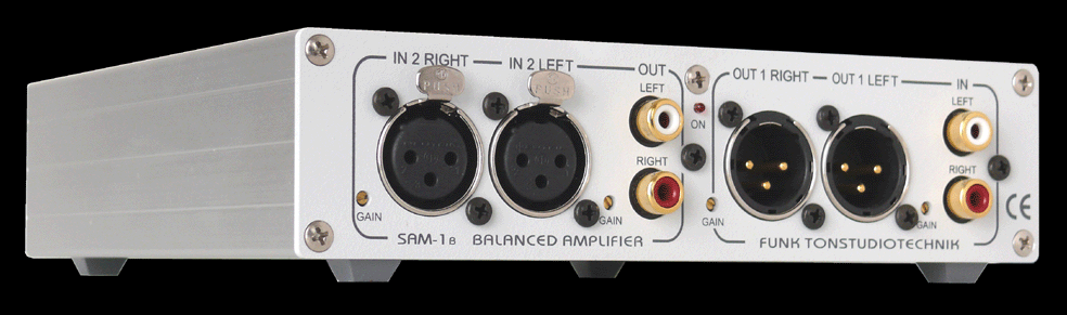

For those interested, if you need a RCA/XLR buffer with 4 MOhms of input impedance and about 25 ohms of output impedance, I suggest this pro audio item (SAM-1Bs/2svs2) made by Thomas Funk, more serious stuff and great technical support.
From the only email I got from Burson Audio (I sent them several ones), their position is clear at this point: the item is no longer supported as it is old, and should be sent back to the seller. My personal idea is that they probably made a wrong project by transforming the RCA buffer into an XLR buffer, but they will never admit this for commercial reasons (it's sloppy to create a short...).
I am therefore returning the item to the collaborative seller (loosing more than 50 euros for the two-way shipping cost that cannot be reimbursed). Sadly Burson Audio did not help us to find a solution... I will not buy anymore their stuff.
