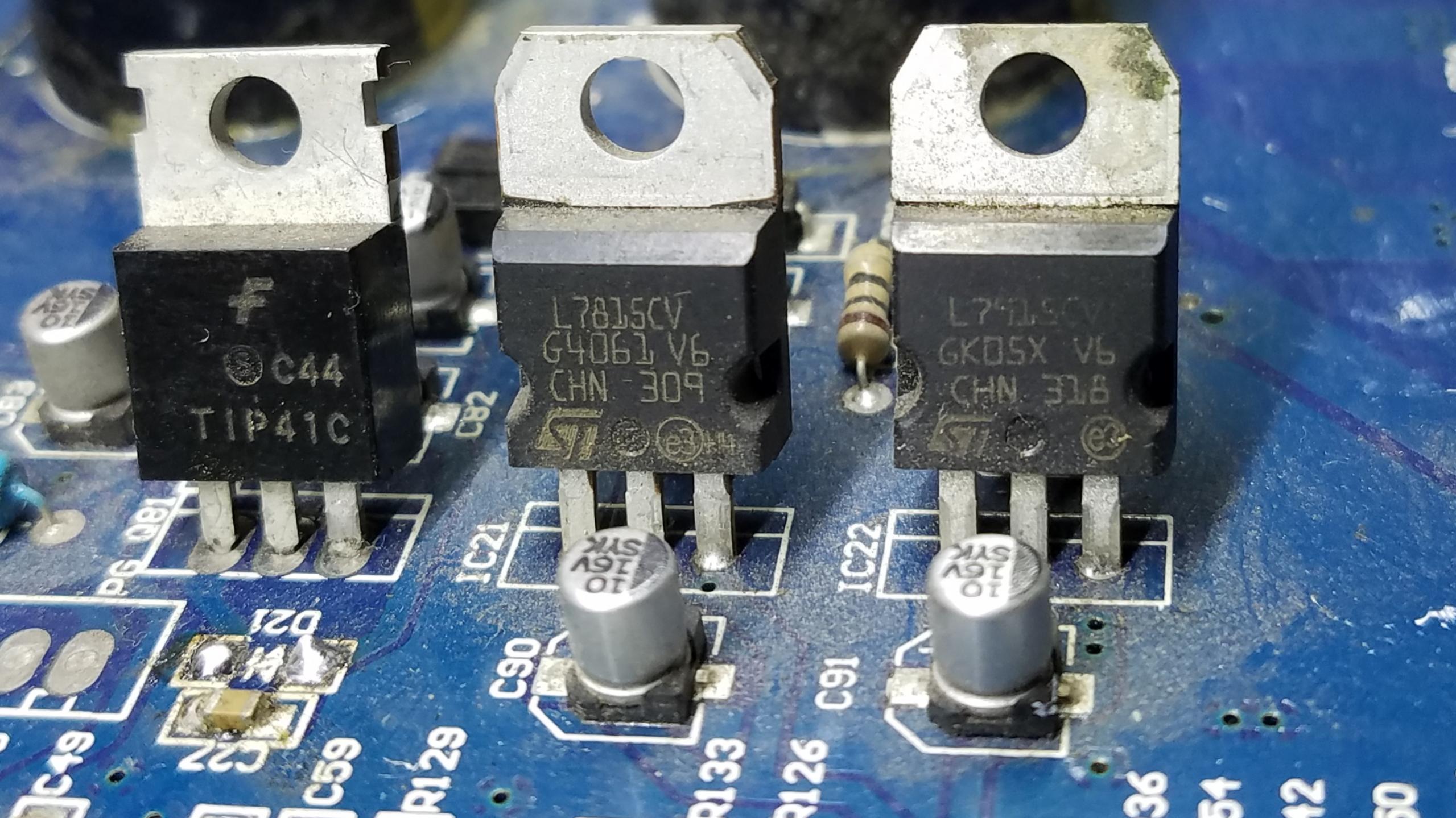

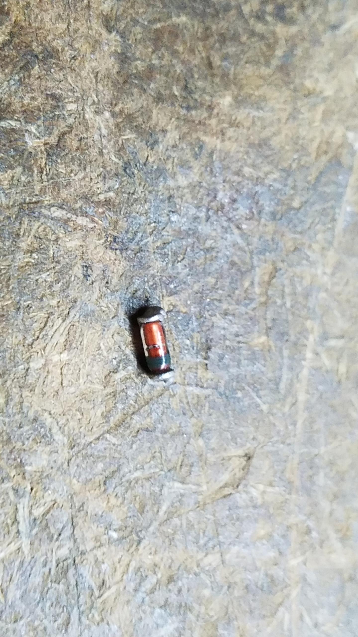

Hello friends, someone with information about this amplifier, I am missing the value of R39 and what diode does it have in D21? and what values or signals should i see in the ic IR2184S regards

It shows the TIP41C's emitter going to pin 5 of the 2184. If that's right in this amp, the diode was possibly a MMSZ5245B or similar. Check the size.

I don't think it is, I just found a blue stripe diode stuck to another component as if it had been removed and misplaced only it has no nomenclature
