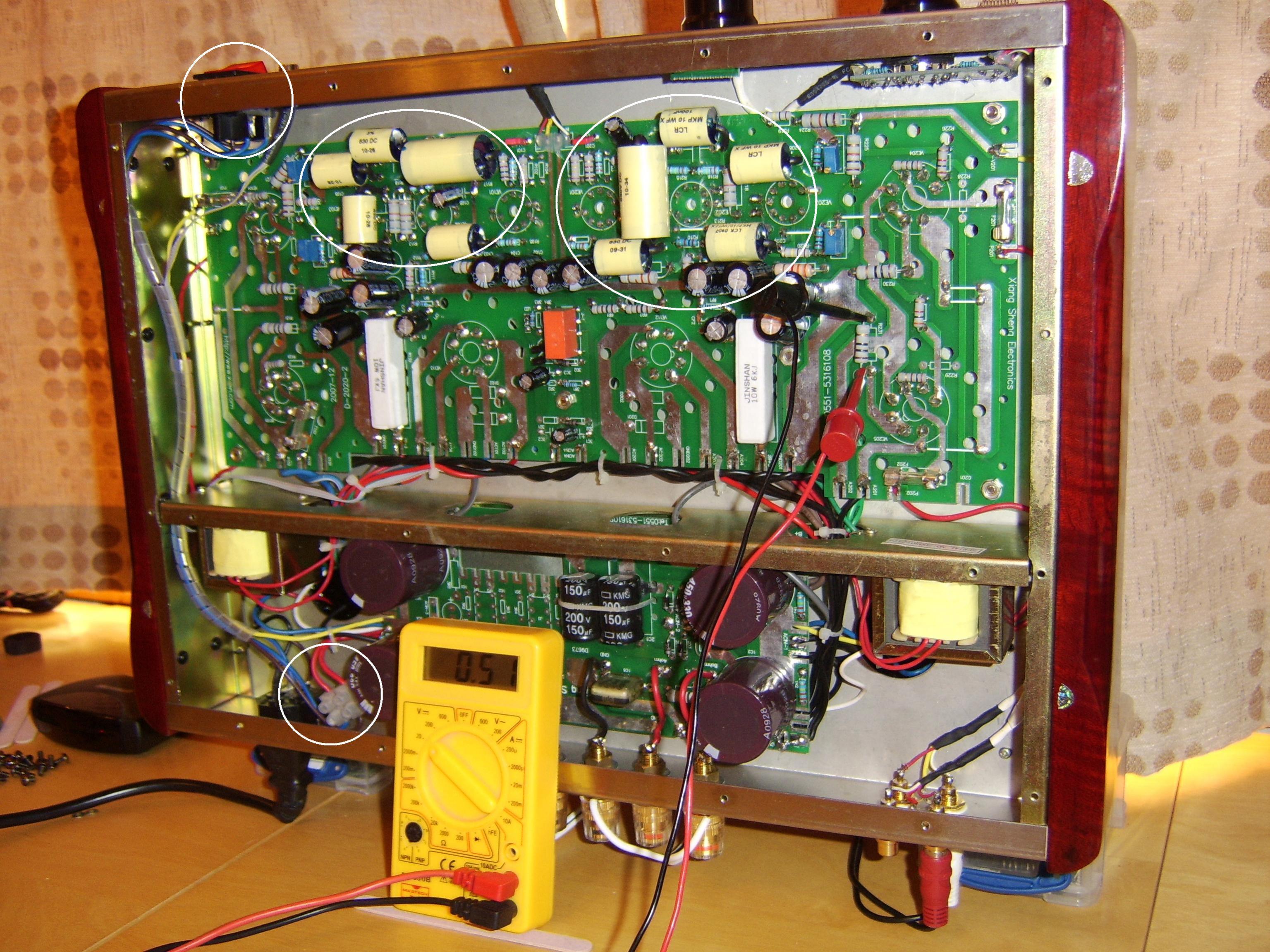

The symptoms were that it would run ok for about ten minutes.then there would be a loud rustling noise from the left channel, followed by a loss of volume. I did the usual test of swapping all the valves across, and found the issue had something to do with one of the 6L6 tubes. So I bought a few spares from flea bay and rather optimistically emailed the manufacturers asking for a circuit diagram. To my surprise they sent me one back. I'm not going to upload it as I respect their intellectual property, and they have been most helpful with my problems. However, if you do need a copy, get in touch with them yourself. They are helpful people.

So first thing was to replace the noisy 6L6 tube. This got rid of the rustling noise, but the left channel would still loose all volume after 10 minutes or so. So I was looking for a second fault.
I checked off a few key voltages. According to the circuit diagram ...
B+1 voltage should be 560V, and is at start-up, but settles down to 508Volts as the tubes warm up.

As I said earlier, I'm not an expert with valves, so I stuck to my limited experience with the Yaqin. Everyone on that forum is really keen to get rid of the original capacitors. So I did the same for the XiangSheng.
The XiangSheng sales literature bangs on about the capacitors being 'German red polypropylene' and lists them as one of the features. But guess what ? - mine were stuffed ! Replacing them with some audio grade polypropylene axial's from a well known mail order company fixed the volume issue. Then I tweaked the output bias following the instructions on the web site, and everything is now working fantastic.
An additional change I made was to replace the on/off switch with a self illuminating type. As you would expect, its not as simple as it seems. The existing switch is a two pole two way switch. But for some reason, both pole are connected to live. So I had to remove the existing wiring, and replace it with two wires ( live and neutral ) from the mains socket on the back panel to the switch on the front panel. From there, I ran the switched live and neutral cables back across to the transformer, where I added a chock block connector to make it all safe.
Also I spotted that the chassis ground was by means of a solder lug screwed to the steel cabinet. The thread on the screw had been stripped and wouldn't tighten, so the whole thing needed replacing.

i am mo expert either, but 560 settling to 506 is not really a big deal, possibly lower power, neither is 380 to 376, nothing to lose sleep about.....
nominal heater voltage of 6.3 can be between 5.9 and 6.9 anything in between is fine and will be a function of your line voltage.....
capacitors are like religion, there are generics of mylar or polypropylene, depends on what you like.....they are the least of my worries....🙂
