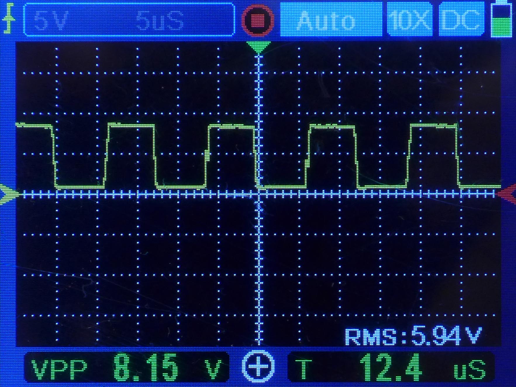

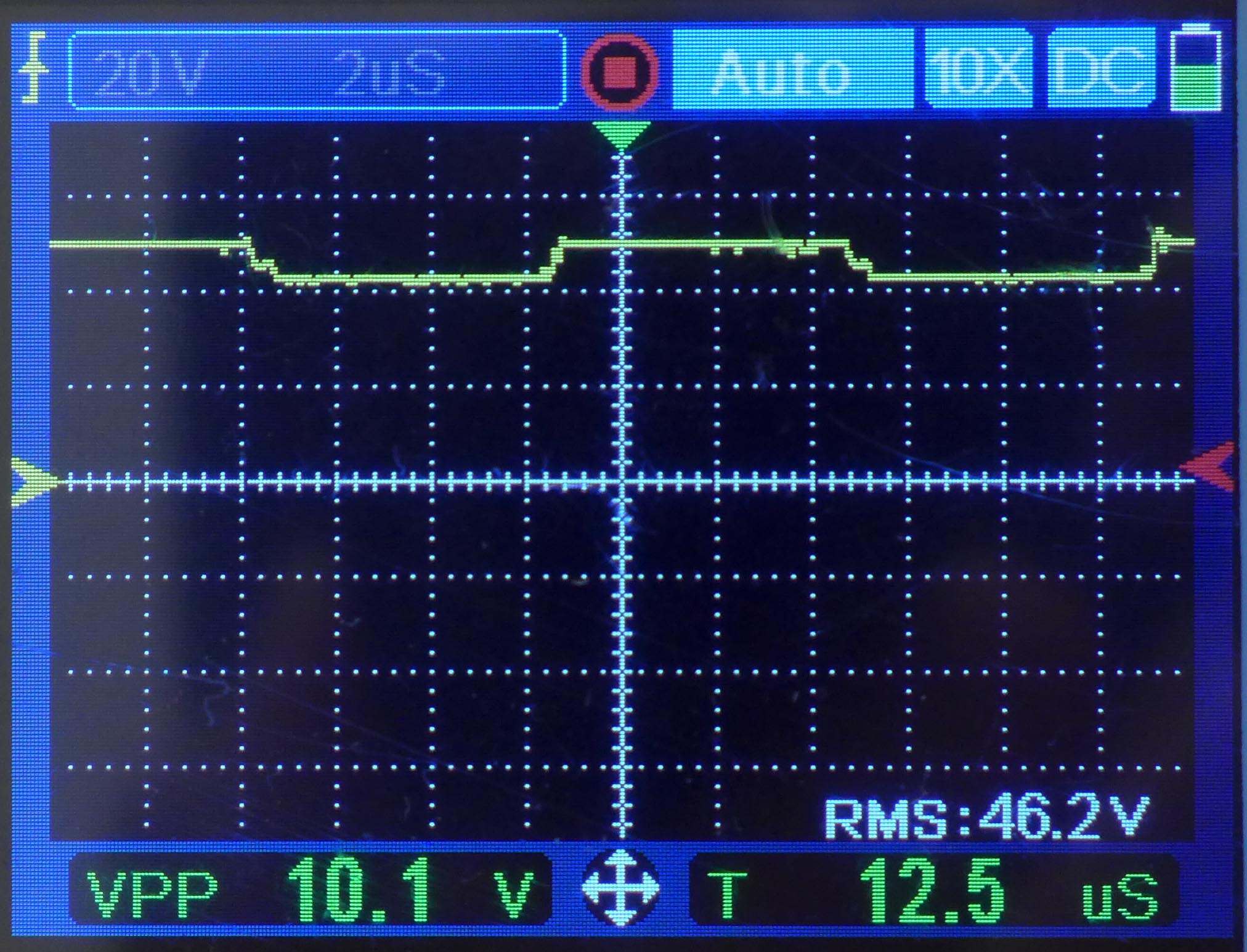

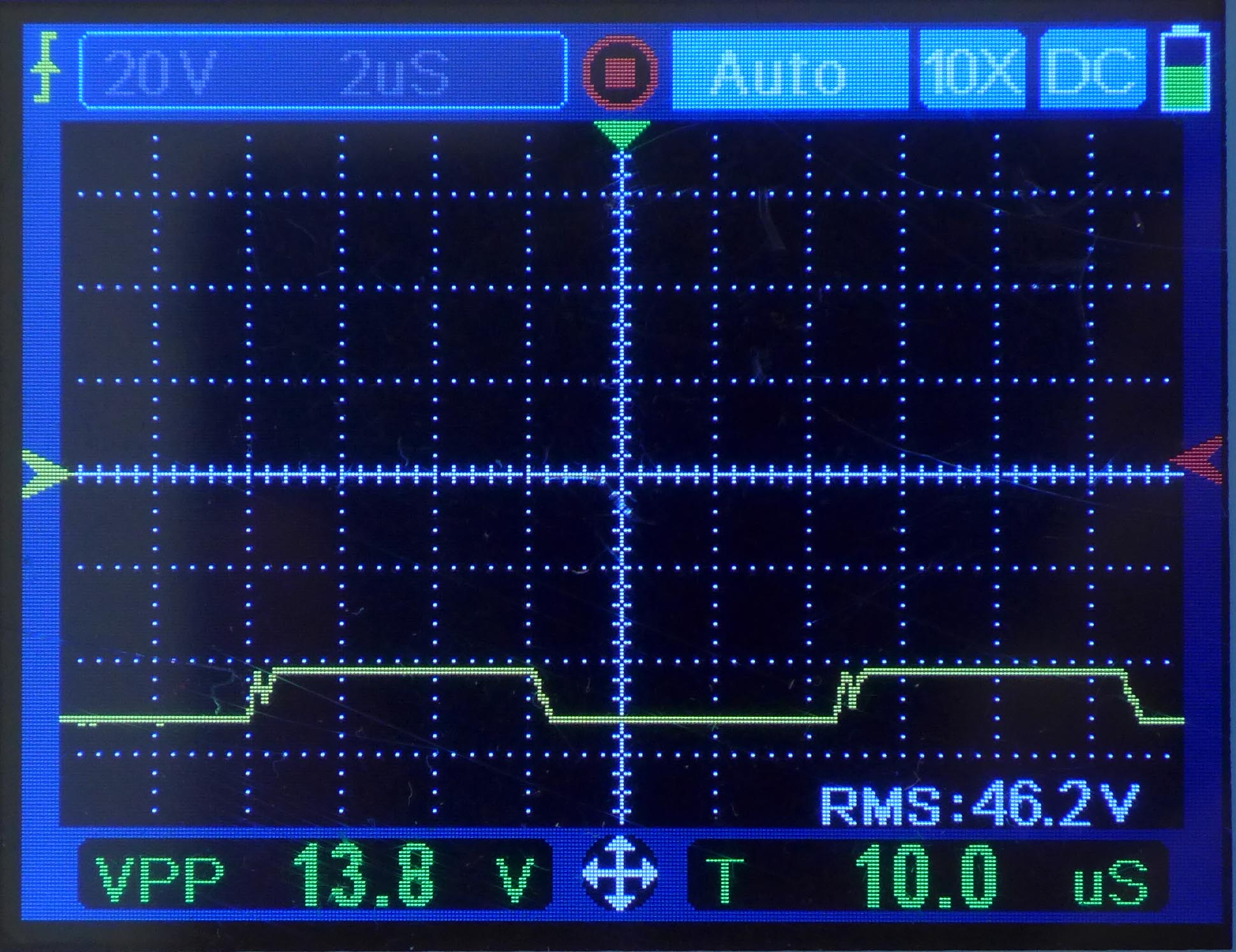

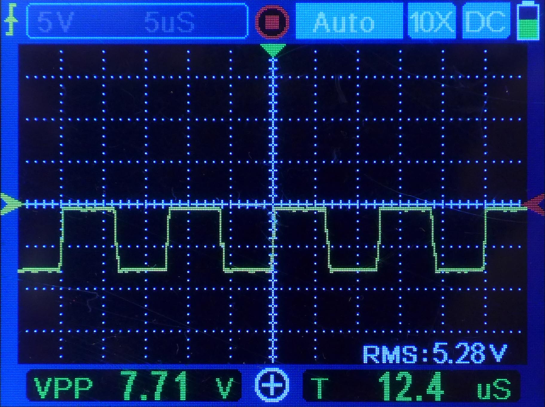

It was scoped on the FETs gate pins.
Other than the Vpp difference, it seemed like the waveform timing is different.

This is what I got.
Later then I tried screw back to chassis for cooling and crank up the current limit, it was able work. But sometimes it take very high current, >10A way over my bench supply limit to start, then it cycles in protection state.
When it was able to on, the idle current is ~1.8A @ 14.4V and 2.7A @ 12.8V. It seemed higher than usual car amplifiers.
Sounds ok and good when it is running.

It's odd that the current increases at lower 12v supply voltage. That typically indicates a drive problem. It may be normal for this amp. I don't know anything about the power supply drive circuit beyond what you posted.
The 10 amps to start isn't likely a problem if the current drops back down after the rail caps charge.
The initial photos you posted seemed to show some sort of problem with the insulation on the inductor. I don't know if that was a real problem or just an illusion.
The audio drive signals look OK but the final test is generally whether the FETs heat quickly or not. If there is a question, clamp them tightly to the heatsink (with new heatsink compound) and let it idle for 10-15 minutes. Does the heatsink heat up significantly?
