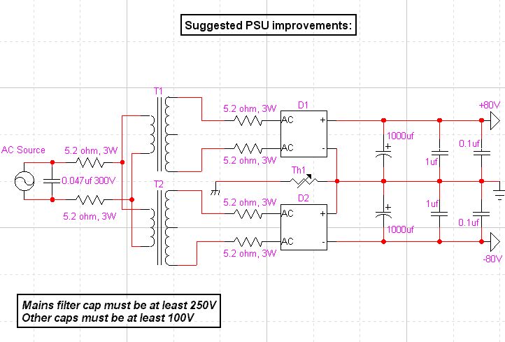

Test 2.) I also fitted 5.2ohm resistors on all AC leads from mains and to rectifiers, and added bypass caps on 1000uf smoothing caps, saw this somewhere but can not find now. It really improved the whole sound spectrum.

JDeV said:Test 2.) I also fitted 5.2ohm resistors on all AC leads from mains and to rectifiers, and added bypass caps on 1000uf smoothing caps, saw this somewhere but can not find now. It really improved the whole sound spectrum.
This is what I did. Still can not find origenal drawing, or knows author.
I have used the 5.2 Ohms here (near to the bottom of page34 of x-soz thread):
http://www.diyaudio.com/forums/showthread.php?s=&threadid=3949&perpage=15&pagenumber=34
The application has come from these two:
http://www.passdiy.com/projects/pearlono2.htm
http://www.audio.nl/tipseng.html
